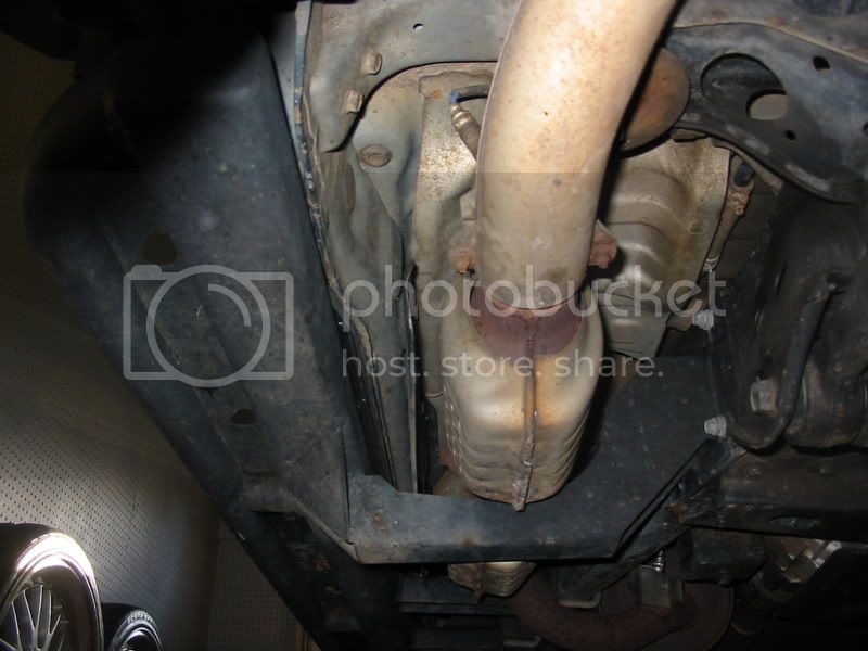

What does the rest of the truck look like underneath?

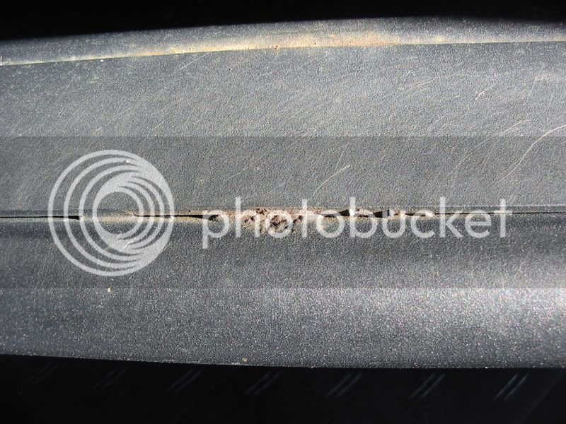

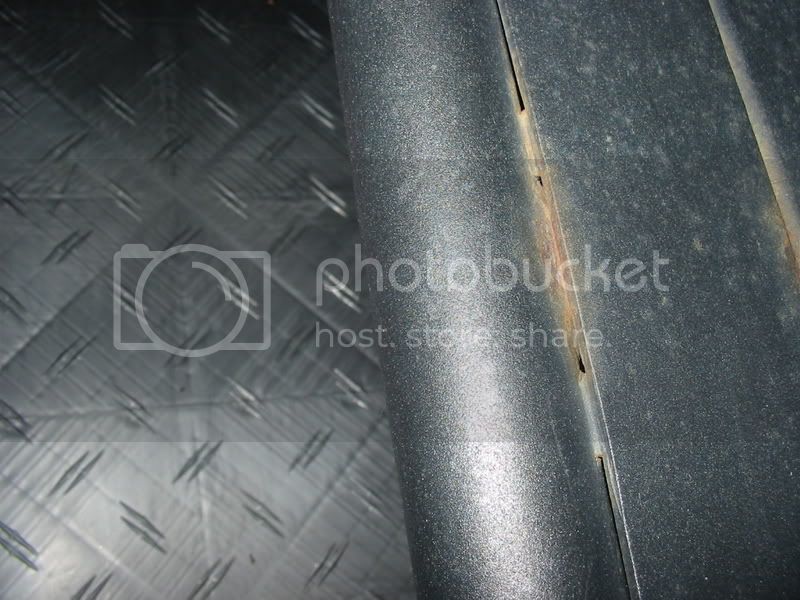

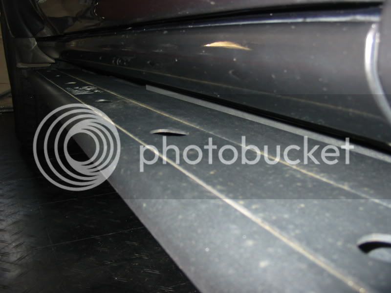

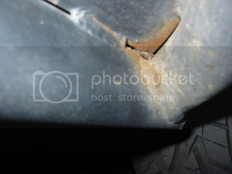

The camera flash makes the rust look much worse than it really is but it is there never the less. Pretty much ever weld has some rust forming I believe.

Your pictures show exactly the issues we had. I would address the spots now to prevent more corrosion.
The bottom is a different matter. Any slider is subjected to sand blasting from the bottom and there is very little to hold up to that.
One other option is to have it sprayed with bed liner. That way the top and bottom will be protected.
