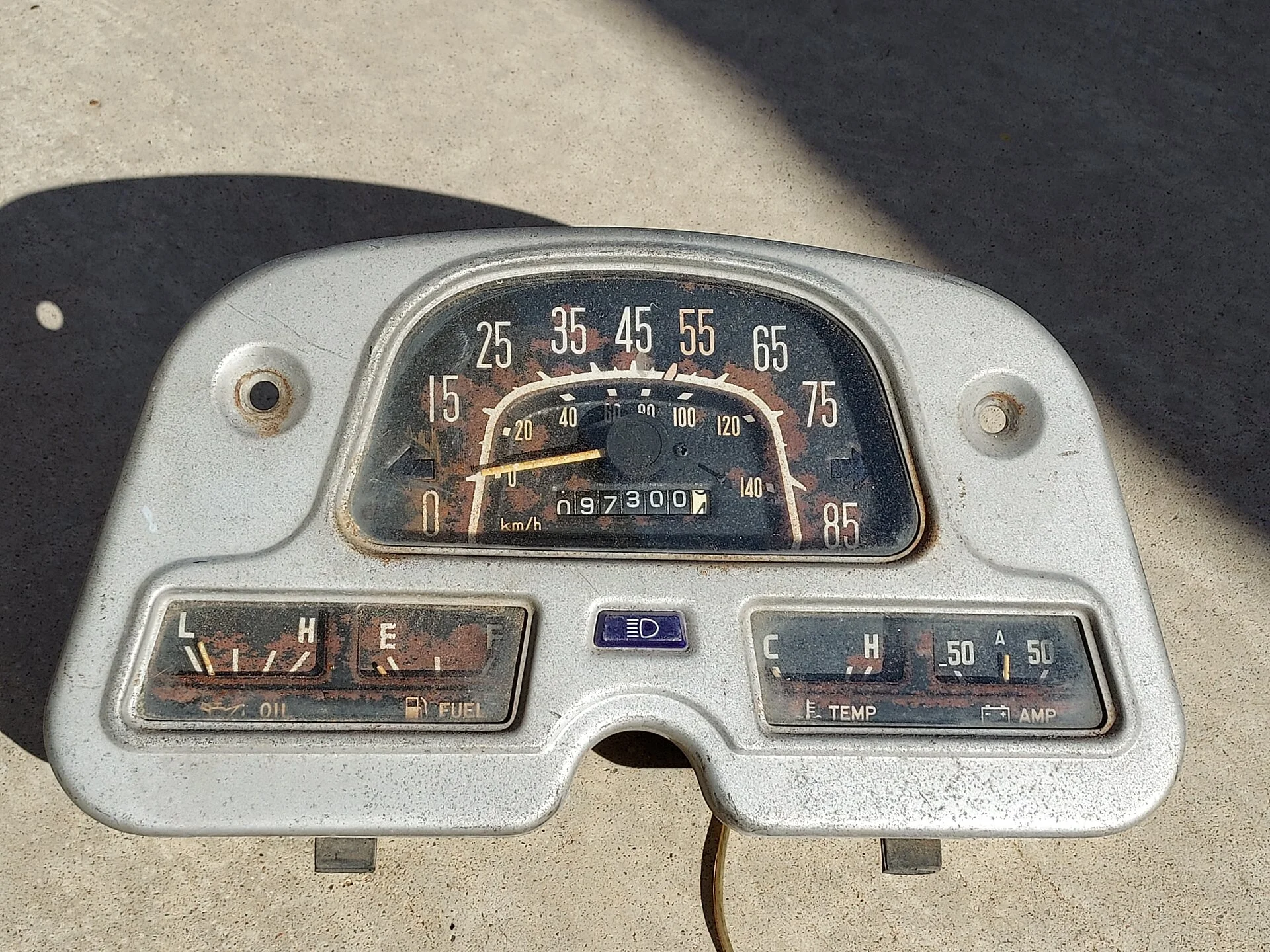

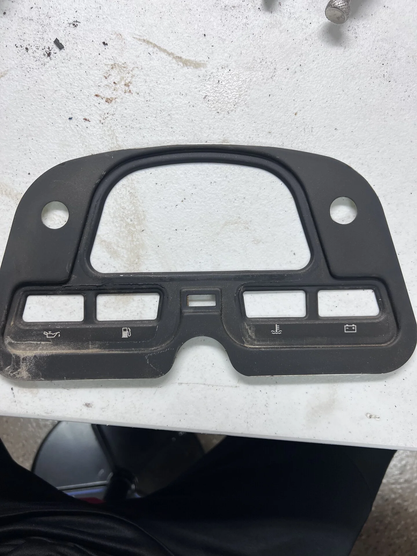

Does anyone know if the OIL, FUEL, TEMP, AMP Symbols shown here are stock for a 1984 LH Drive 40? I can't seem to find photos of a bezel with symbols and would like to get the proper bezel installed on this restoration.

Here is the cluster I was thinking of
Does anyone know if the OIL, FUEL, TEMP, AMP Symbols shown here are stock for a 1984 LH Drive 40? I can't seem to find photos of a bezel with symbols and would like to get the proper bezel installed on this restoration.View attachment 3472696

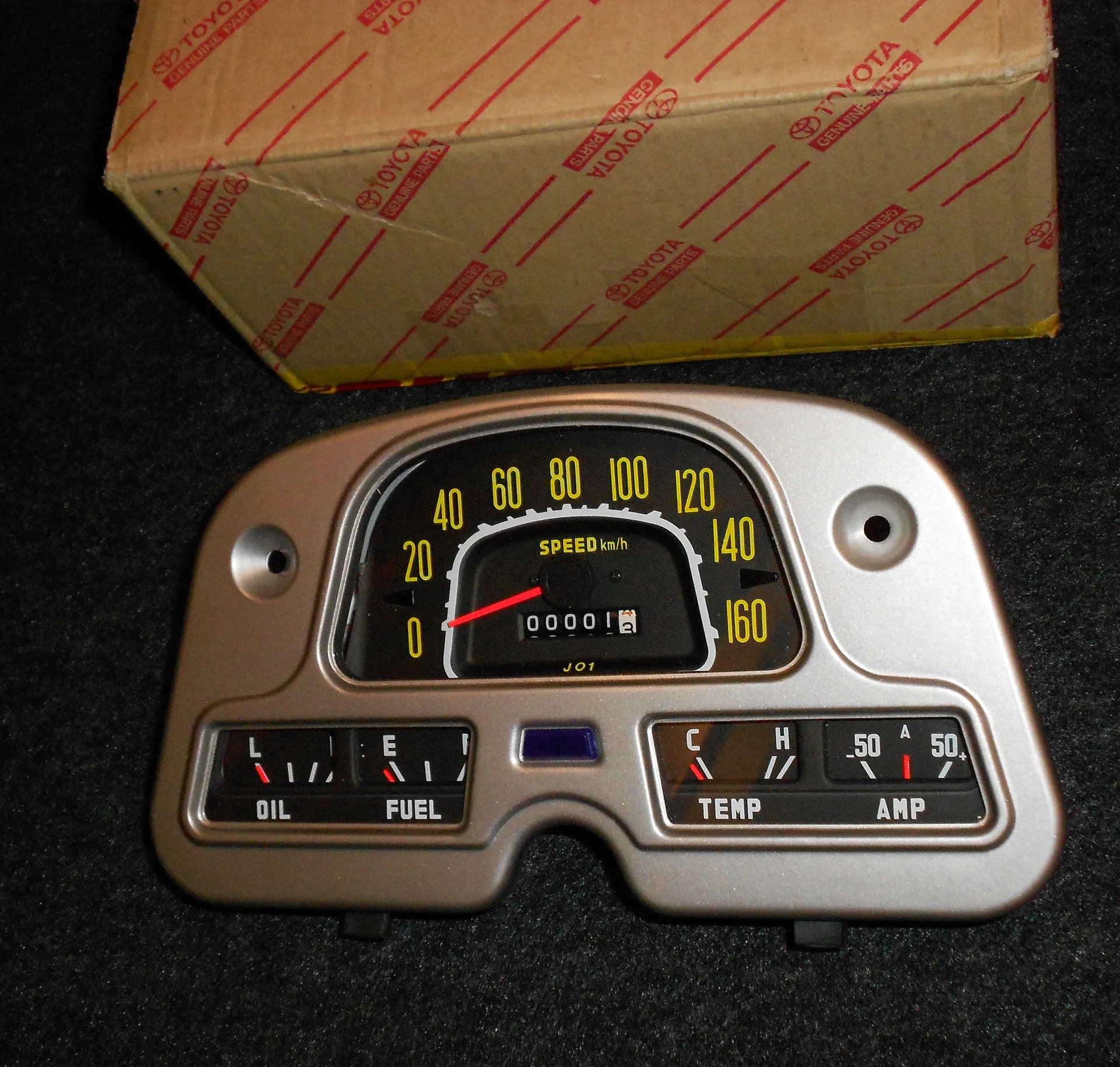

@JVZii , can Supersede my " NO "
i was basing my , NO off a 1984 BJ46 JAPAN Spec. Cluster Meter , as it has BOTH the Internattional language Logo's update icons , and the outdated and dreary " Anglo-Saxon Text words , that were forced upon the rest of the globe , by OEM Japan Spec. Parts Maker YAZAKI whom did not ever use ? Anglo-Saxon English Words or speak the language they printed on all Cluster Meters from 1962-8/80 globally ....
- that is a way odd-azz set of facts , there for sure ?

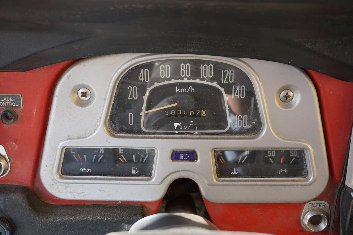

If it's 84 then it should be a j07 cluster which only has those symbols. check out this 82 Saudi spec troopy
