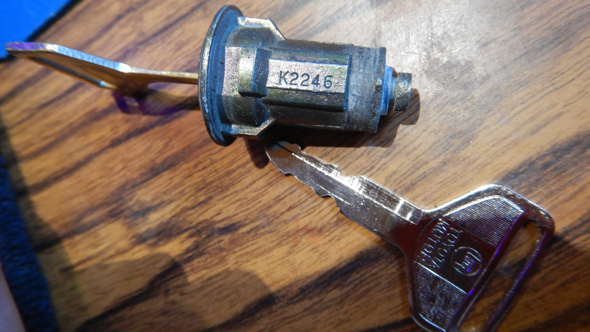

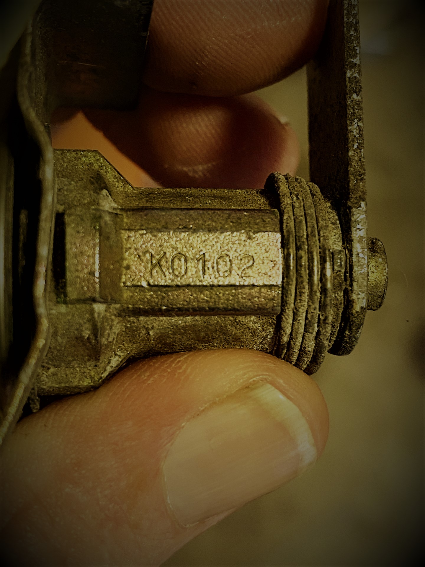

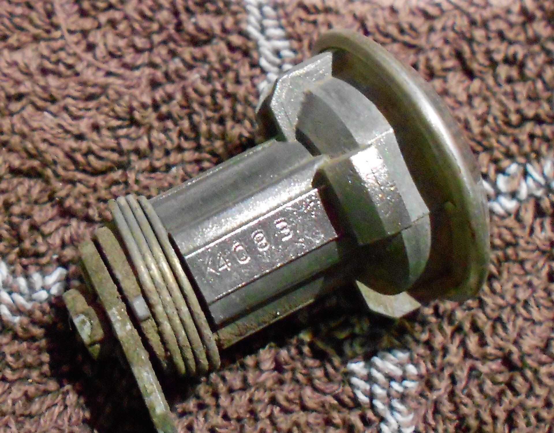

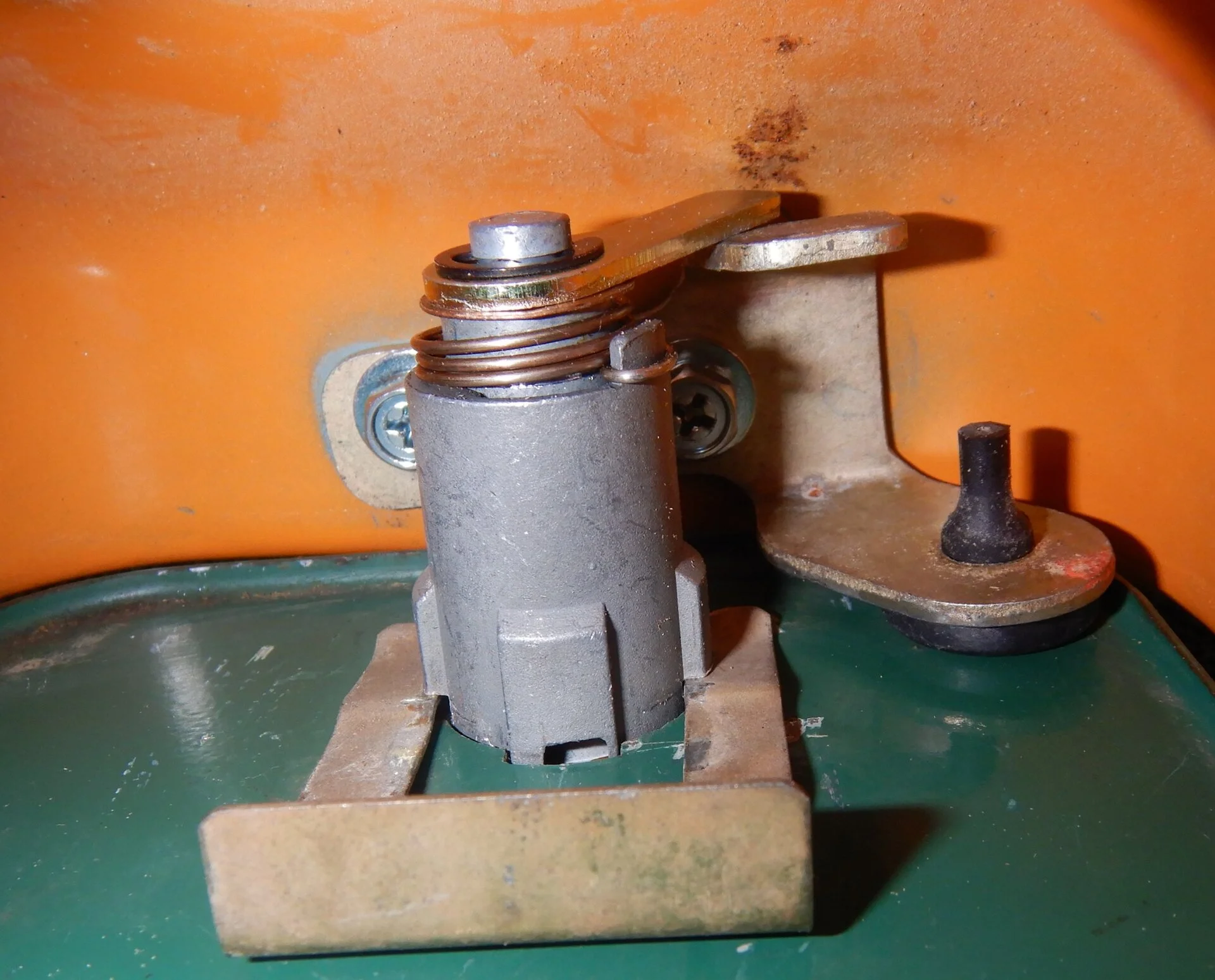

- the only way to fond out is pull put your passenger side front door lock and examine it carefully for the K- SERIES four digit code ......

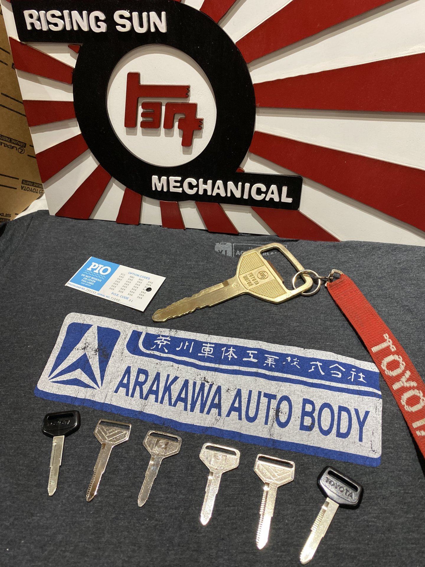

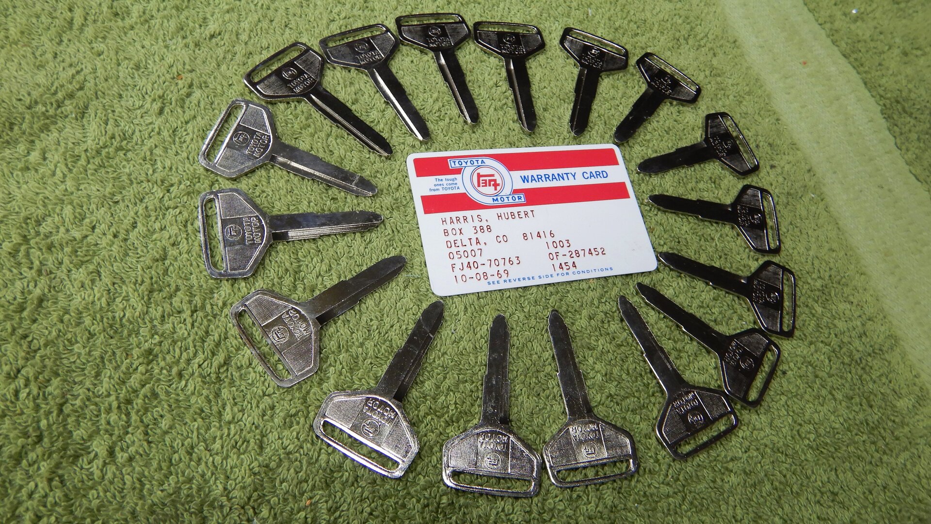

- then , request a factory SST machine cut . digital computerized perfect , sharp , true , and professionally code cut K-SERIES 1976 master all metal top basic OEM key blank ,
lube up all lock with WD-40 days , like many days before trying new oem code cut key ,.,

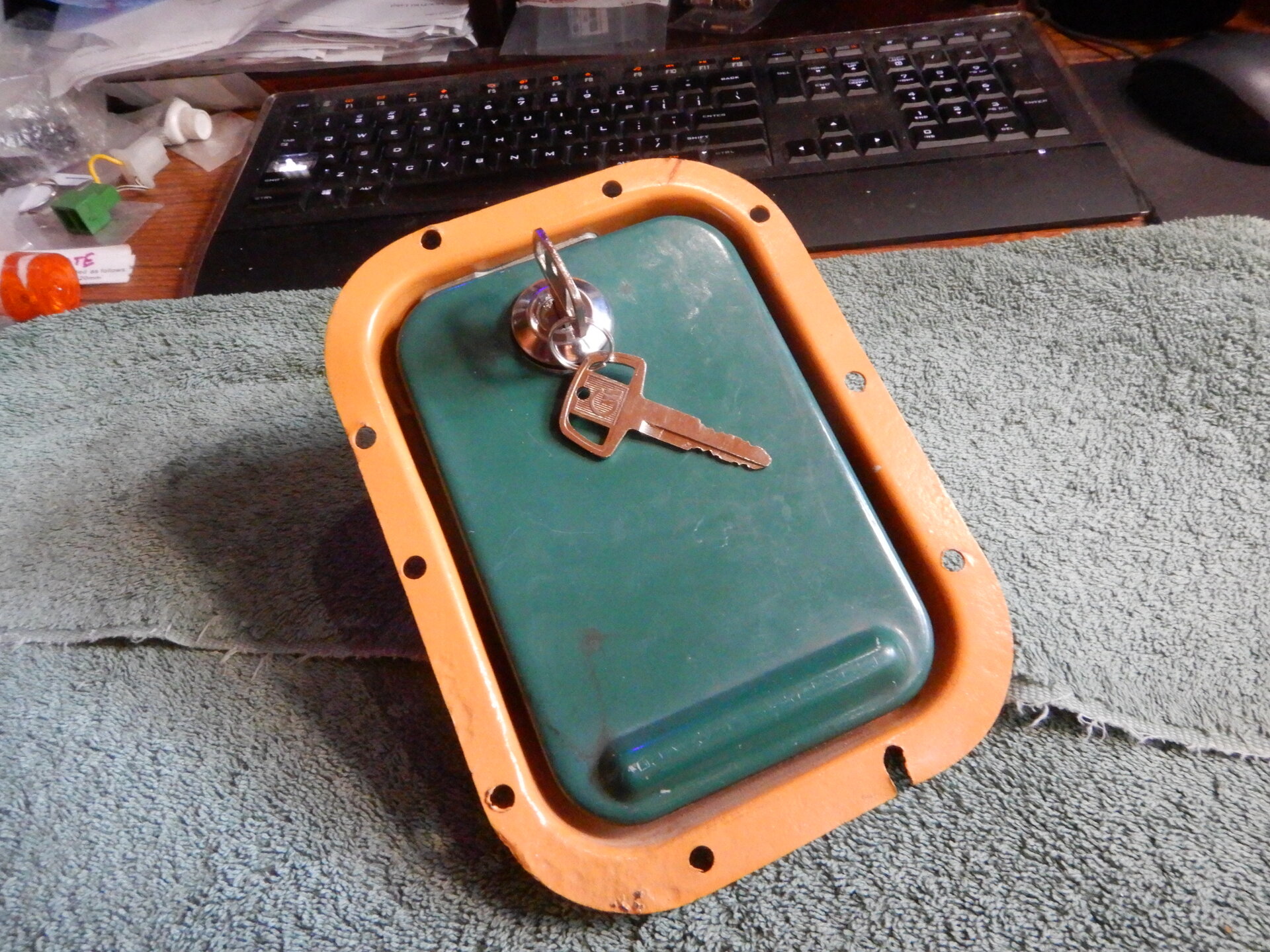

follow these above TOYOTA OEM Factory step by steps , then you shall have a correct final answer for all 4 of your doors locks / ignition / flip down fuel door ....

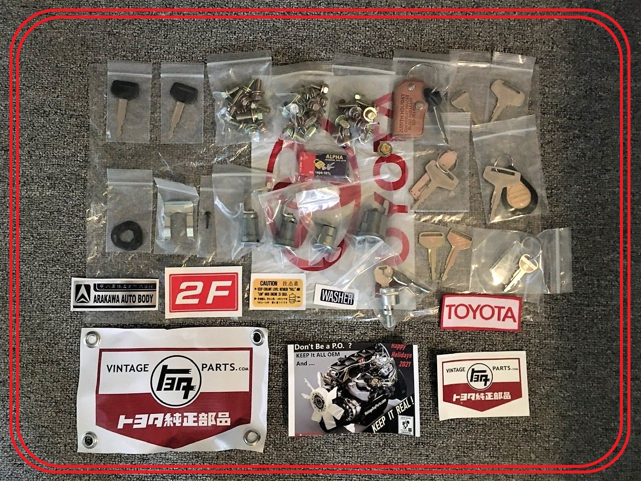

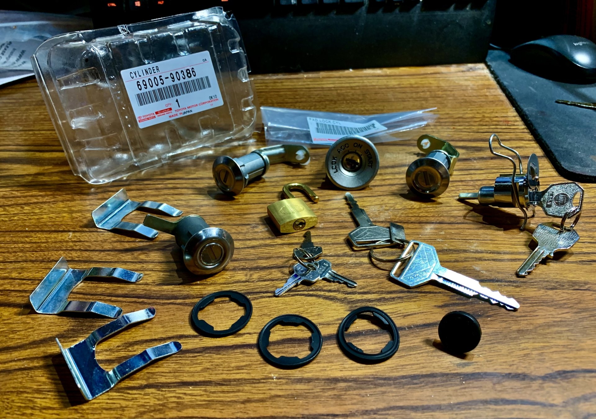

if you have a bunch of random locks and only or no matches ?
then there is yet still hope for you below .......:)

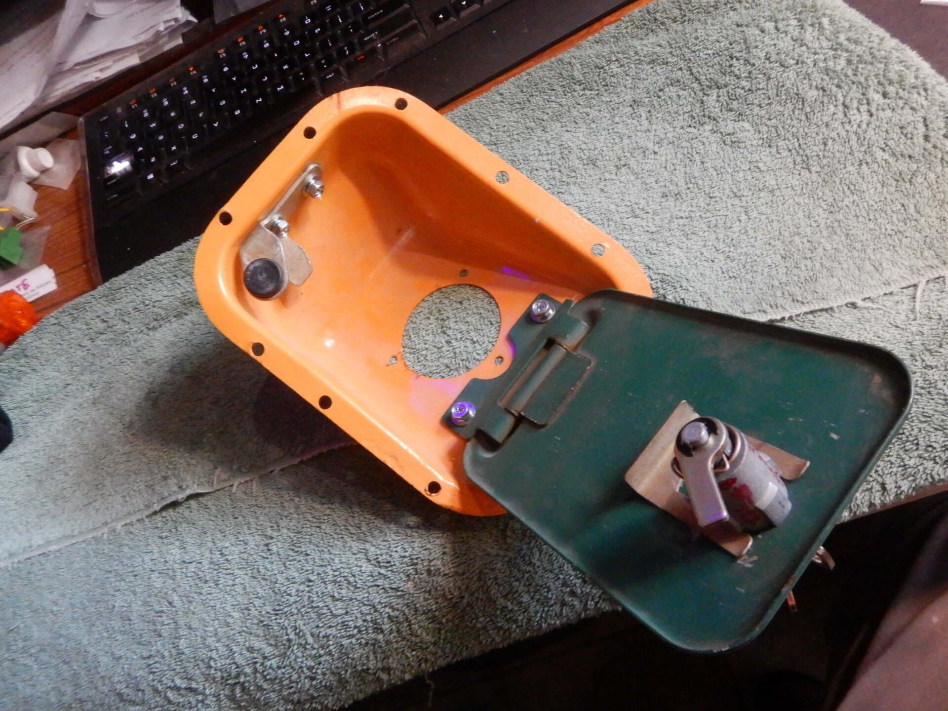

THIS IN THE WAY.....
