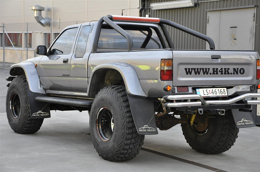

this is his sweet build, 1995 HiLux. also on 42" and 3" body lift.
recently approved at the Norwegian DMV.
and tested at Dekra, a independent test labaratory in Germany to meet the current EEC standards within stability, brakes etc. demanded by the DMV to be road legal.
and actually here on 46" just for the hell of it..:ban:
Very nice! How did the hilux perform on snow with those 46's?
it isn`t tested yet due to it is recently build.. but i`ll bet it will rock cause of the low weight..
If the axles can handle the tires I think it would probably just about float on water with those tires.
i see a road/snow/water crossing test in the Hilux future!:D
I was wondering the last couple of days whether these tires were legal in Norway. And now you have answered my question. :) Do all truck who have bigger tires that 35" have to go through testing like that in Germany or is it okey if one is built and approved then trucks built later on the same way get automatic approval ? :)
Hi
All over + or - 5% have to be testet, thats the tuff part with 4x4 in Norway. I u can't us any car as a exempel.
all the trucks with bigger wheels than 5% of stock wheels have to be approved by the DMV. and since the DMV have created a gouverment board called SFOOR(Orginization for rebuild, modified and repaired vechicles) in 2007ish, it is now basicly impossible to get anything approved in Norway without going to a independent labaratory and get the vechicle tested and documented. and Germany is the closest thing to have such labaratorys.. TüV, DKR, Dekra etc etc..
and no, it is only for one truck. the documentation is for the vechicle tested only.
Arctic Trucks have series approval, but then the testing is waay more extensive and humoungsly expensive!! Even Arctic Trucks as a firm have to be approved to have series approval.. so in short, it is a PITA to get anything approved in Norway now..
uff that´s tough. Here in Iceland I for example could modify suzuki jimny on 44 inch tires and the just have it checked and then ready to go...
Then you will plan a roadtrip to Germany.?
Im curious what the use in norway is for a vehicle of that kind, as I think you're note allowed to drive off road even if its covered with snow right? some insanely stupid laws there
unfortunately there is a goverment party now that is pushing similar laws trough here in Iceland
but we are trying to fight it
Here in Iceland it is allowed to drive of road if its covered with snow, it is not allowed to drive off road in the summertime and you will get very high fines if you are caught doing it
there are quite a few places we can use our cars in the wintertime, but not like you guys can do.. in summertime we have it lot easier. especially north of norway where i am from, there are vast aeras to explore. and if it is allowed to drive there in the summertime you can basically drive there in the wintertime. the laws states a purposed vechicle for intended use, doesnt say car but who is to say that it isnt purpose built?:D
