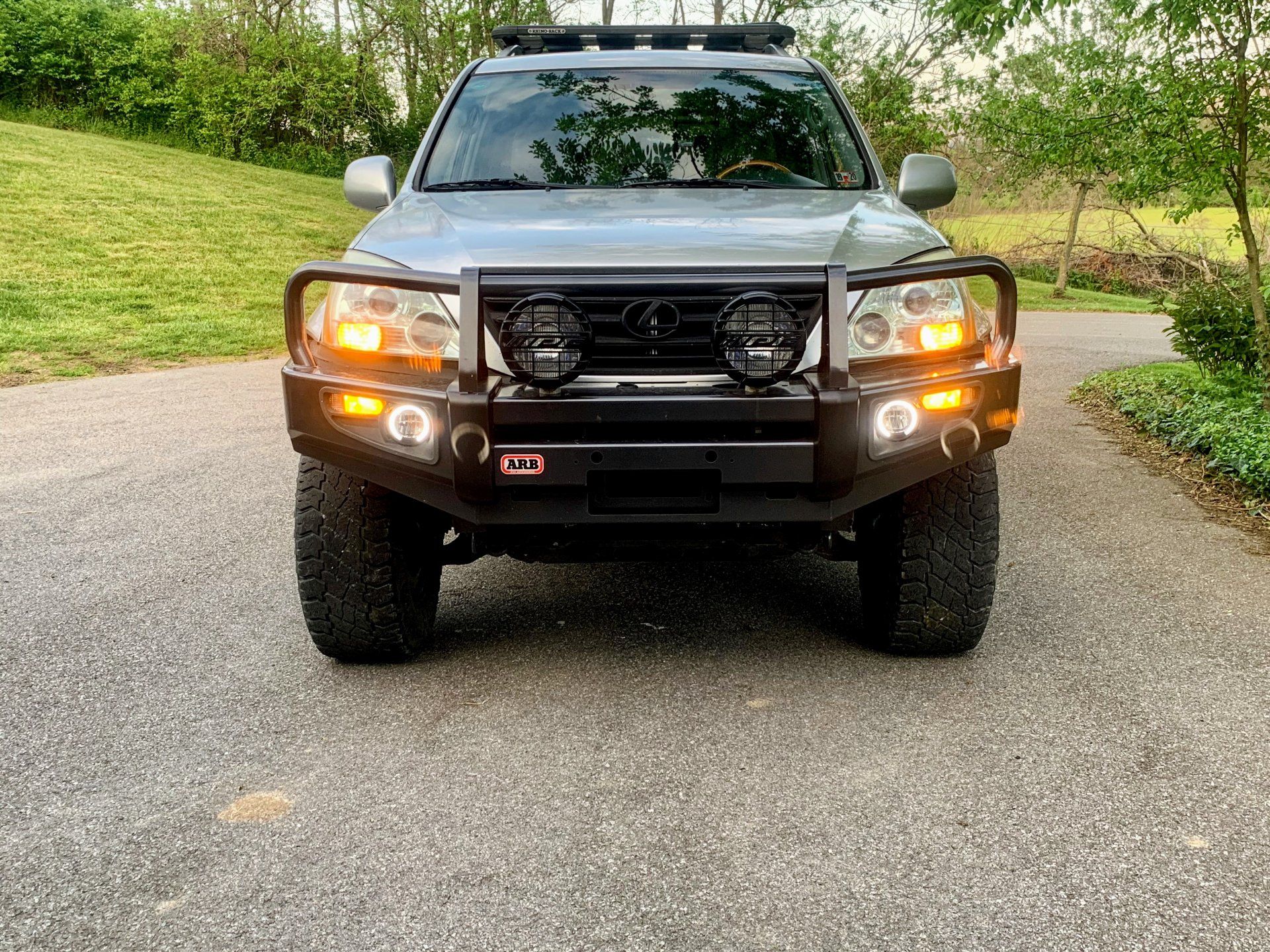

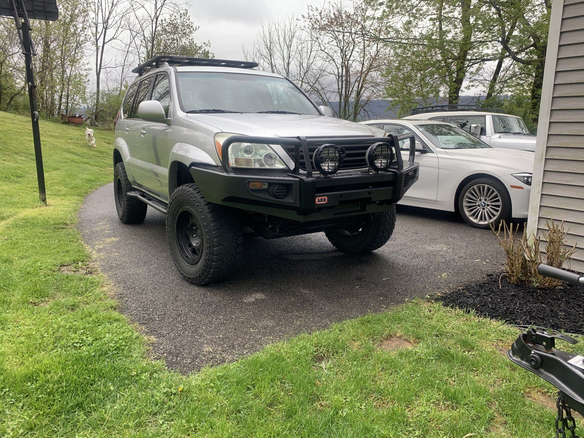

I have the ARB, what would you like to know? Ultimately went w/ the ARB after looking at some of the details in the reinforcement between the two. ARB hoops continue through the skin of the bumper and are tied to the framework. I’d be happy to share any pics or install tips

I found an ARB in 4th gen 4r and hand measured..from grill it sets forward 7".

Maybe its just picture angle but it looks like the vertical braces on the ironman are wider apart and may block highbeam light some? Does anyone with the Ironman 470 bumper experience any interference with the high beam pattern?
@joabmc can you measure the distance on your ARB? also pics of the hoop reinforcement you talked about would be awesome!
Anyone else to measure the Ironman?
