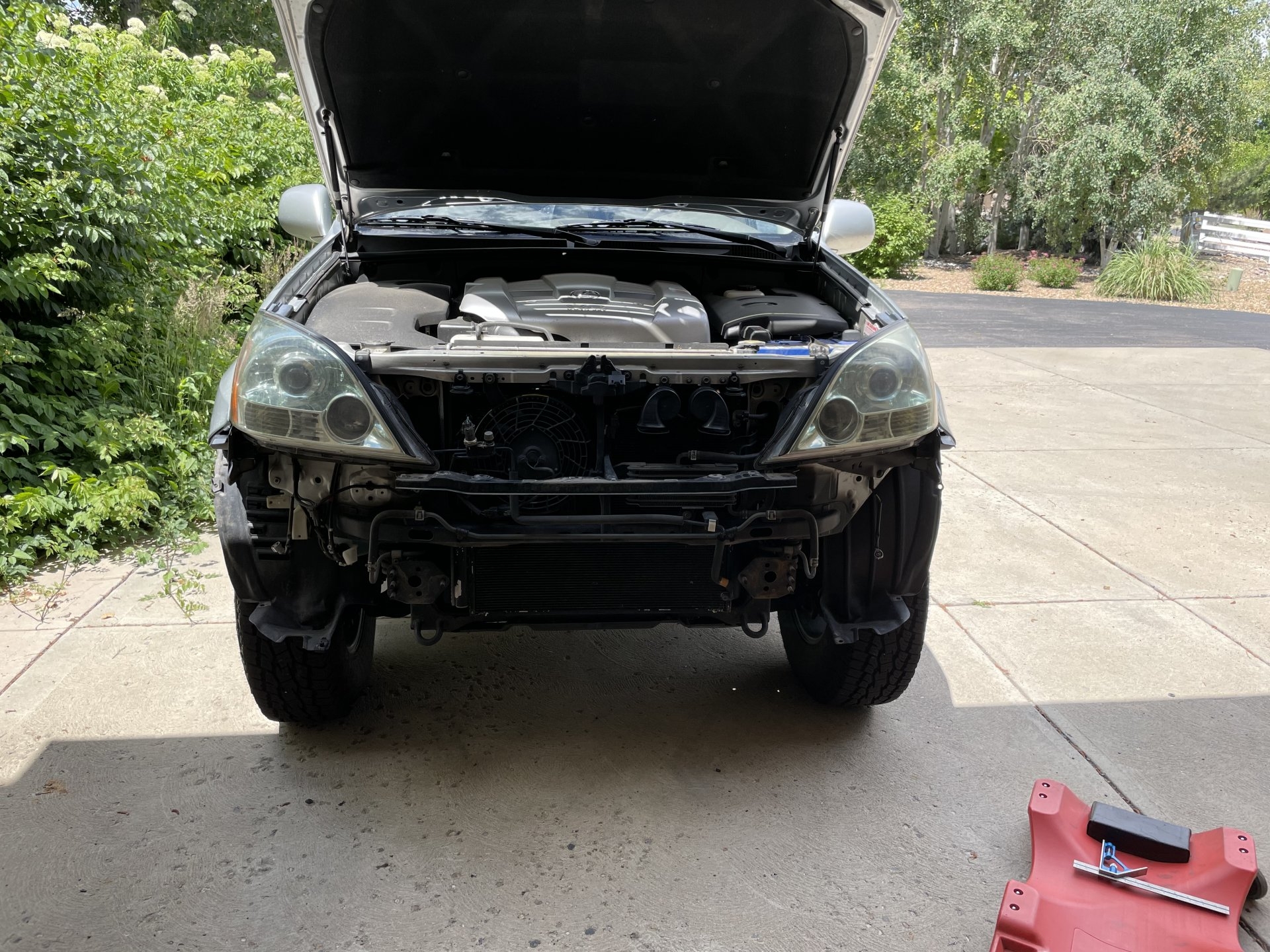

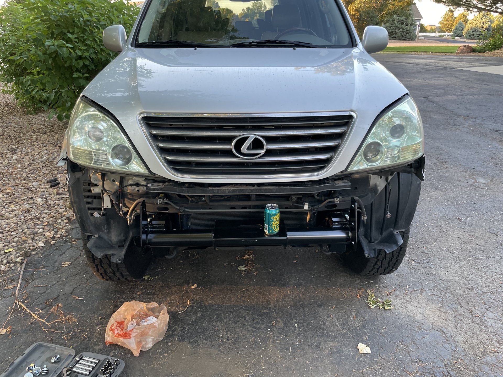

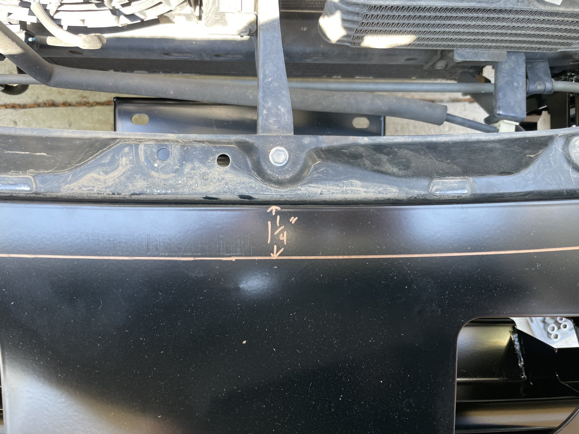

After removing the bumper cover you will see these brackets underneath the headlights. These don’t support the headlight but rather support the bumper cover. Since it is removed these are no longer needed and need to be removed for the new bumper.

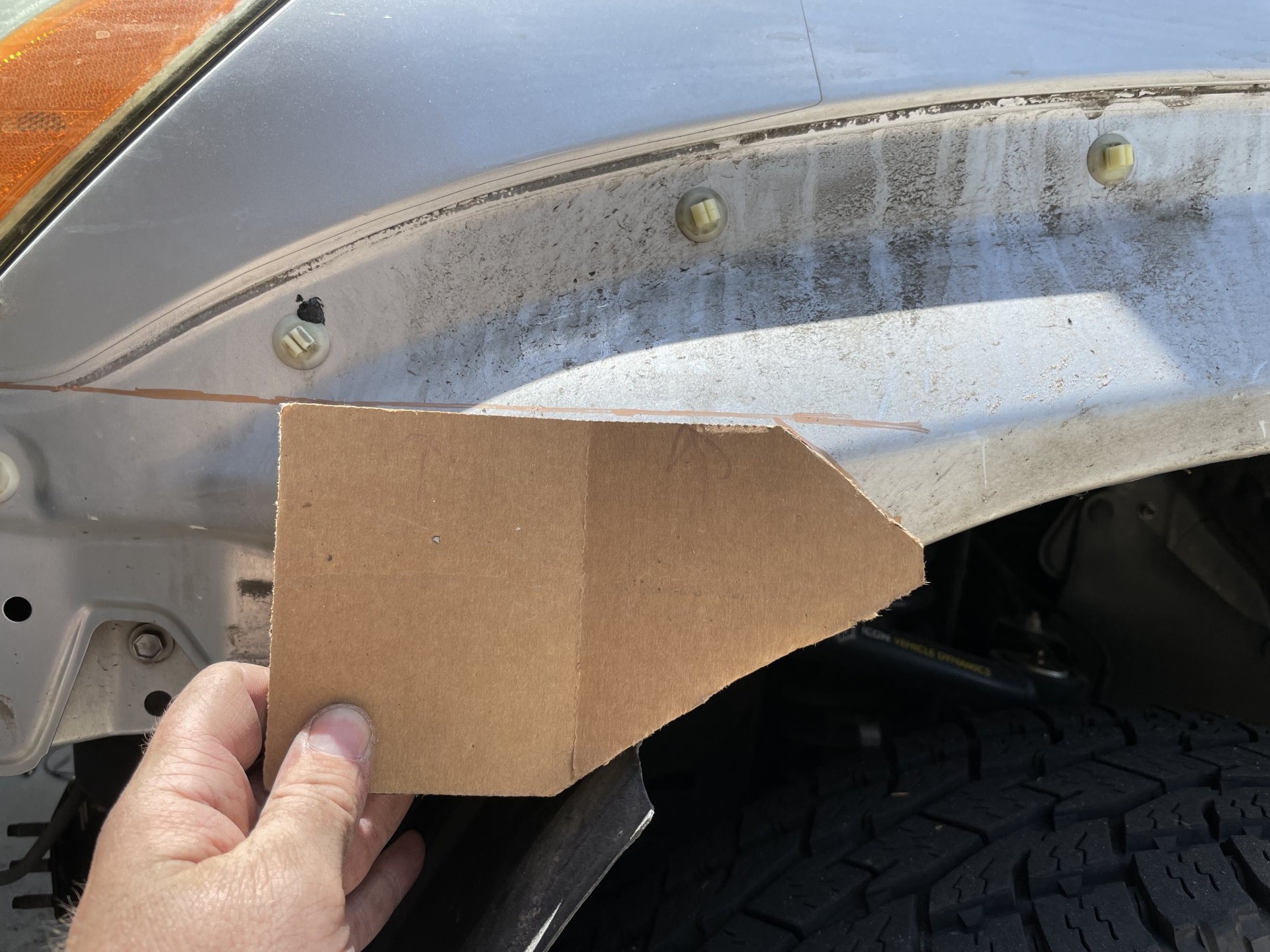

You need to start conservative with removing sheet metal. I started with a level line from the bottom of the headlight and a template of the new bumper edge.

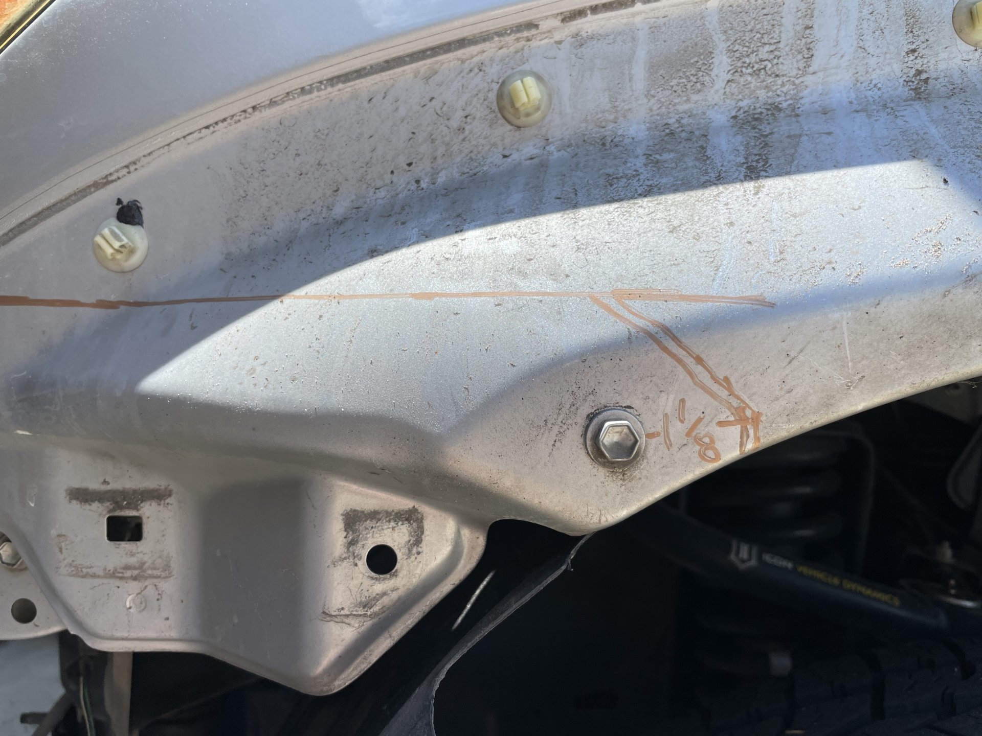

Here’s a reference measurement to the bolt.
To start I was hoping to keep as much sheet metal as possible as a starting point so mapped out the initial cut
the bolt I am pointing to here bolts to a bracket on the headlight and the headlight was sort of floppy with it removed, so I wanted to retain it.
ultimately the bumper was too narrow to fit over the sheetmetal under the headlight. So I had to cut along the rest of the gold line under the headlight. Here is the first test fit - the initial cut was not far back enough.
Started by trimming another 2” which allowed the bumper to get bolted up to the bracket which is slotted front to back (bumper is slotted up and down) there’s a decent amount of adjustment. The final position was with the bumper as high as possible and as far to the front as possible on the top bolt, then rotated forward so the bumper aligned with the fender well and the hood barely cleared the bull bar hoop.

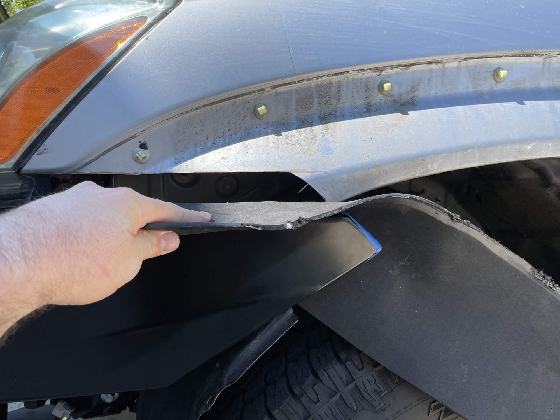

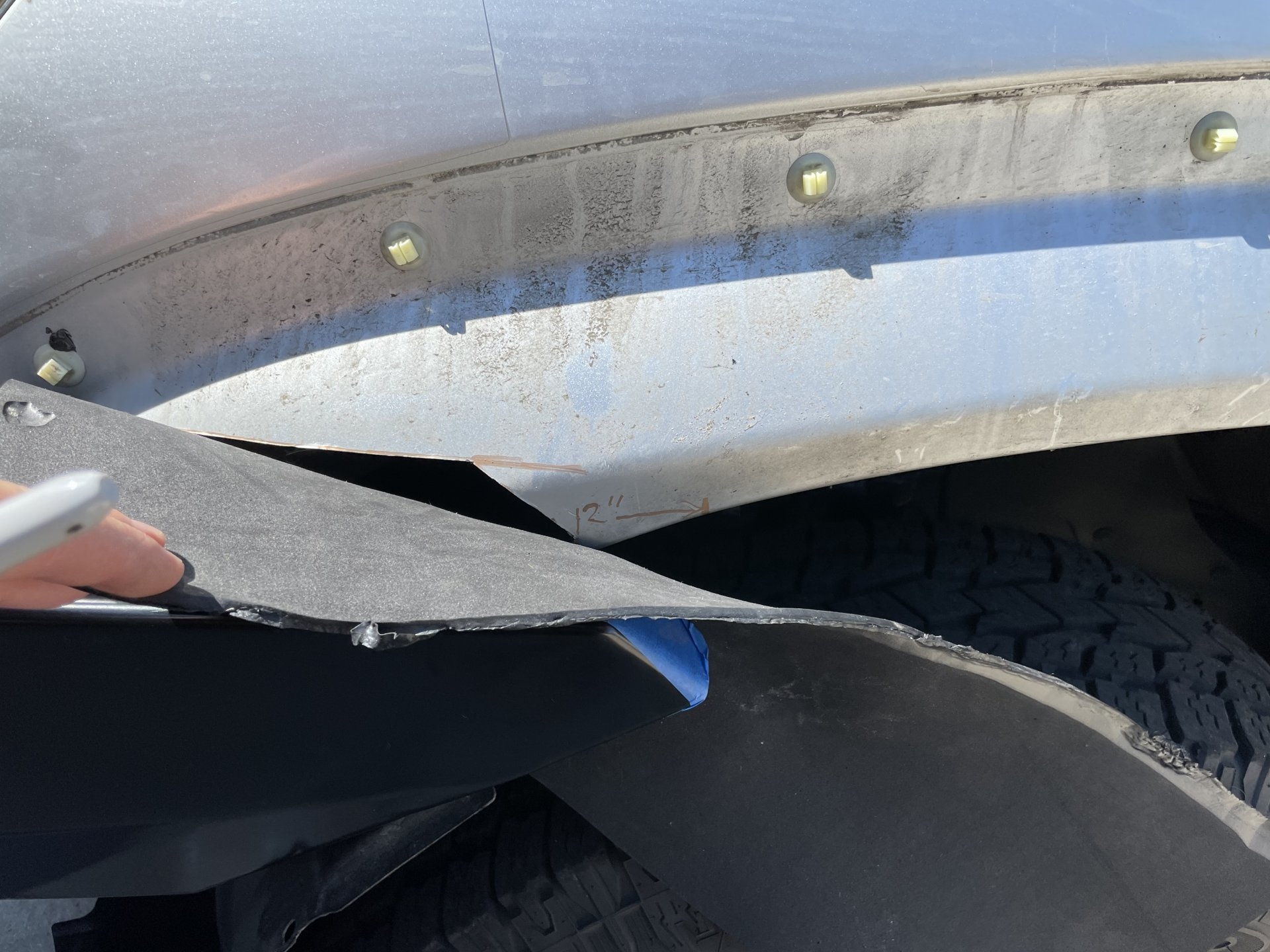

Photo of the other side showing how I incrementally trimmed more until the bumper could align with the wheelwell opening. Once in final alignment I used a spacer to scribe a final cut line parallel with the edges of the bumper.

I recomend removing the flares for the install (peel them back, full removal requires removing some bolts that are hard to access without removing the running boards). All the trimming would be difficult with the flares in place and it also is less critical if you slightly overtrim the sheetmetal. The flare is your finished surface that everyone sees.

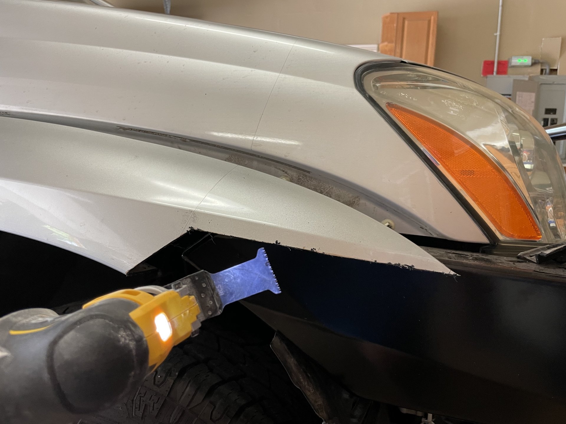

I used a similar rough and final trimming process with the flares. Cutting enough so they can go into place and then using the edges of the bumper to scribe a parallel cut line. I used a multi tool to do the final cuts and it seemed to leave the best finish.
Nice job! The worst part by far was all of the test fitting and trimming away more than I initially planned (like the lower headlight housing mounts). Trying to find the right balance of maximizing clearance, minimizing the under headlight gap, trimming the fenders, and clearing the hood/center hoop took me about half a day to get it where I wanted.
Once the fit is good, wiring and the final assembly takes no time at all. Just be sure to keep as much of the plastic inner fender liner as possible. I managed to tuck almost all of it into the side wing skid/cover things. If you cut too much away, hydrolocking becomes a serious concern if water splashes just the wrong way into your intake.
