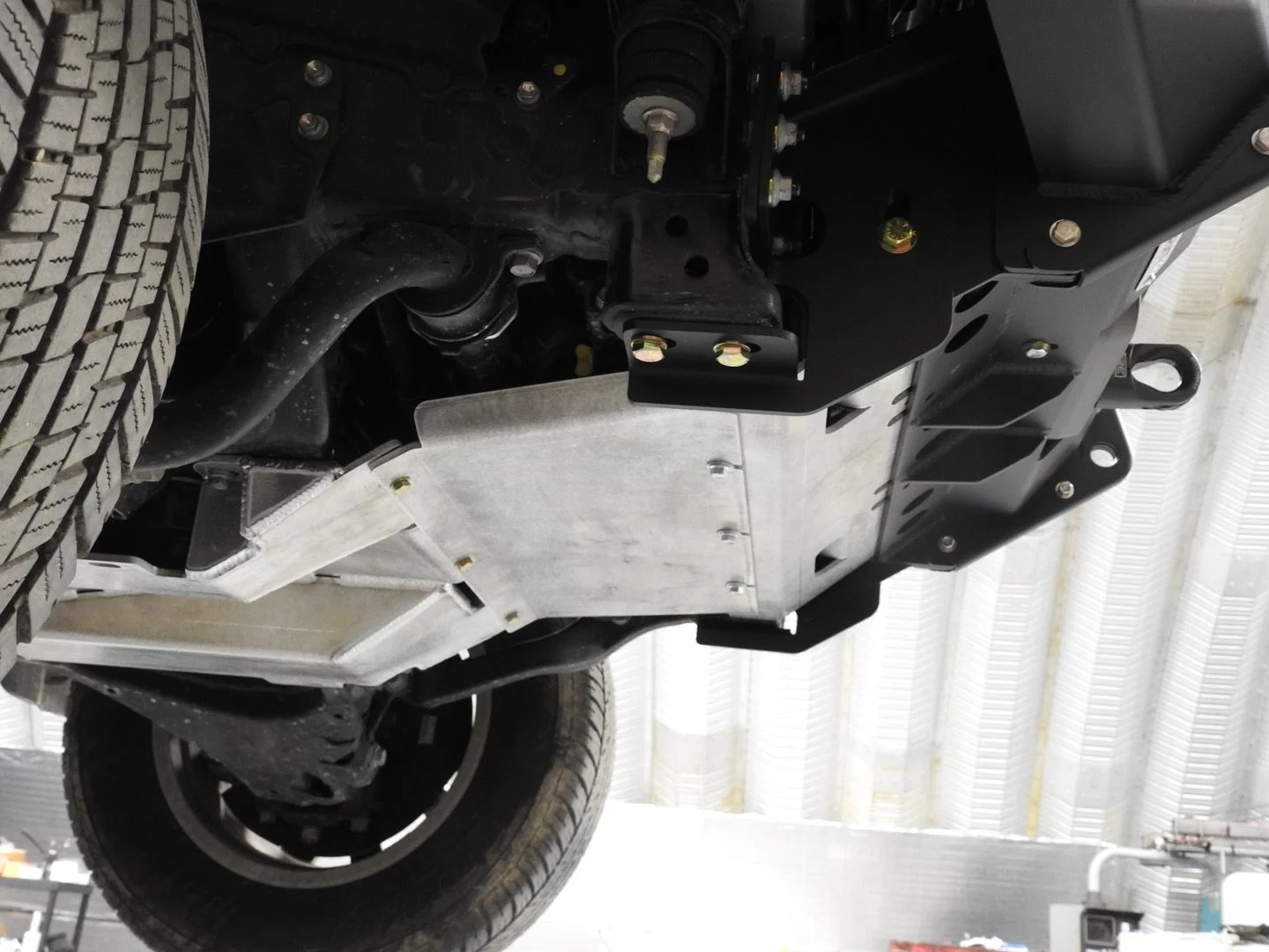

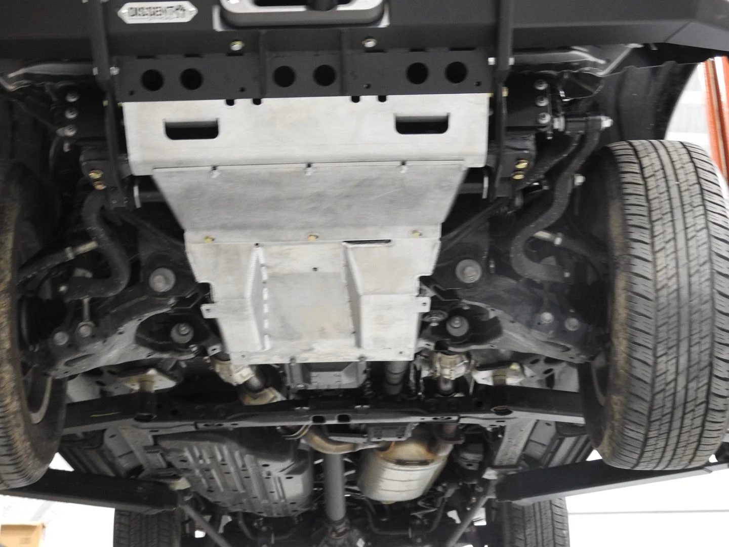

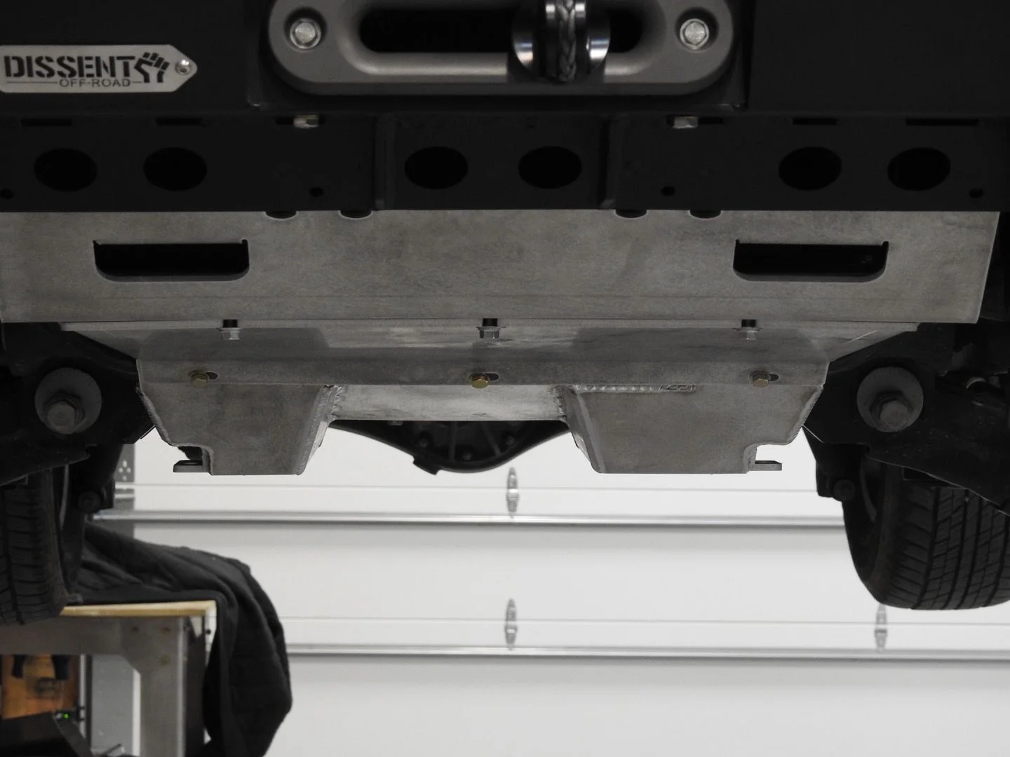

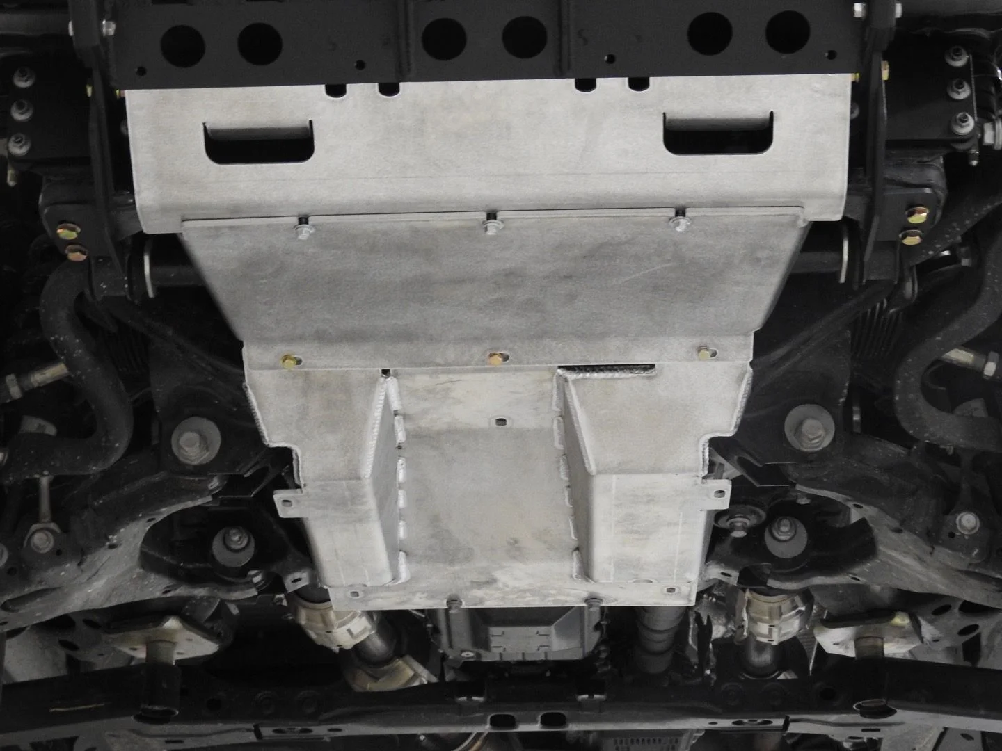

Hoping to have our (dissent off-road) aluminum skids available in the near future. Hi clearanc, strong yet light weight.

Will another part go back to the middle crossmember? If not I assume the stock skid fits but you don’t have it removed for any reason?
How thick is the aluminum? Have these been tested on actual rocks yet? I really like the idea of using aluminum to keep the weight down (anything helps on these cows) but know it can struggle with hard use.

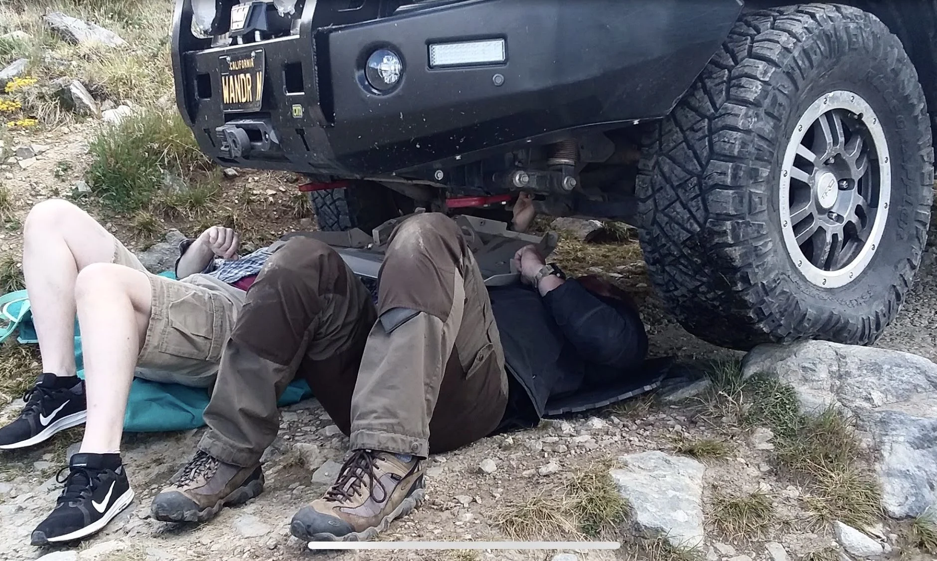

Not a good sign:
-Here I am on a trail East of Breckenridge...
...reattaching mine after they were about to fall off (that’s me on the right next to my pasty brother :) ) The very small attachment bolts busted their captive nut welds and had broken loose at several points.
The main forward skid was literally dangling
(it’s sitting on my chest below).
1908805
Didn’t exactly instill confidence.
Probably contributing—
—Those very small attachment bolts also get turned A LOT...because the main skid has to come off for every oil change. Thinking maybe the newer ARBs have an access port for oil filter removal now? I’ve lost track...
The reason they are still on my truck is really just available $$$ for what I want to replace them with (that would be BudBuilt ) ...and various other priorities that have pushed it back.
Until recently, there really many alternatives available alternatives in the US. That’s finally changing though.
Again—NOT suggesting ARBs won’t help protect things. They certainly will...and are probably more than adequate for most.
I just personally beat them too hard for their design intent and look forward to a more robust solution now that more choices are available since installing these 3 or 4 years ago.

These are 1/4”. Most steel skids are simply a flat 3/16” plate with a stiffener bend on the side which really isn’t that strong. We have added extra angles along with boxing in the sides which make them extremely strong.
The 200 skids are not finished yet but I have been beating up my aluminum skids on the Tacoma an 100 for a while now. They definitely don’t slide as well as steel but that really has been the only down fall. I will also be running aluminum on my 200 without hesitation along with aluminum front and rear bumper.
The factory trans skid will still fit however the skids will run all the way back.
I fully intend to beat them up in the rocks.
