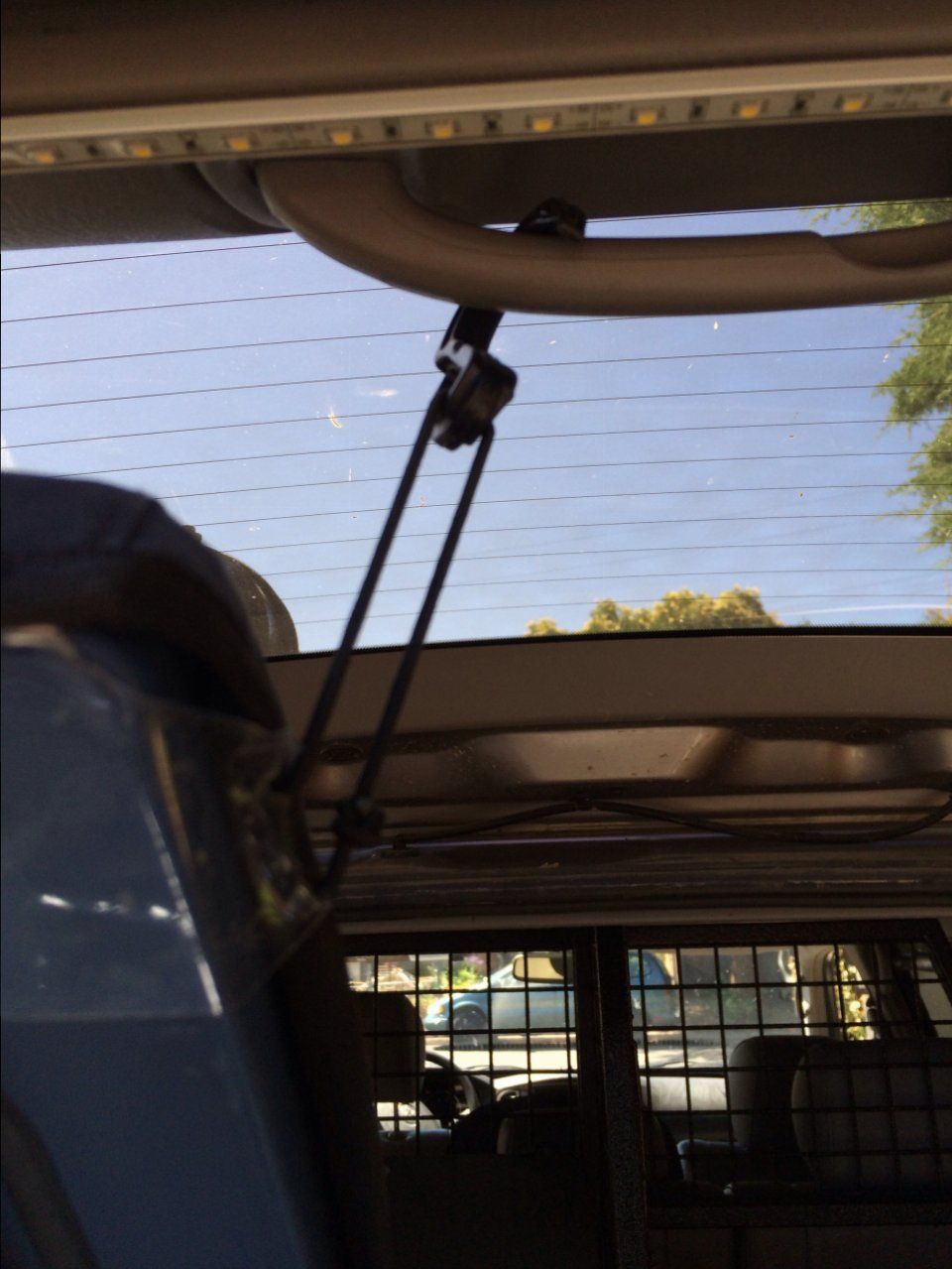

I cut the end off and used a powerpole. From there it goes to the fuse box. I anchored the cord with cable clamps after wrapping them with electrical tape to give some extra protection. I use a length of shock cord tied to the center of the cord. It pulls the cord out of the way and keeps it from rattling around. I also use a bit of the same cord and a bungee hook to hold the fridge lid open with the inside hatch handle. Hopefully the pics will help...

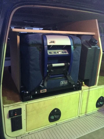

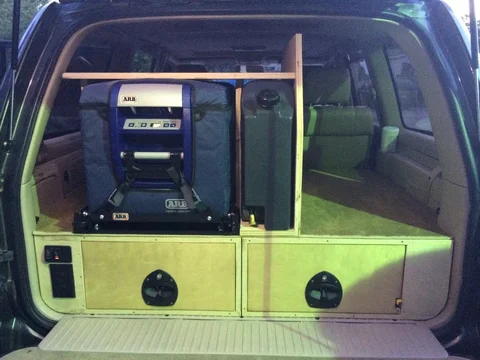

Also tweaked the jerry can holder and shelf setup. Should be ready to go!

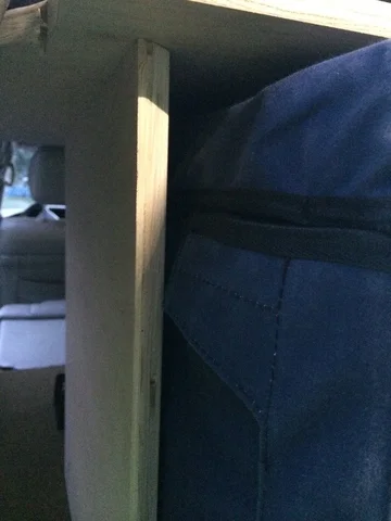

Added a bevel to the top shelf mainly for looks, and to each side support to allow the fridge/transit bag to slide back into place easily.

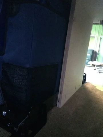

The side supports are built so as to allow full access to the vents/cooling fans at the back of the fridge:
