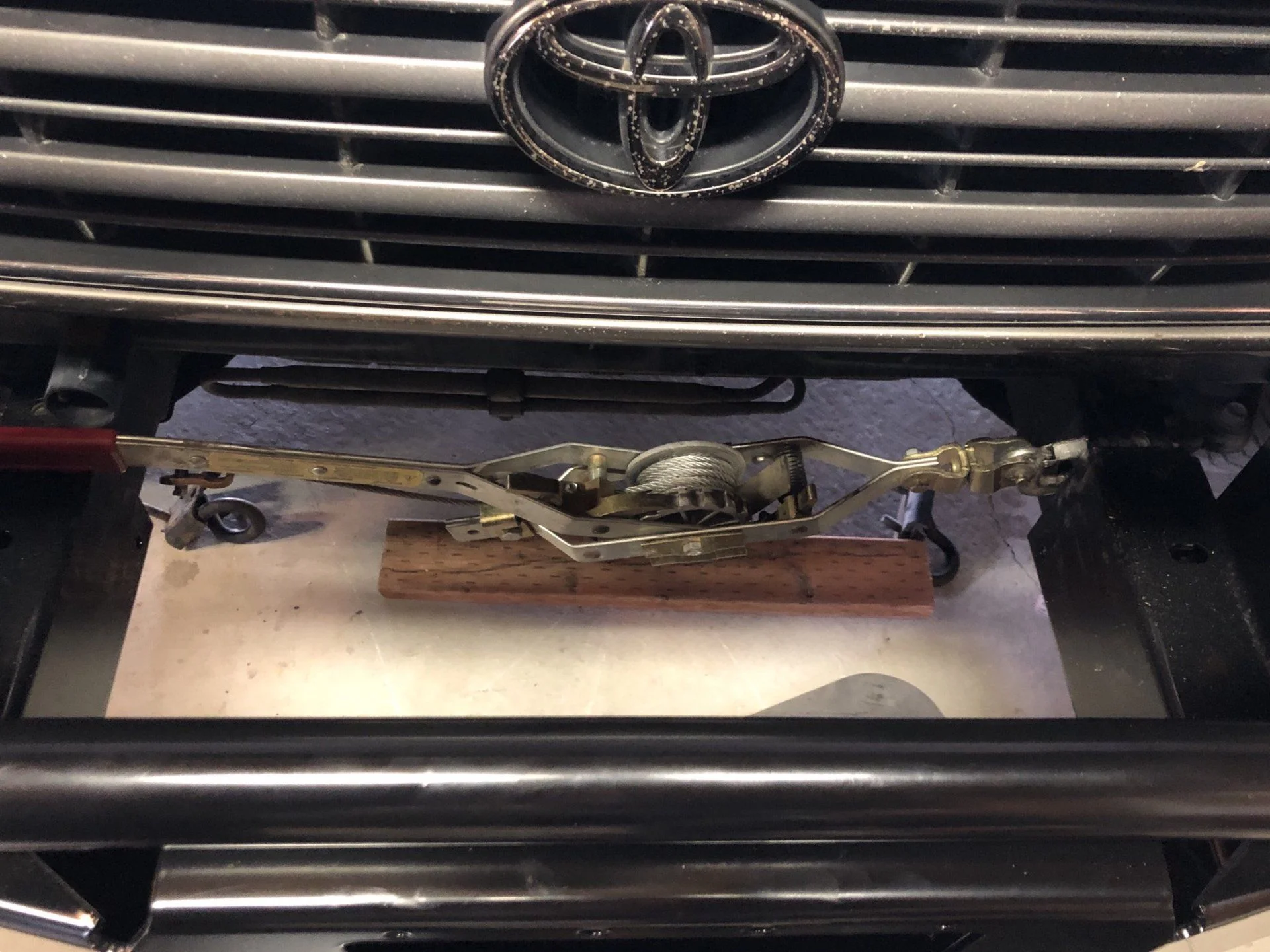

Fitting the bumper - I put a come along on the front rails of my rig and pulled them in slightly I think I got a solid 2-3 click in from it being tight. I also cut a 2x4 and fit it in between my bumper brackets to wedge them out slightly. (I’m not 100% sure if this helped much or not as it’s the outer part of the bracket that needs to expand.. but the board was on when it fit 🤷🏼‍♂️ Once it’s on follow the bolt order they laid out. I personally sorted all the hardware into like groups and the instructions suddenly made sense.

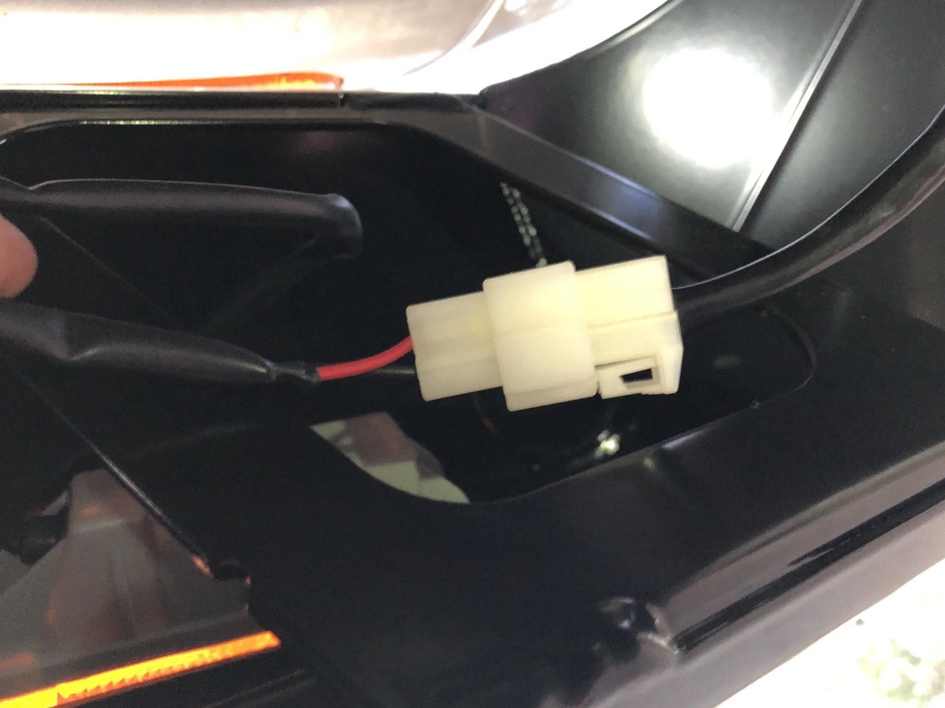

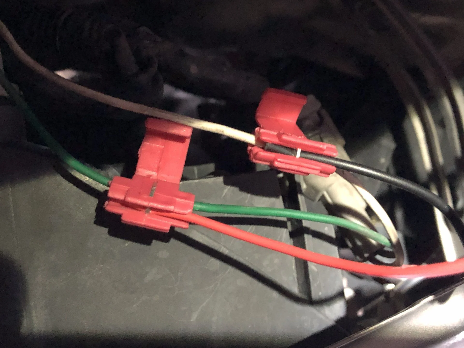

Wiring - it’s as easy as you think. I was just nervous to screw it up as I had no info what I was doing was correct. I put the o rings in and pushed on the black plugs through the indicator housing onto the bumper so it was attached then put the front lens on. Now build the other side of your plug putting the ends in correctly to match up with the pre built female end. I trimmed my wire down before splicing into my lights as I felt is as too long. I decided the black/white wires were my ground and the green ones my power. I tapped in before the bulb on my existing indicator lights. Putting my existing wires at the back of scotch loks in the back channel and the ARB wires in the front channel and pinched the metal down with pliers. Put some electrical tape around my wires and zip tied them in place and they work with my existing indicators perfectly.

And for future searchers... The OP picture of wiring - do *NOT* use scotch locks for 'tapping' into wires and even more ***NOT*** for external wiring in weather/mud etc. They work until they don't and become a corrosion nightmare to the wires they cut into.

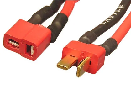

I used scotch locks. The scotch locks initially work by piercing the wire jacket. This leads to corrosion and eventually the wire will break in two. I soldered in Dean connectors instead and wrapped them in shrink wrap.
