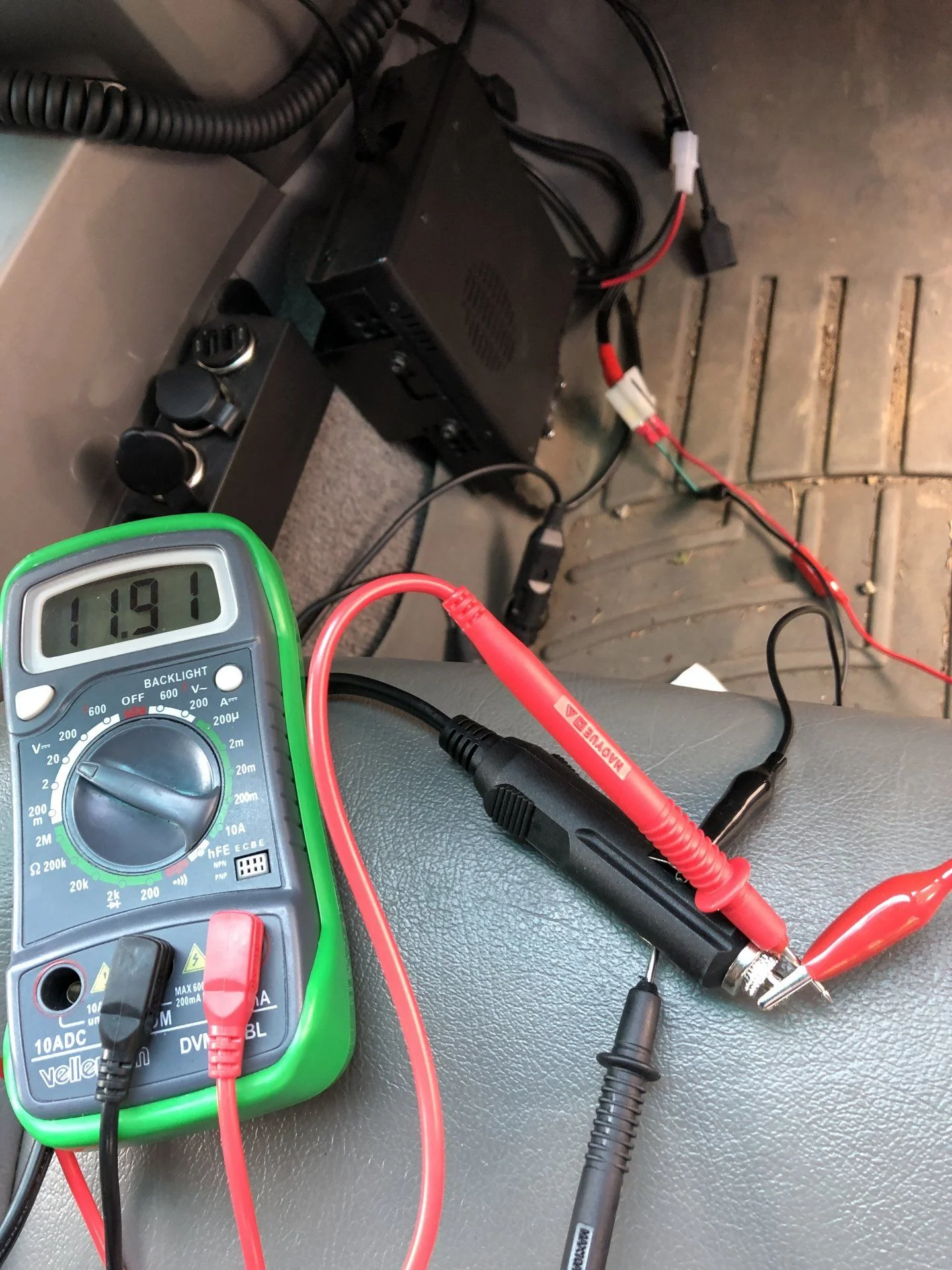

Anyone else having problems with the voltage cutoff? Got my JP50 this week, and today I tried it in my truck. Plugged it on a multi-outlet in the front of the truck and made sure to put the fridge in eco mode. Checked voltage at the outlet with a multi meter while the fridge is running and it shows 12.4 - 12.5 volts. Cutoff set at Low. After a minute or so the fridge shuts off and the display shows E1.
Alternately, did any of you wire directly to the battery for the fridge?
That ARB unit off Amazon doesn't look like it's compatible with the power cord that came with my fridge. Are you also getting a different power cord or power plug?

It is actually less efficient to run it off of 110 than 12v as the fridge needs to convert it back to 12v.
And I would not plug them into the stock 12v outlets. These need a dedicated outlet with larger wiring then stock. I would use a minimum of 10 AWG if not 8.
Direct connection seems to work much better, temporarily stealing power from my radio. Fridge has been sitting for an hour or so, voltage down from ~12.5 to 11.9. Maybe I need a new battery too.
