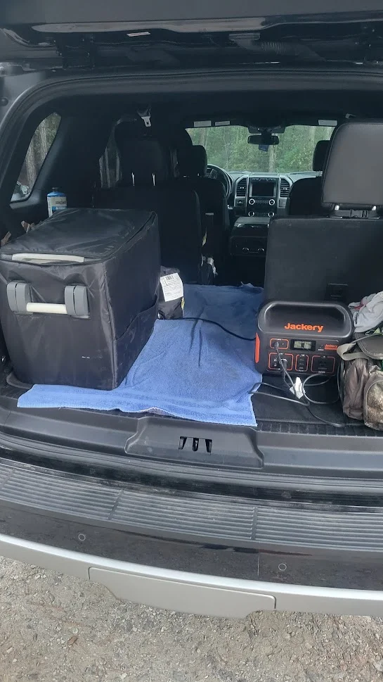

I took my kids camping for the first time this weekend. I love the Jackery / ICECO combo because I can move the fridge between vehicles with ease.
I ended up having to unplug the fridge for the night because we needed power inside the tent. From 8pm to about 7am, the temp in the fridge went from 37 up to 45 with no power. Next time, I will bring a second (smaller) Jackery.
