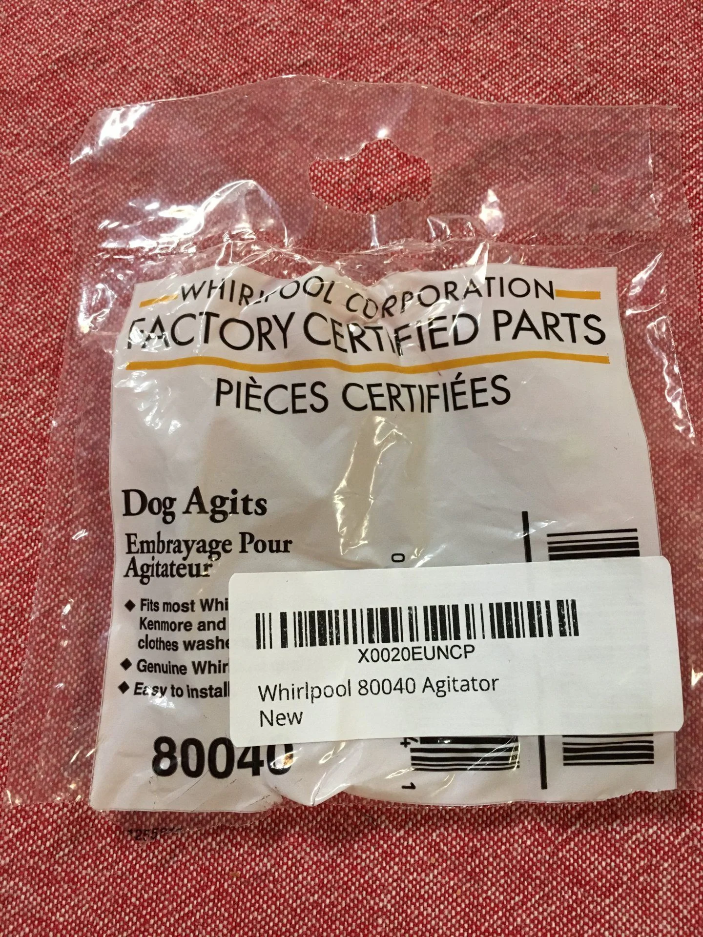

It was the lid safety switch. I just bypassed it with a jumper lead at the harness plug. Easy-peasy.

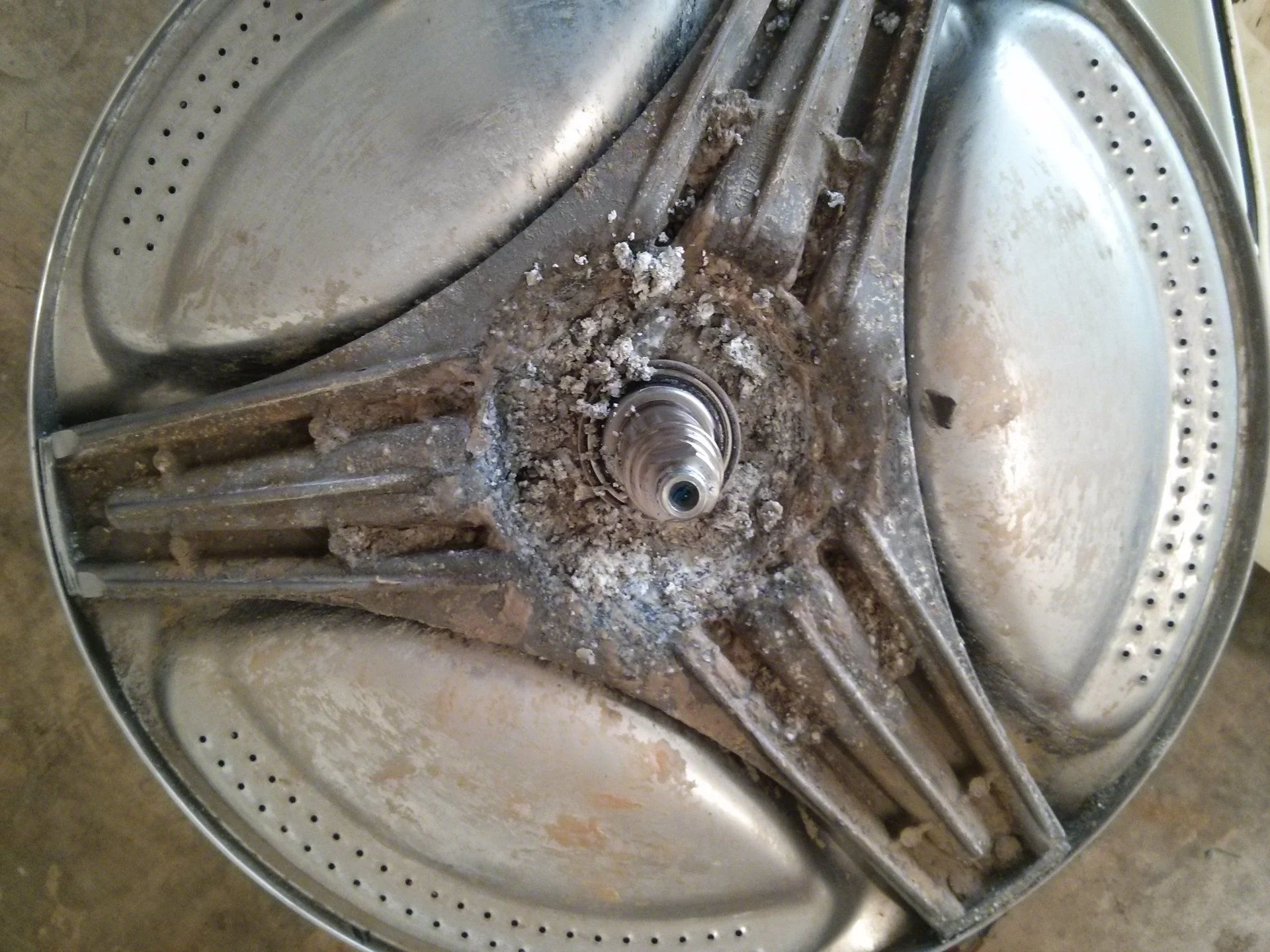

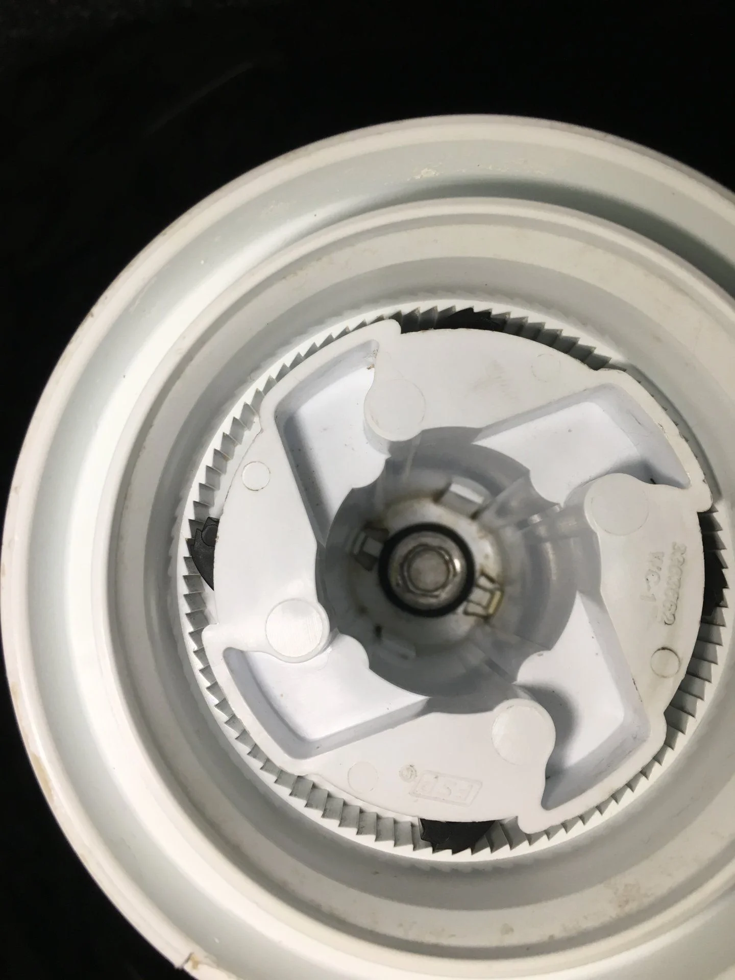

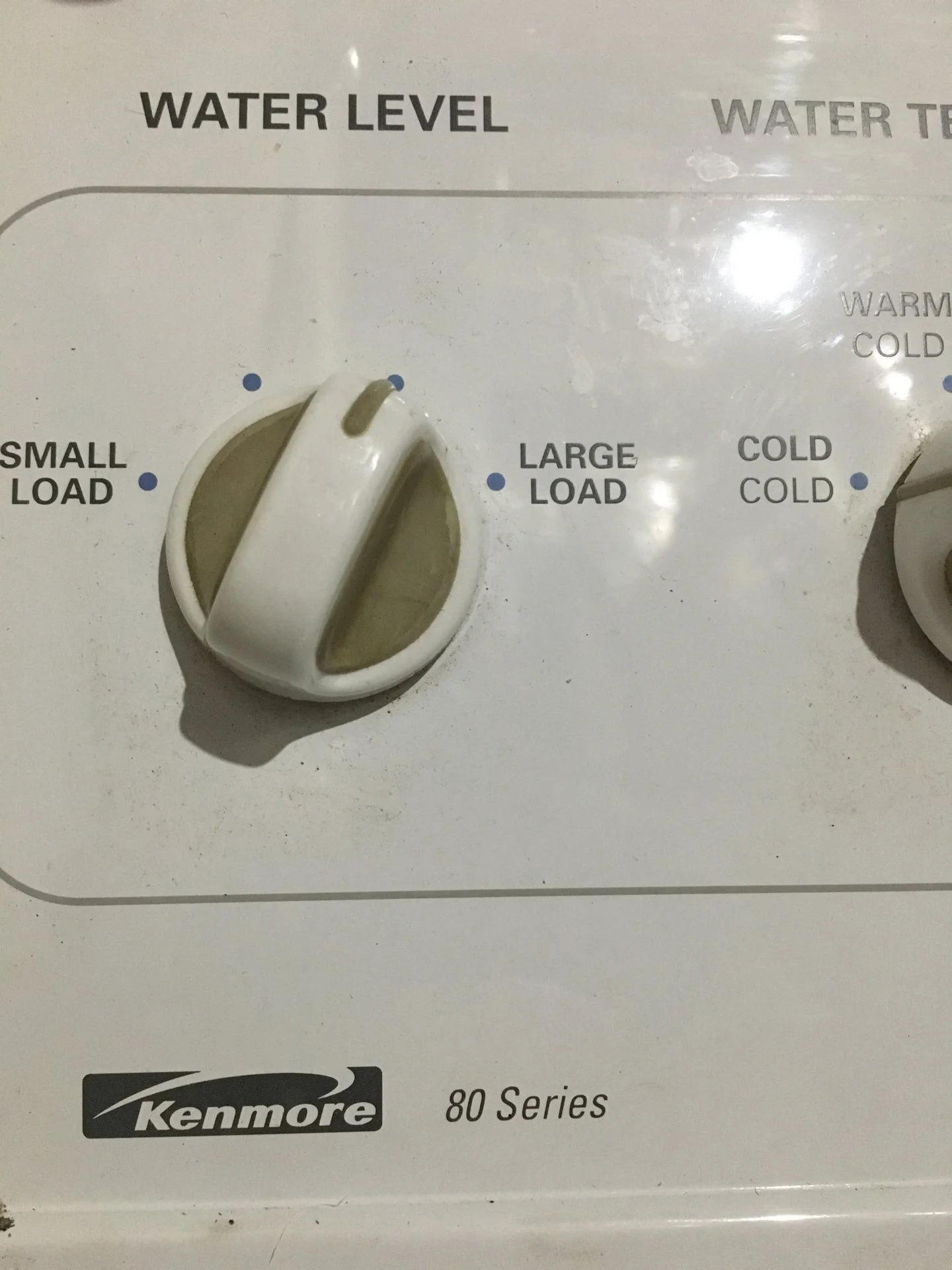

While it was down I decided to thoroughly clean the tub and spindle. A cycle of diluted vinegar and a cycle of diluted bleach in the tub. All the spindle parts got a hand scrubbing. Once I pulled the single bolt from the top of the drive shaft, I discovered the clutch mechanism was completely disintegrated. "Dog Agits" are available from Amazon for $4. Also replaced the non stainless hardware in the control panel brackets with SS. One of them was so bad I had to drill it out.
All is right again...it is an 80 Series, after all.
The black bits that engage the teeth are the dog agits.

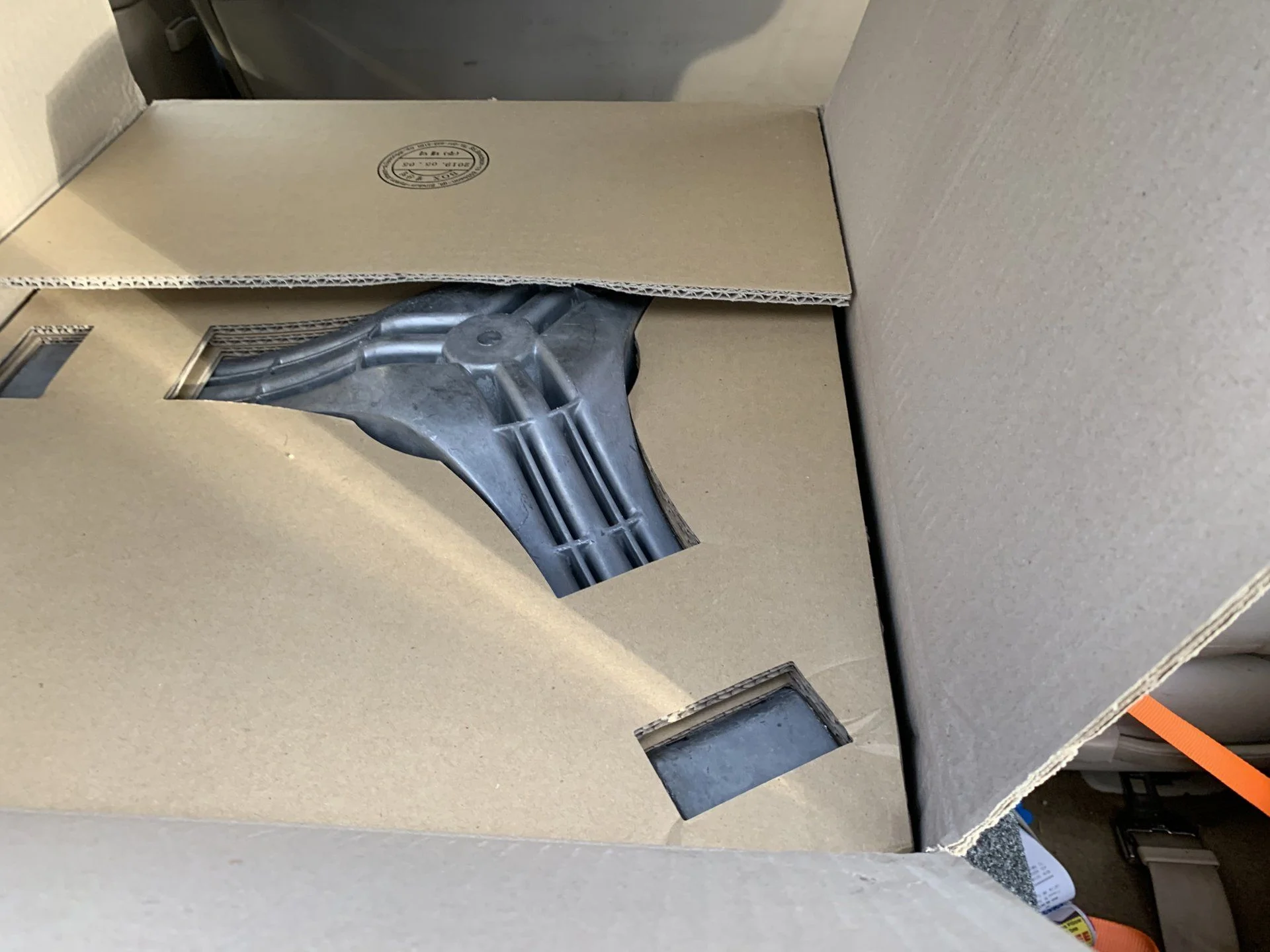

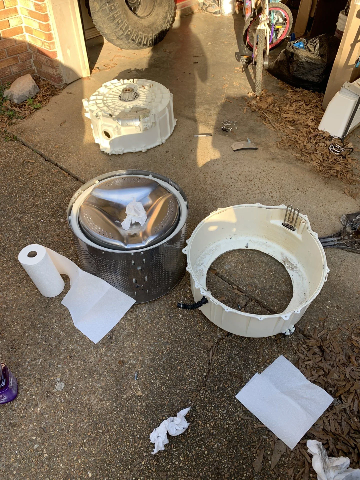

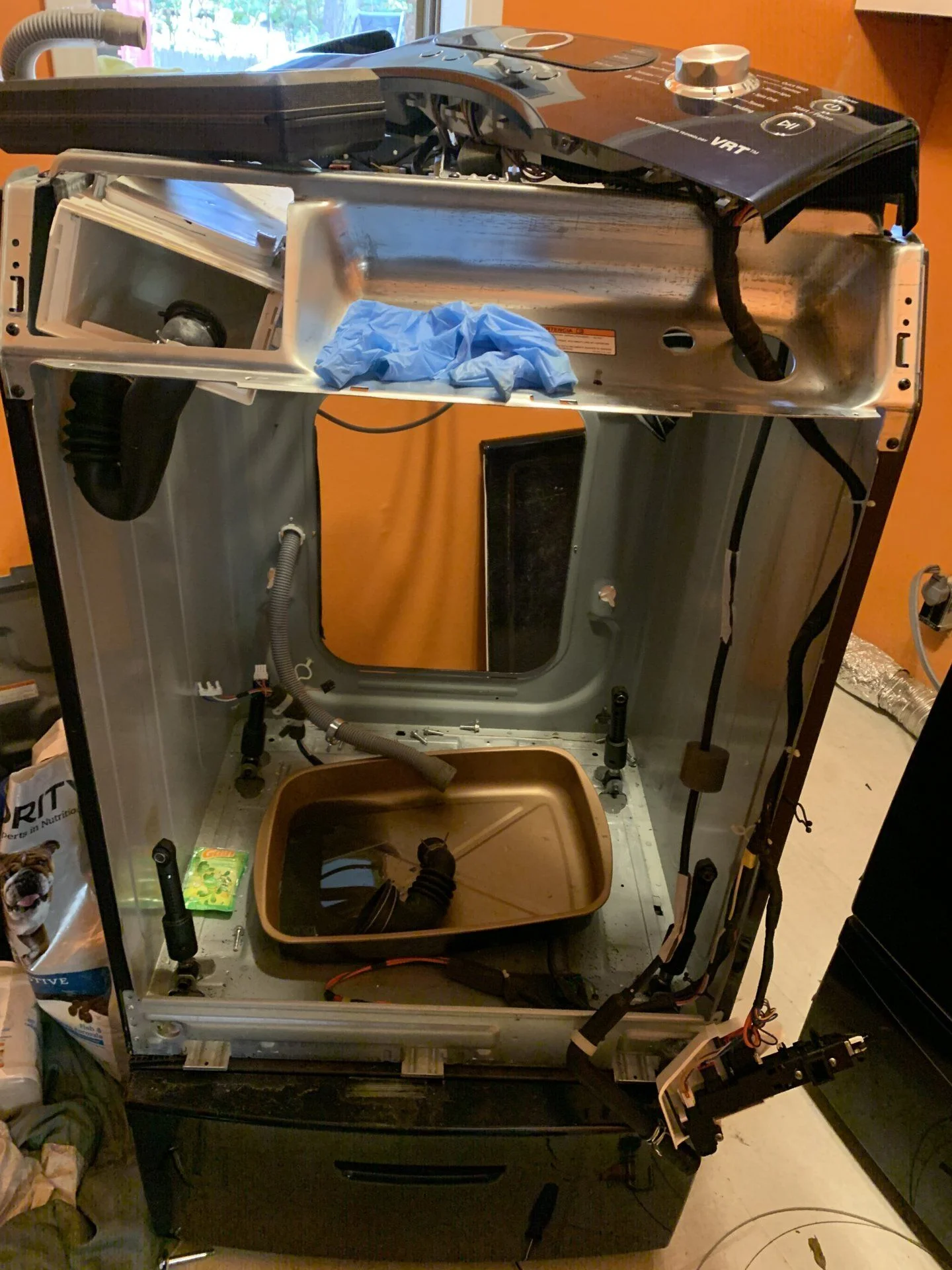

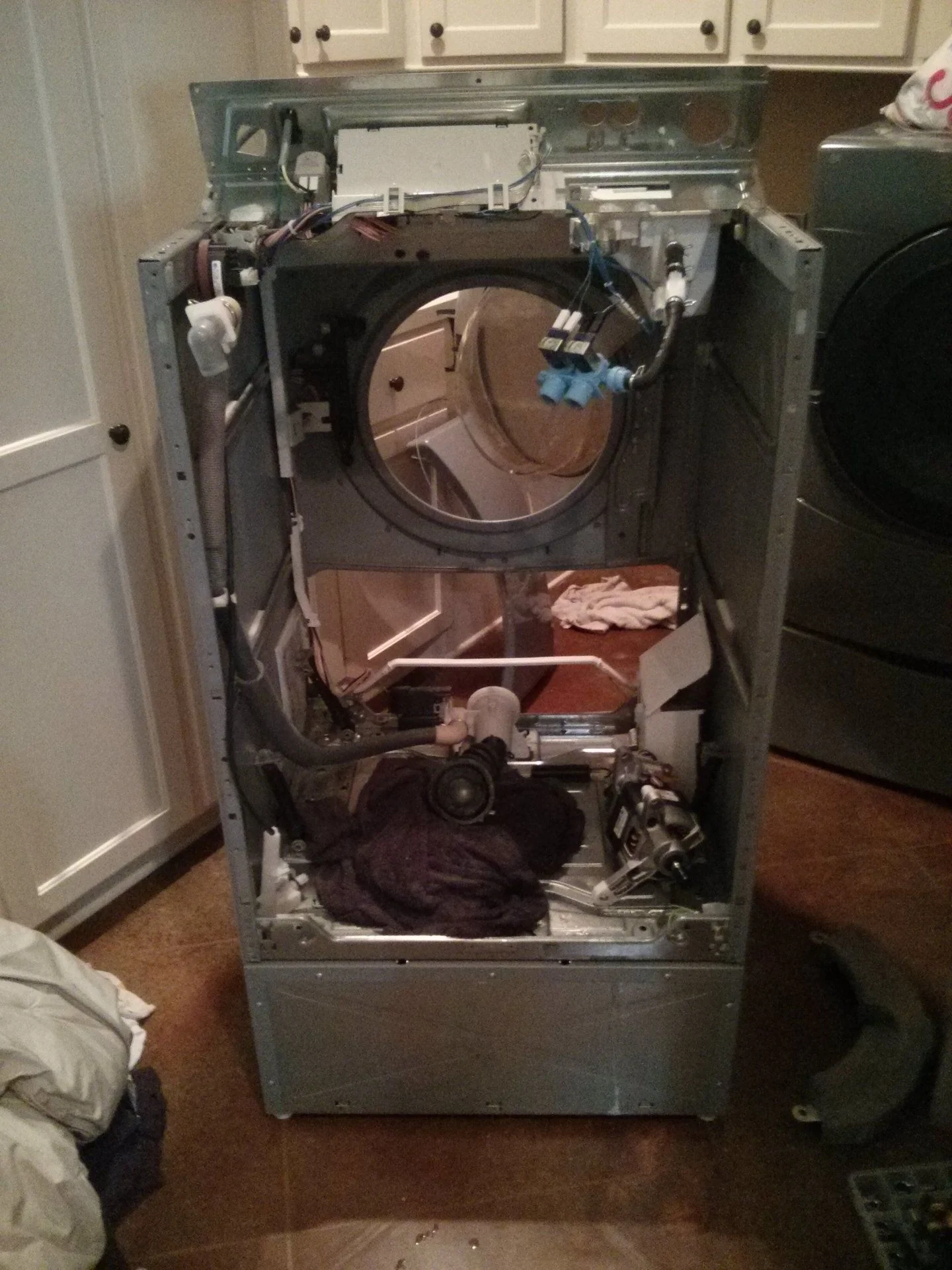

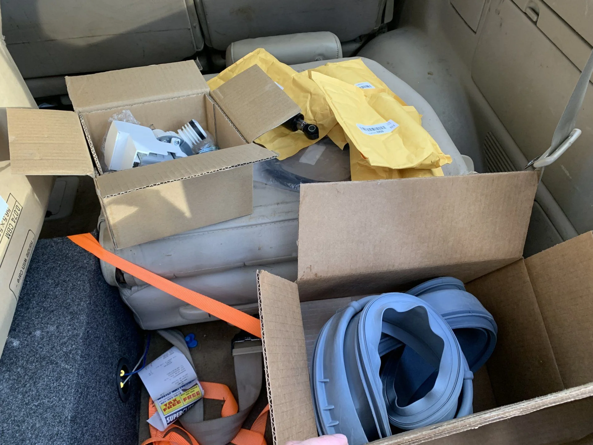

Started with the washing machine being off balance. Figured it wasn’t level after moving it back in the house. Boy was I wrong. Had a good idea that the Spider/Spindle that holds the drum may be cracked, according to my google-fu. So I order every part relating to the spindle, bolts, gaskets, shocks etc as well as a new drain pump as I have been replacing them about once a year for the past 4 years. Roughly $350 in parts. Parts came in today, on an off day from the shop. I have succeeded in turning my laundry room and driveway into an appliance repair horror story. There are parts everywhere not to mention random spots of blood on the new floors from cutting myself and not knowing. The washer is apart and spider/spindle is definitely broken. Open the box with the new part and the spindle looks nothing like the broken one I just removed. All parts were ordered for my specific Model Number and were verified with the serial number. Turns out I have the “Early” motor design and the parts sent are correct but will require purchasing a new motor assembly in order to use it. How much is this “later” motor for a washer that I bought in 2007, you may ask...$332.74...f-that. This one is going in the trash and it’s time to buy a replacement. If I would of known there was a chance of having the mysterious “Early” motor I would of bought a new one last week when I ordered all the parts. Time to go negotiate a deal on a new pos that will eventually fail and require replacement in the future.

Poor design that essentially submerges pot metal in caustic cleaning solution. F these modern day pieces of garbage...#replacedontrepair
Build a fire pit with the stainless drum.
