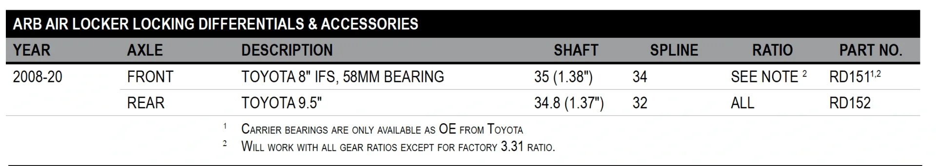

I think Eaton/Haroop only offers the rear elocker, whereas ARB might have both front and rear air lockers.

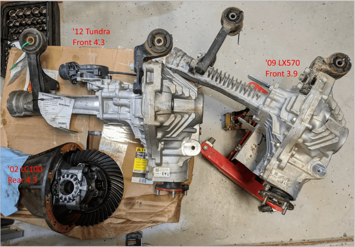

Eric Sarjeant had posted some pictures of the diffs from various years. Found it: Is there no Front E-Locker for 2016+ ? - https://forum.ih8mud.com/threads/is-there-no-front-e-locker-for-2016.1200784/post-12999505

You can run the Tundra diffs in the later 200s if you want to run a front locker.
Interesting, but don't the front tundra diffs have actuators?
