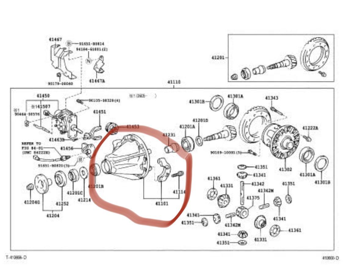

@orangefj45 Remedial question for putting in '13 and earlier gears: is the carrier that needs to be replaced on the '16+ this part?
