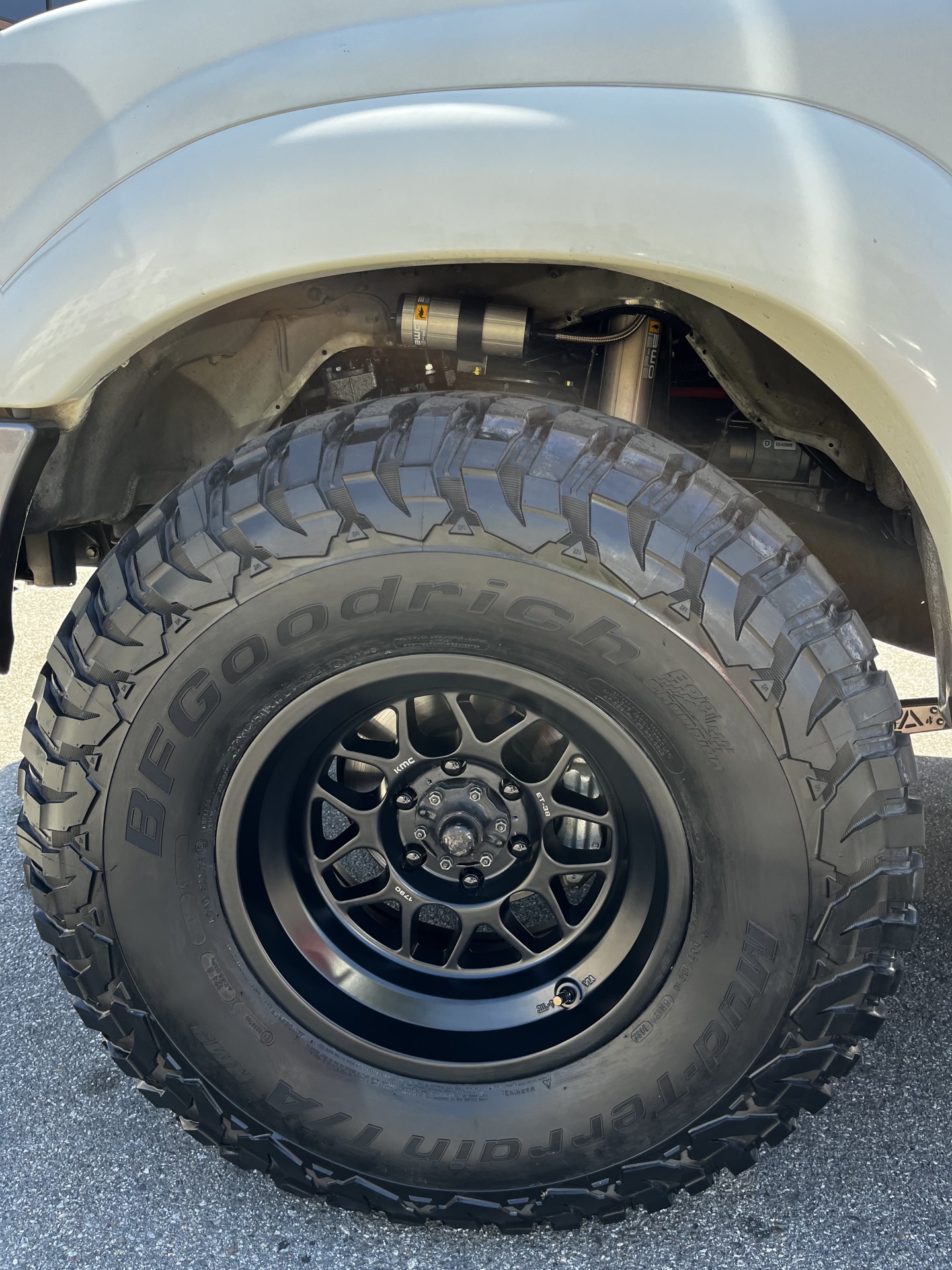

  • Running 37x12.5r17
  • Delta 4 arms (regular)
  • OME medium springs
  • Caster is at 4 degrees
When I ran Cooper AT3 XLTs, I was rubbing on that back side left front fender turning left at certain declines or inclines, reverse and forward. Now that I'm running BFG KM3s, I no longer rub simply because the MTs have a less squared off shoulder which is a pleasant surprise.

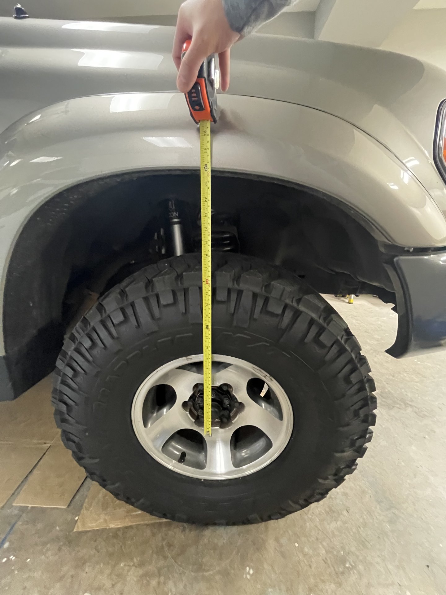

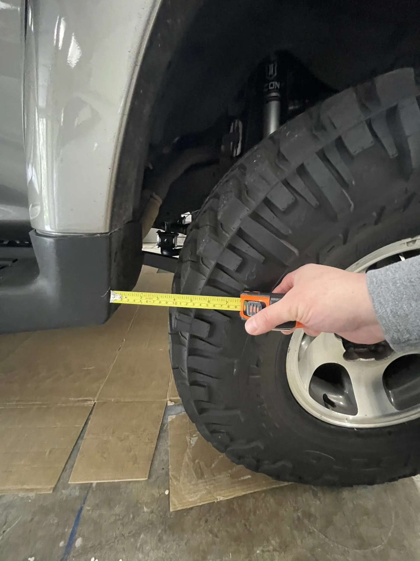

For folks who are stock bodied like my 80, you’re most definitely trimming the front plastic factory corner bumperettes at a minimum. They will rub and will rub worse with longer versioned aftermarket arms like Delta’s.
Aftermarket bumper, way more room, but can’t speak on it as I don’t run one and won’t ever.
Inner fender liner on the backside can be bent or tapped for more room. If you look behind it, it's actually pretty flimsy and spaced far away from any heavy iron like the frame. No cutting necessary in my case described above.

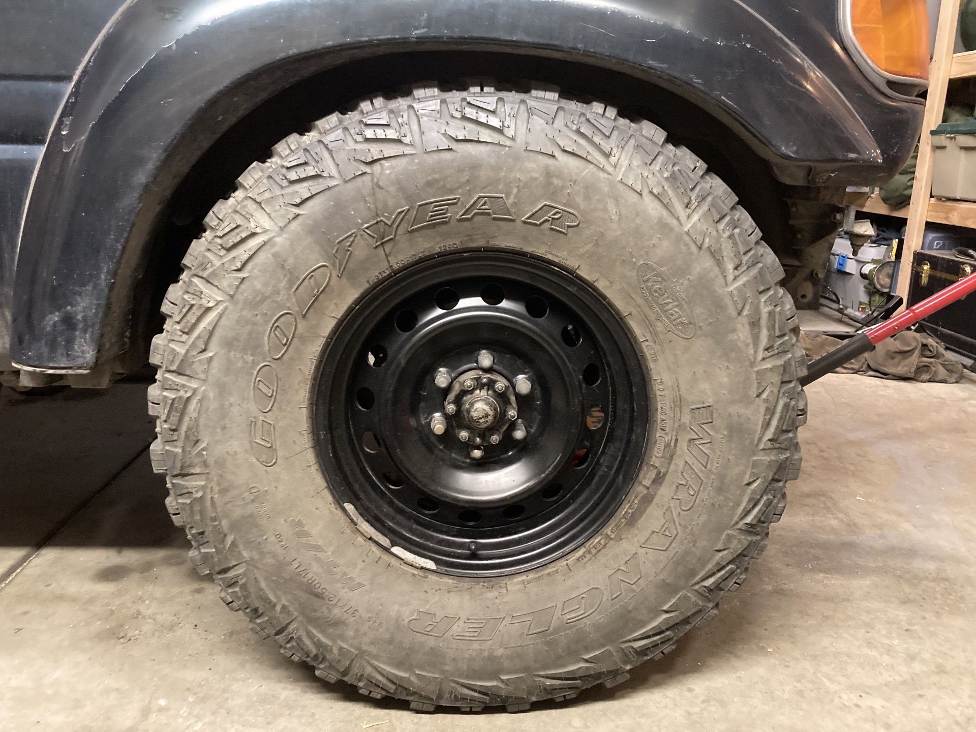

It all comes down to what the true tire & lift size is and if you really wheel it. Like the Goodyear MTR 37s are just over a 36" tall tire.

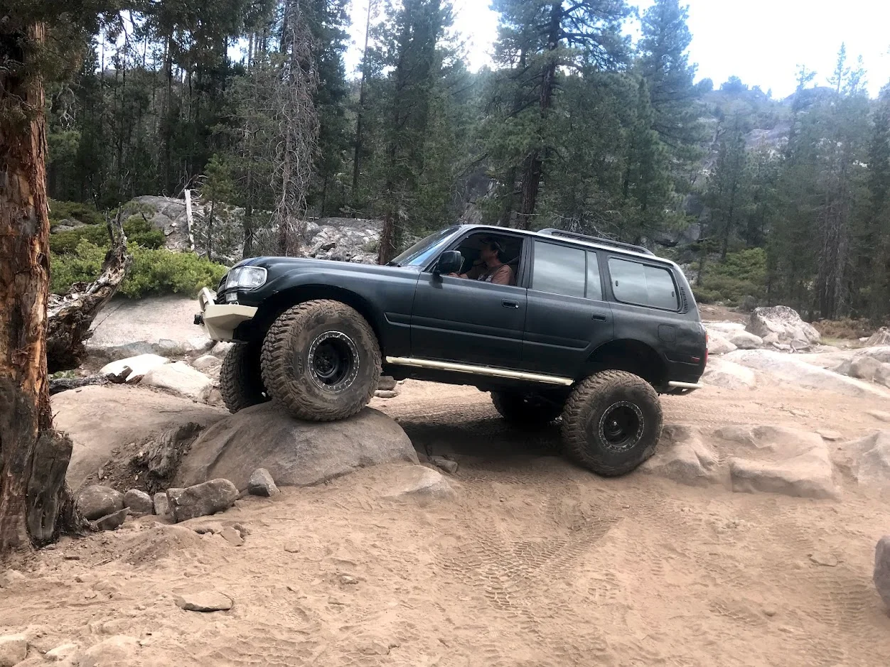

If your close to a true 37" tire and are going to run trails Like the Rubicon you need to cut about 3/4" at the back of the fender. theirs plenty of room for that before you get to the fire wall. Then you can gut the the fender flares.
Something like this.
If it's a mall crawler no trimming necessary.
37x12.50r17 MTRs measure 36.8”, which is damn near a true 37. Perhaps you’re thinking of BFGs, which measure 36.3”.

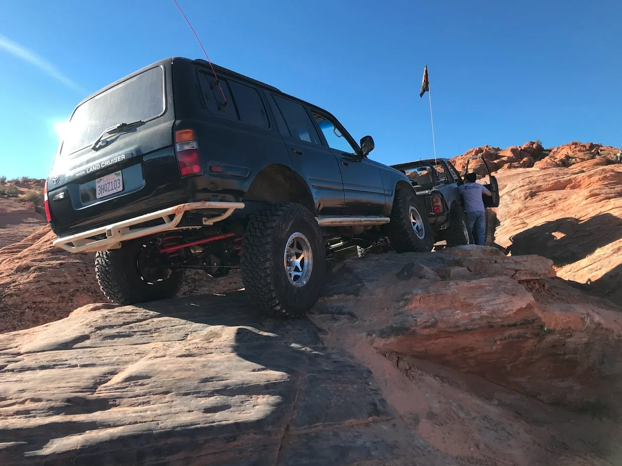

The previous suspension setup I had would rub a lot under articulation but I could air the bags up taller and try and take routes that didn’t stuff a front tire when the wheel was cranked to the side. You learn to work with what you got.
Now I have the clearance, but the tires rub radius arms. Meh.

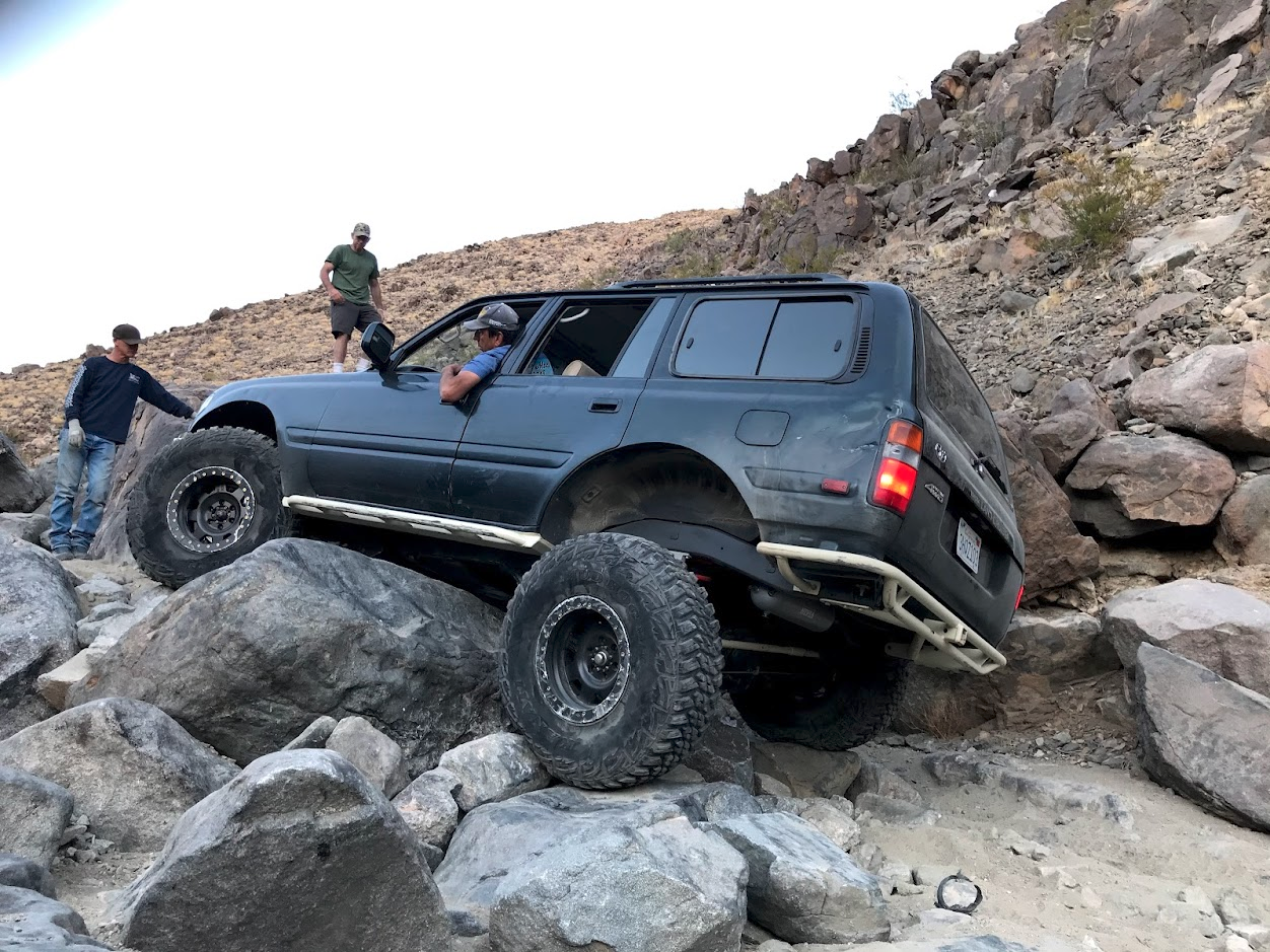

39s on a 3" lift and lots of cutting, out west you need a lot of articulation.
