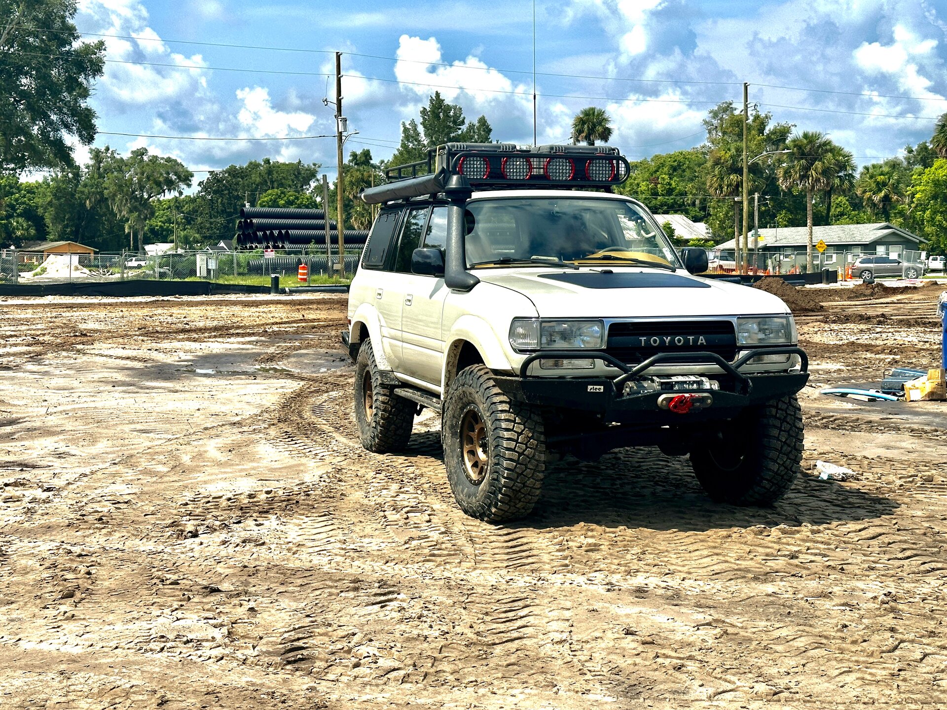

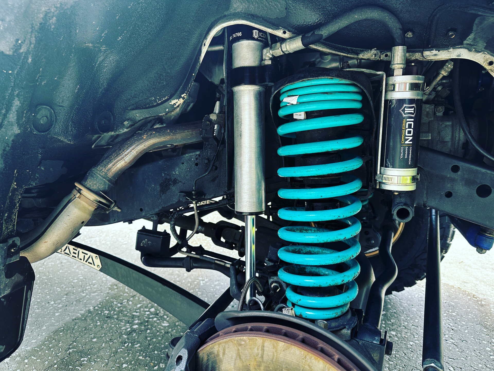

37” bfg km3’s with Dobinsons vt144 c97 springs, delta 3* arms, slee sway drops, Dobinsons adjustable panhard rod and icon shocks…no rub…no issues…drives and tracks great…no rubbing when flexing
