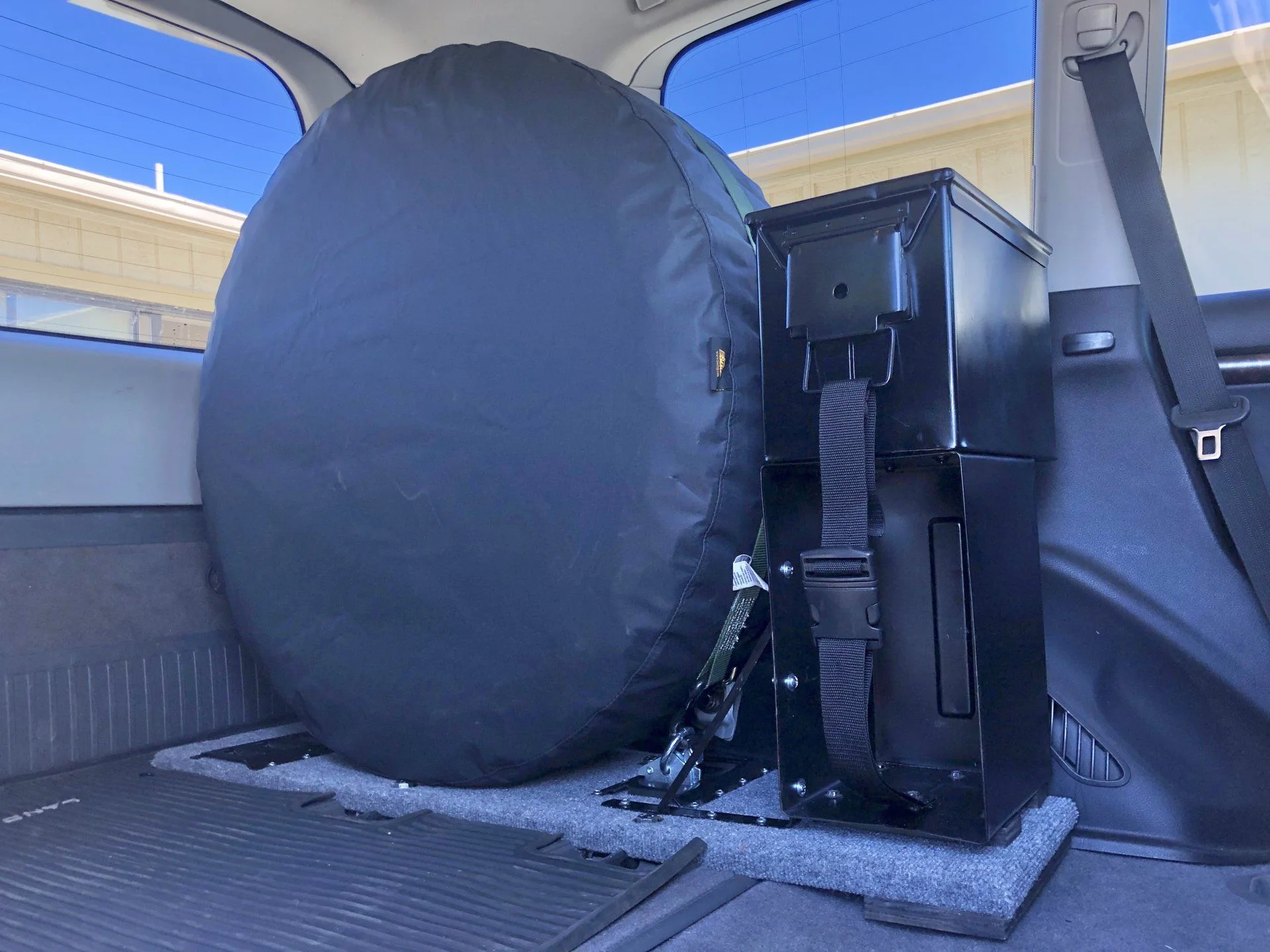

I did this to mount my spare and a couple of ammo cans to hold all the same stuff. It’s holding up great!
