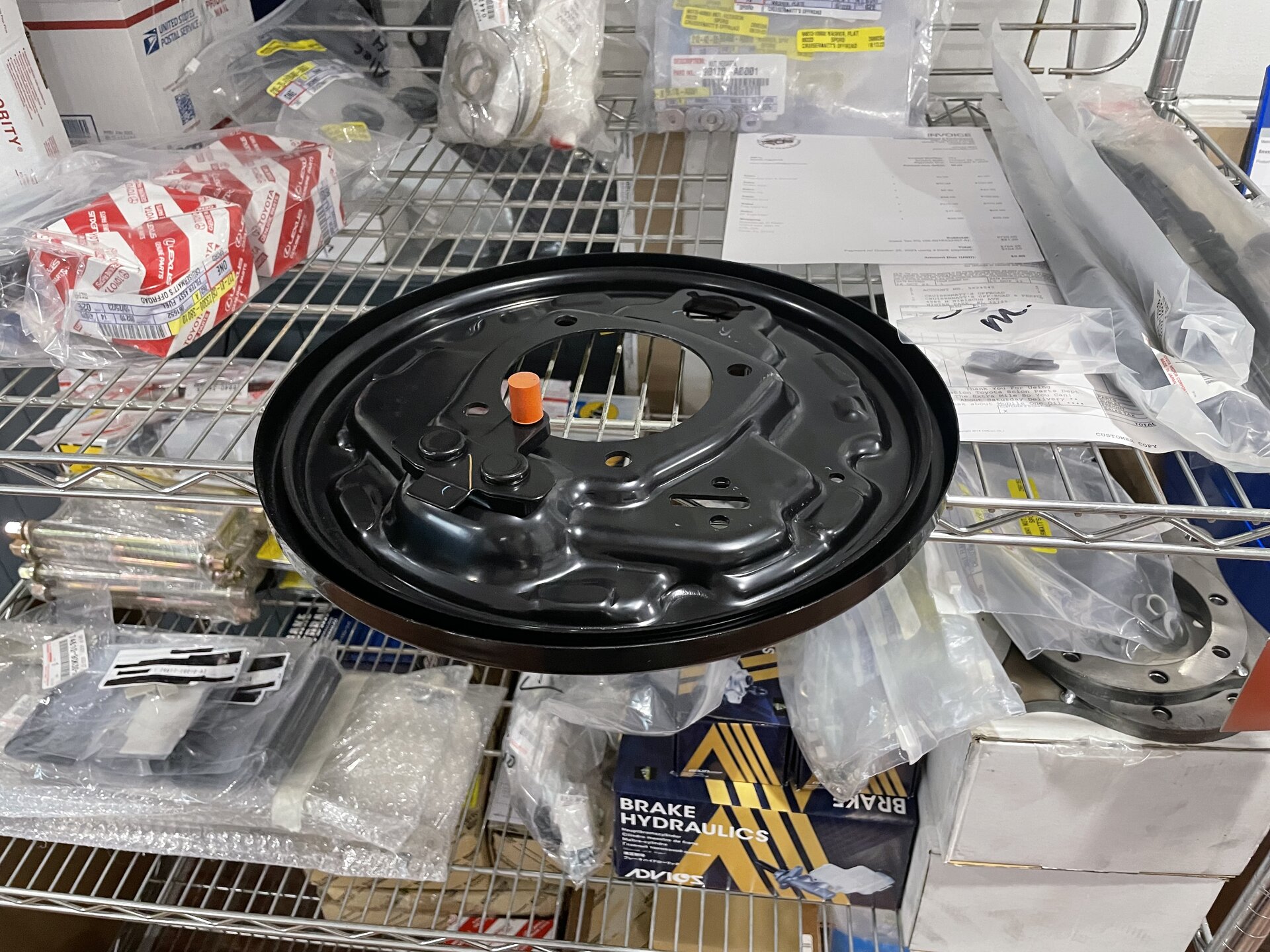

Hey John, they are available new (along with every component on the rear brakes) and they do have that part on them. I should have them in stock too :)
Thanks Matt, pm incoming. @cruisermatt

Heading your way :cool:
Thank you for the support!
That’s a pretty piece of equipment. Thanks Matt.
