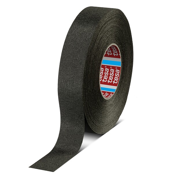

I wrapped my loom with heat resistant Tesa tape and then used this specifically near the EGR.
Tesa tape is the bees knees. Also insanely abrasion resistant.
I'm pretty sure current engine harnesses are wrapped this way now. Maybe not with these products, but certainly something like them. Toyota is nothing if not observant.
I used this exact method two weeks ago on mine!
Wrapped the harness Tesa tape then DEI heat shield with a couple stainless steel ties. It has held up for a couple years now.
