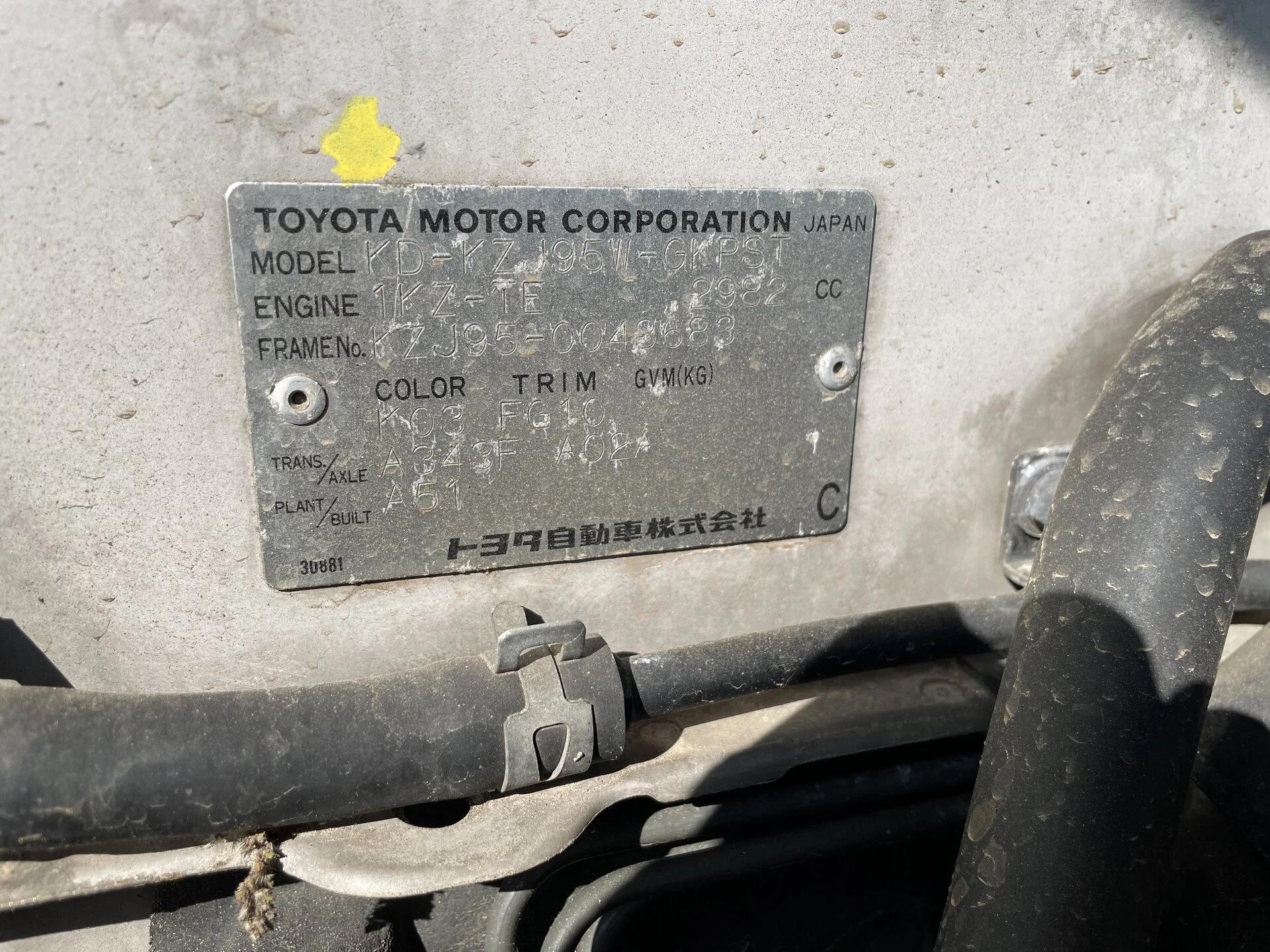

Can you post a photo of the data tag on the firewall? IIRC if the axle code ends in a 3 or 5 it is LSD, if 2 it is open, if 4 it is locked. Ring gear size is the letter in the code, ratio is the first two numbers. This generally holds true, though on my LJ78 the axle code is G144. This would indicate an 8" ring gear, 4.875:1 ratio, and 4 pinion locking differential. All this is correct except for the locker, which mine never had. 🤷‍♂️

A02A looks like
