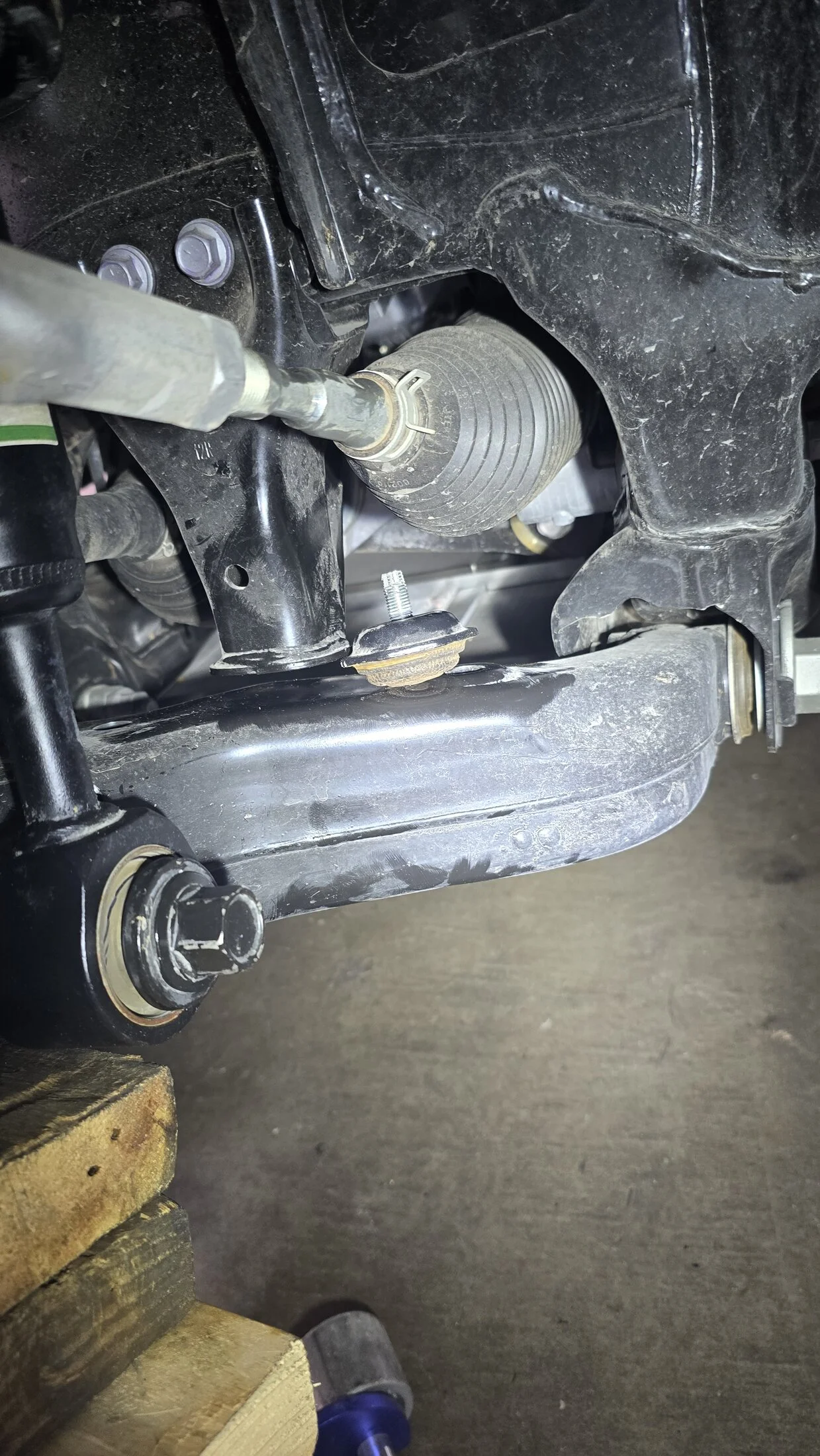

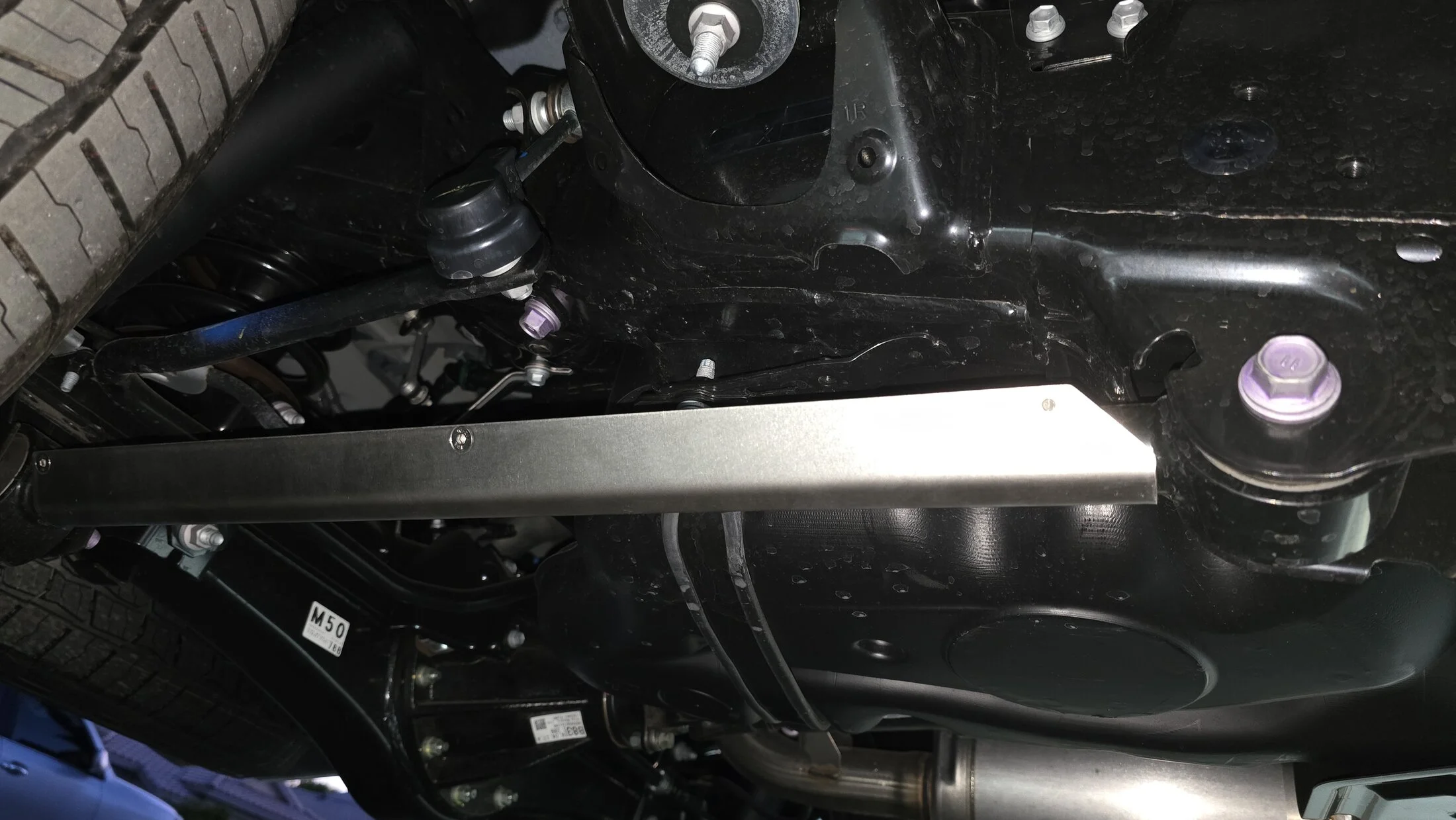

It looks like my rear lower control arm skids/brace fits, I still need to do some more testing before I say they fit for certain. The control arms bend under the weight of the vehicle, these fixed the problem on the 200 series. Link

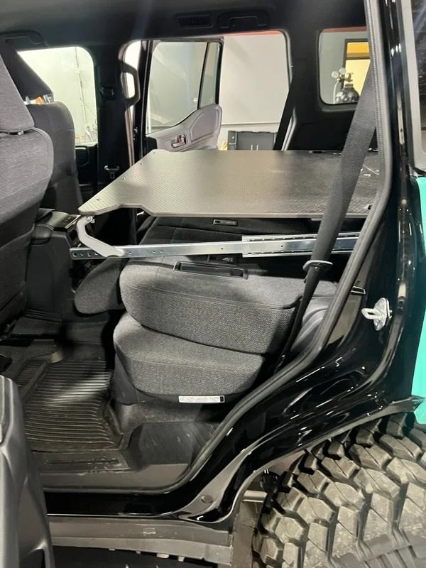

Can you post up some photos of the drawer system showing height compared to the folded 2nd row?
Also I'd been interested in seeing more details on the sleeping platform setup as well as how the overall setup is mounted in the vehicle.
Sure thing! The system height is largely driven by the desire to accomodate the CD30 Fridge. That has become a very valuable component of our design, adding a ton of utility and flexibility to the systems.
Here's a picture showing how the sleeper is supported over the 2nd row. This sleeper is self-supporting and does not rely on the 2nd row in any capacity. With this sleeper you can even remove the 2nd row for weight savings and additional storage. Here's a link to our technical forum where we'll be exploring features in more and more depth:

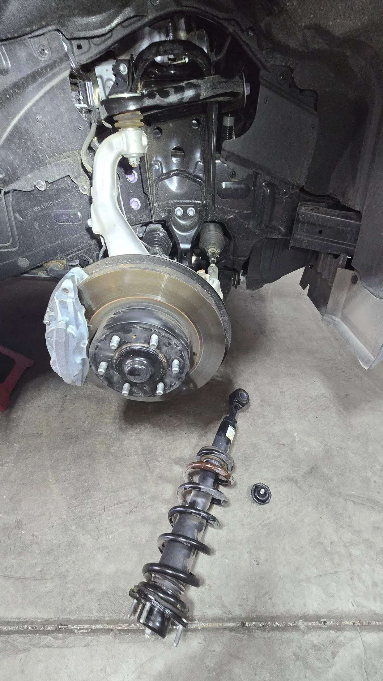

Following up, someone gave out bad info online. Upper coil-over mount is not the same bolt pattern as a tundra/200 series. OEM spacers for a 200 series do not fit.
Some more info:
I measured stock front wheel travel at 8"
There is 4" of bump travel and 4" of droop.
A spring preload 2.5 kit, will leave you 1.5" of droop. Something I would not want.
I was able to remove the coil-over without un-bolting anything else. I assume the swaybar disconnect aided in this.
I'm going to disassemble the coil-over and see how much shock shaft is left before bottom out. This will let me determine if I can add a top spacer to increase ride height and droop. Just like the OEM spacer for the 200 series.

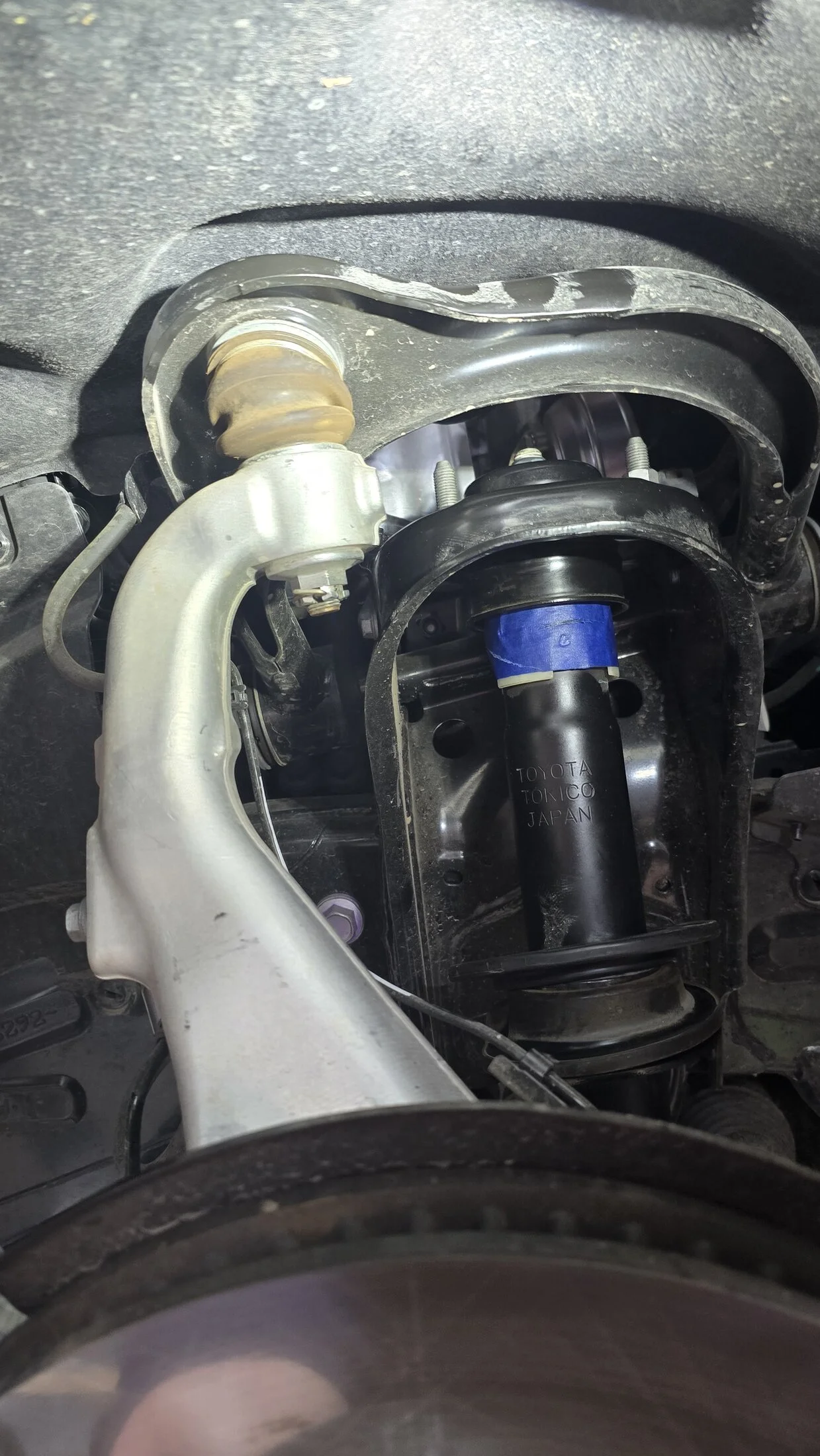

There was about 8.5mm of shock travel left at full bump. Black line is where the shock bottoms out.
I had the lower bump stop out, just to make sure.
To be safe, I'll be only making 1/4" thick spacers. Hopefully this will raise the height by 3/4" and increase droop travel by the same.
There was about 8.5mm of shock travel left at full bump. Black line is where the shock bottoms out.View attachment 3693689
To be safe, I'll be only making 1/4" thick spacers. Hopefully this will raise the height by 3/4" and increase droop travel the same.
