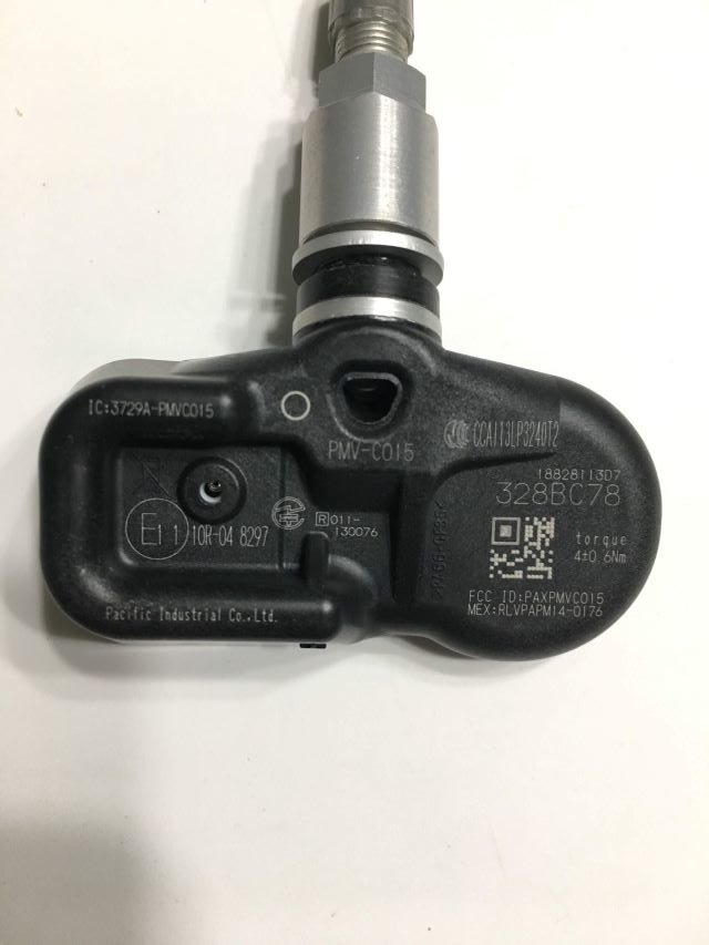

I just found out the hard way that the 2015 and below TPMS sensor doesn't work at least on the 2019. I was doing my research and saw that the Denso/Pacific 5500105 PMV-C010 sensors from my 2015 Highlander were the same part # on a 2018 LC according to Rock Auto. They don't list anything yet for the 2019 but to my knowledge, there's no difference between a 2018 and 2019 so I assumed that they work on the 2019. Got my RW Wheels installed, programmed the LC with the sensor IDs but my tpms dash light won't turn off.
I had time last night so I uninstalled the sensors on my original 18" wheels and lo and behold, they have a different part # PMV-C015. I'm going to swap them out later today and have to re-program the old IDs back.

I had time last night so I uninstalled the sensors on my original 18" wheels and lo and behold, they have a different part # PMV-C015. I'm going to swap them out later today and have to re-program the old IDs back.View attachment 1996771
Toyota's current Part Number for the TPMS Sensor up to and including MY2015 is 42607-33012. This replaces Part Numbers 42607-52010, 42607-52030, 42607-33010, 42607-33011, 42607-34020, and 42607-35010.
Toyota's current Part Number for the TPMS Sensor for MY2016 - MY2018 (and I assume MY2019) is 42607-48010.

Yup, MY2016-MY2019 is 42607-48010 or DENSO 5500106

Advance Auto, Denso and the Rock Auto site both show the wrong sensor as compatible with my 2016 (5500105 PMV-C010).
I confirmed the PMV-C015 is the correct sensor after cross-referencing the OEM # and seeing this thread. This should save me some headaches swapping in and out the wrong sensors.
