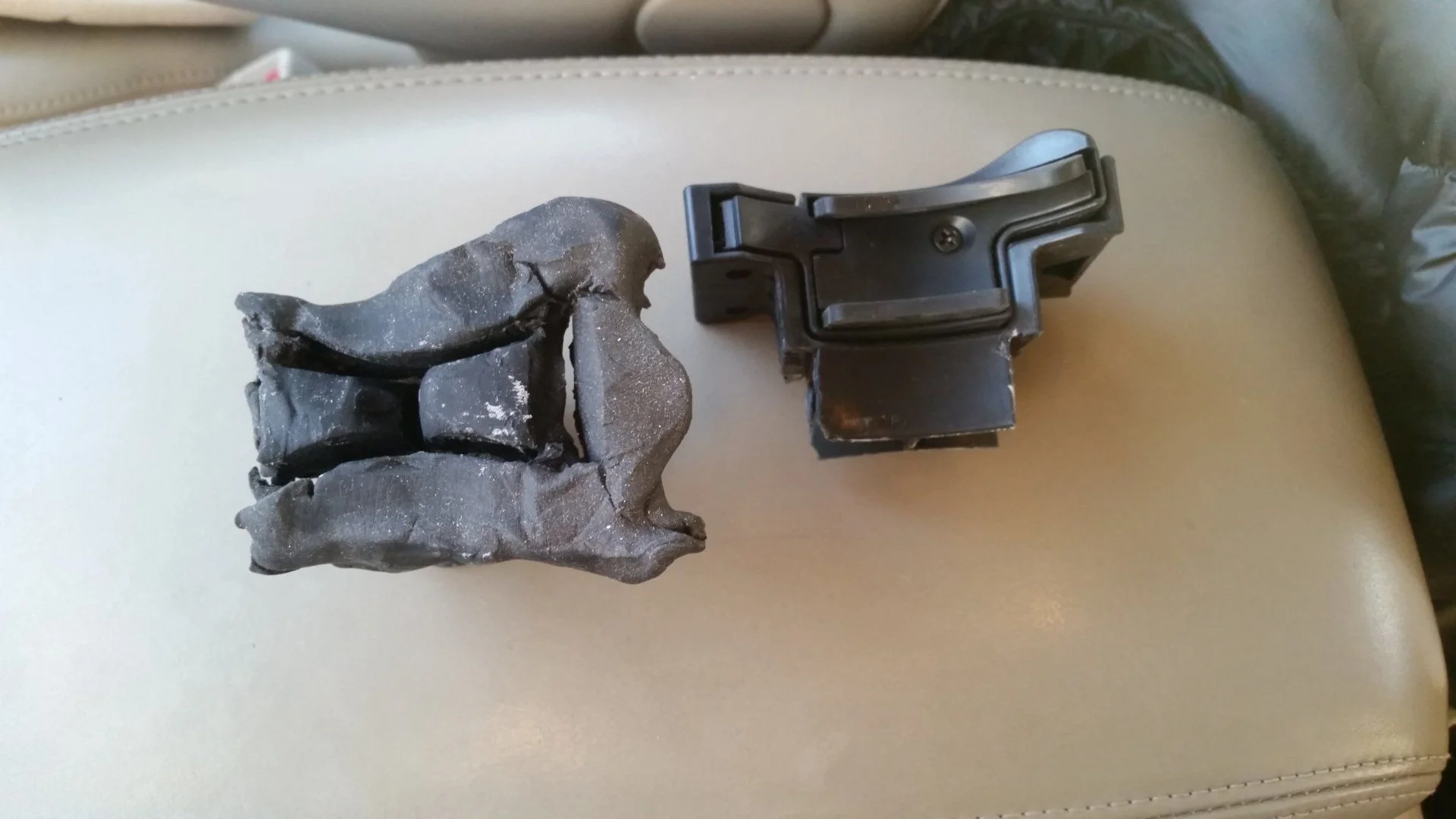

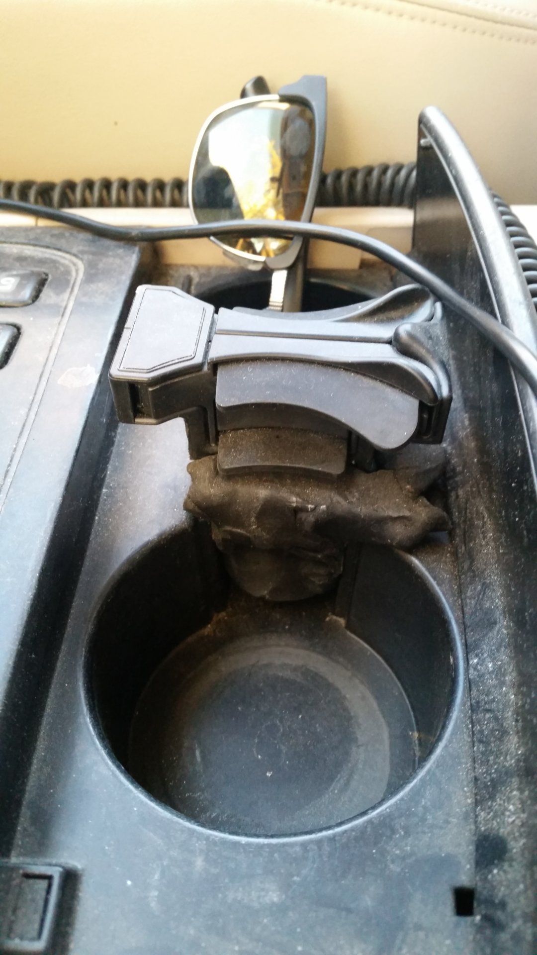

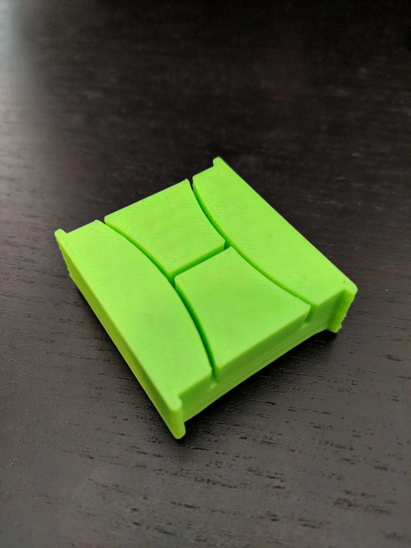

I'm working on 3d printing a converter that holds the wings from the newer vehicles. It should hopefully replace the clay monstrosity I made earlier. I'm still working on getting the dimensions right at the moment.

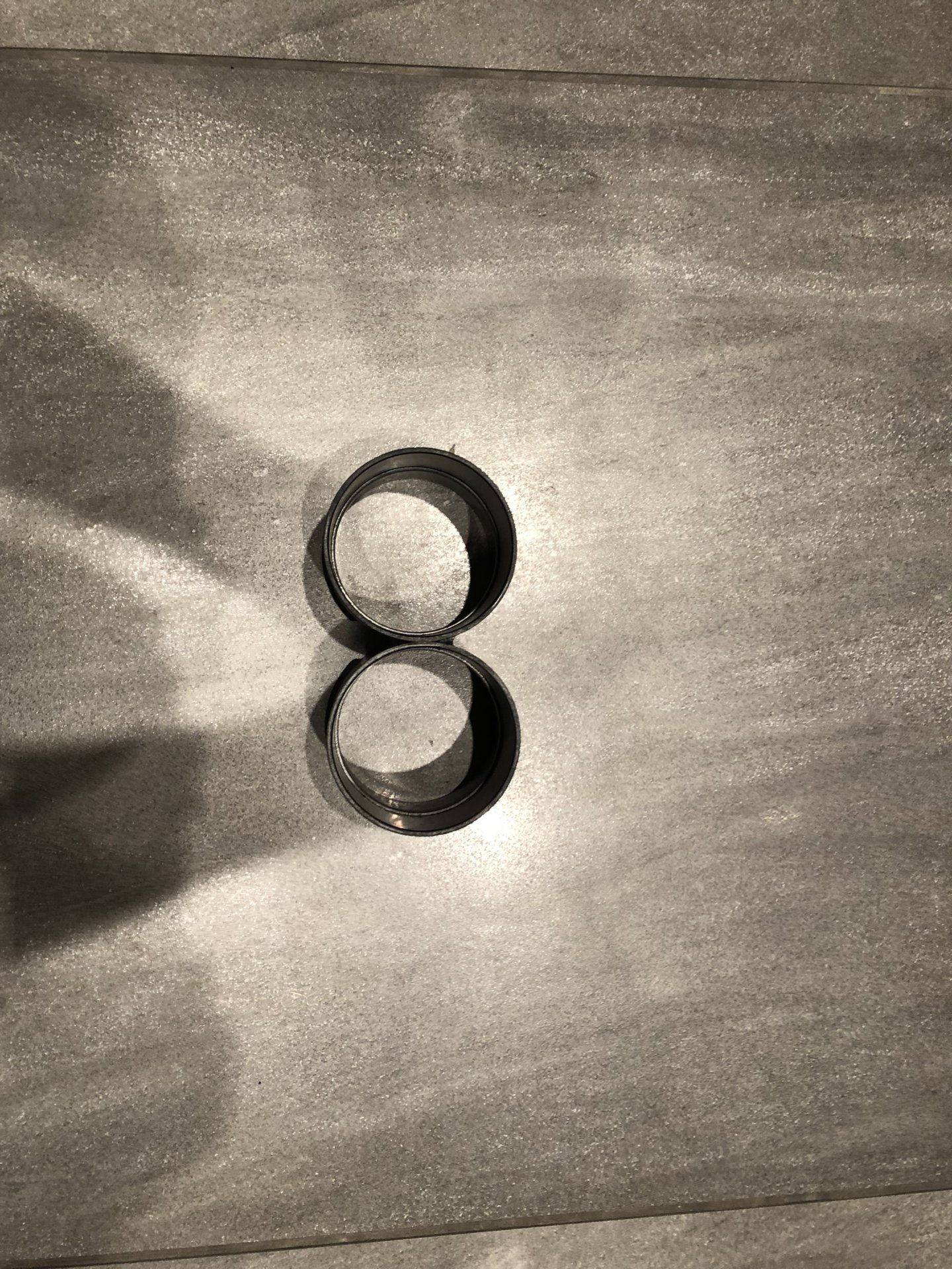

My drink tipped over ladt week and I decided to make a cup holder upgrade.

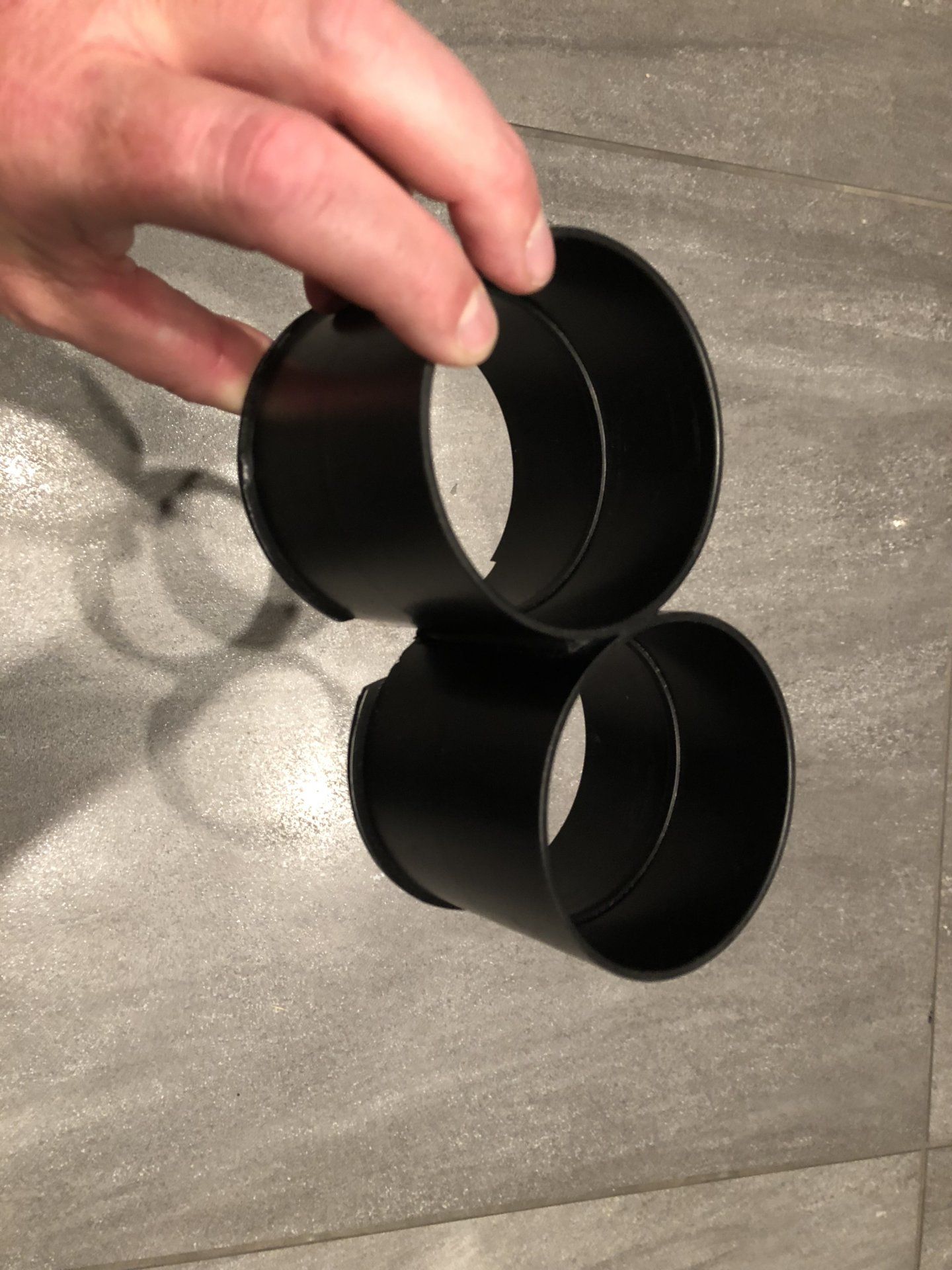

Here is the finished solution.

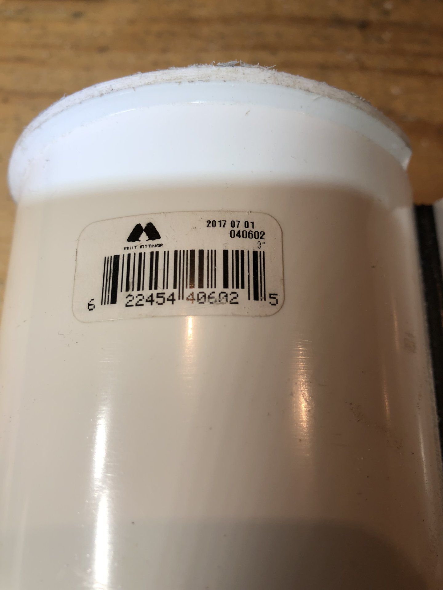

Sorry for the double post. I bought 2 PVC fittings from Home Depot. Used a Dremel tool to notch each fitting so it fit nicely in the cup holders. Then clamped the two fittings tight to each other and used some black for in place gasket RTV to glue the fittings together. After the RTV was cured I used some flat black trim paint. Works great. Here are some pictures.
