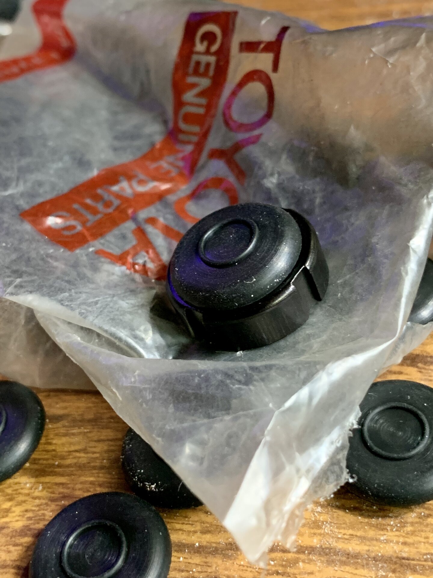

the oem dash plug suggested above , is for a FJ40 Pull Switch D-Groove hole of 9mm I.D.
- the FJ60 Factory Choke Cable D-Groove Hole OEM dash plug delete needed is for a 11mm I.D,.
- the FJ40 one will simply fall out on the floor and roll into history fast ........ :confused:

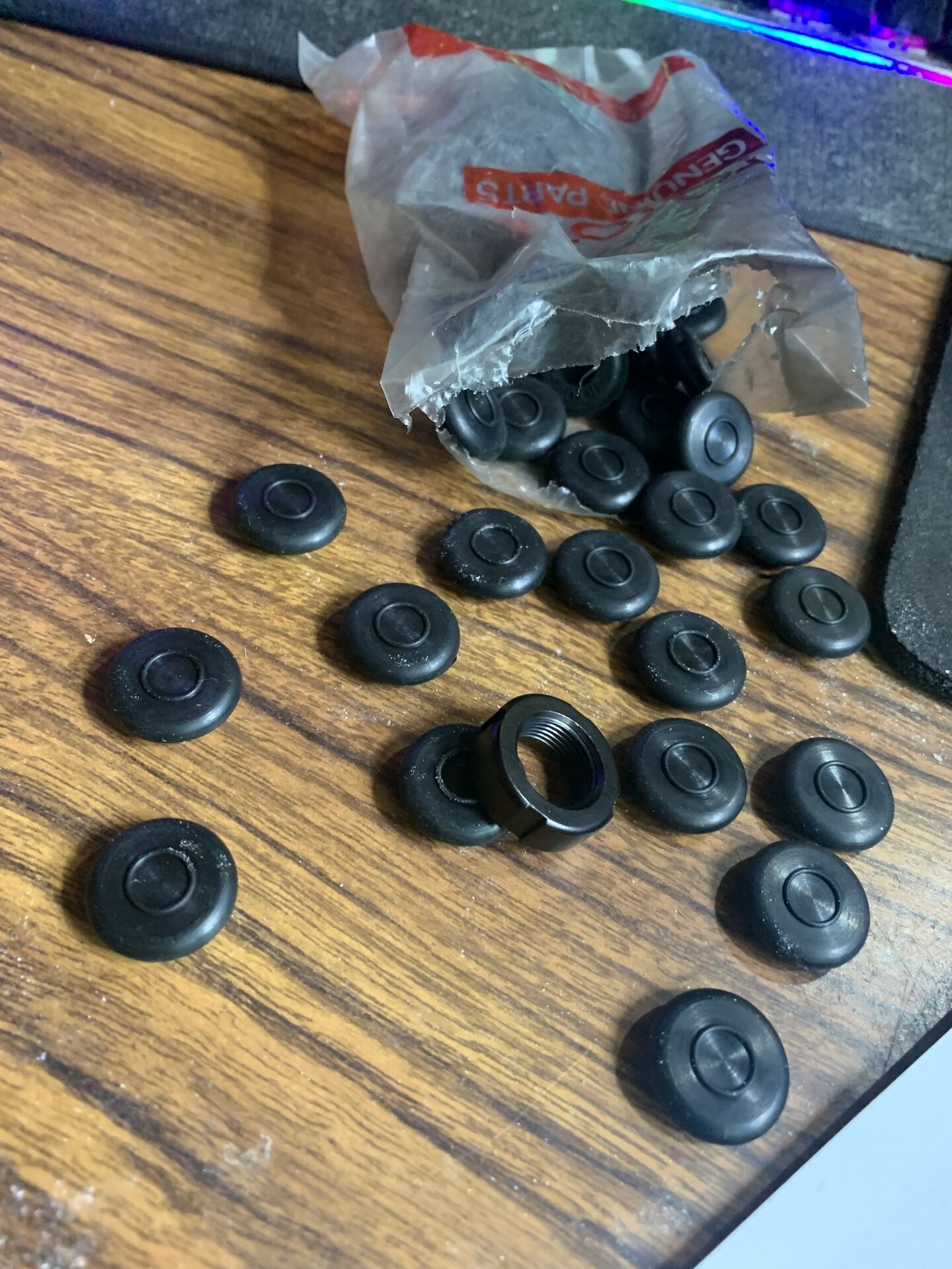

- i have a small cache of NOS FJ60 ones still , ill be happy to mail you one out , i think it's super kool when a OEM final step-by-step done by the FSM , as was at PLANT A11 is thought of ......
- i like period correct OEM details that matter alot , perhaps at a level some can't fully comprehend , only thing that matters is that we are indeed growing in numbers each day .......:D

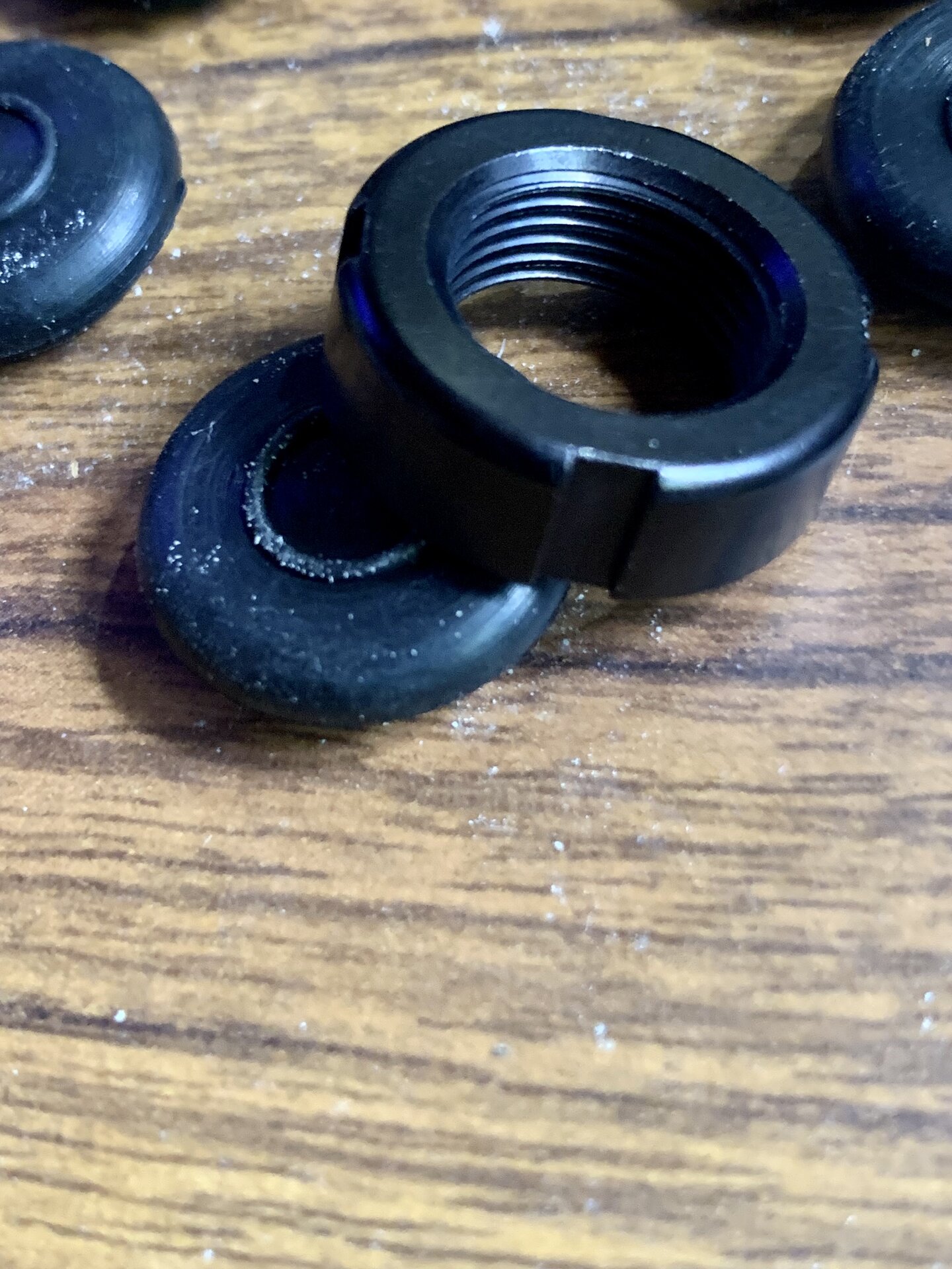

- here is the 11mm 90950- ..….
- the anodized little cog ⚙️ is the FJ60 choke cable M11 retainer nut
- I like period correct details that matter …..
