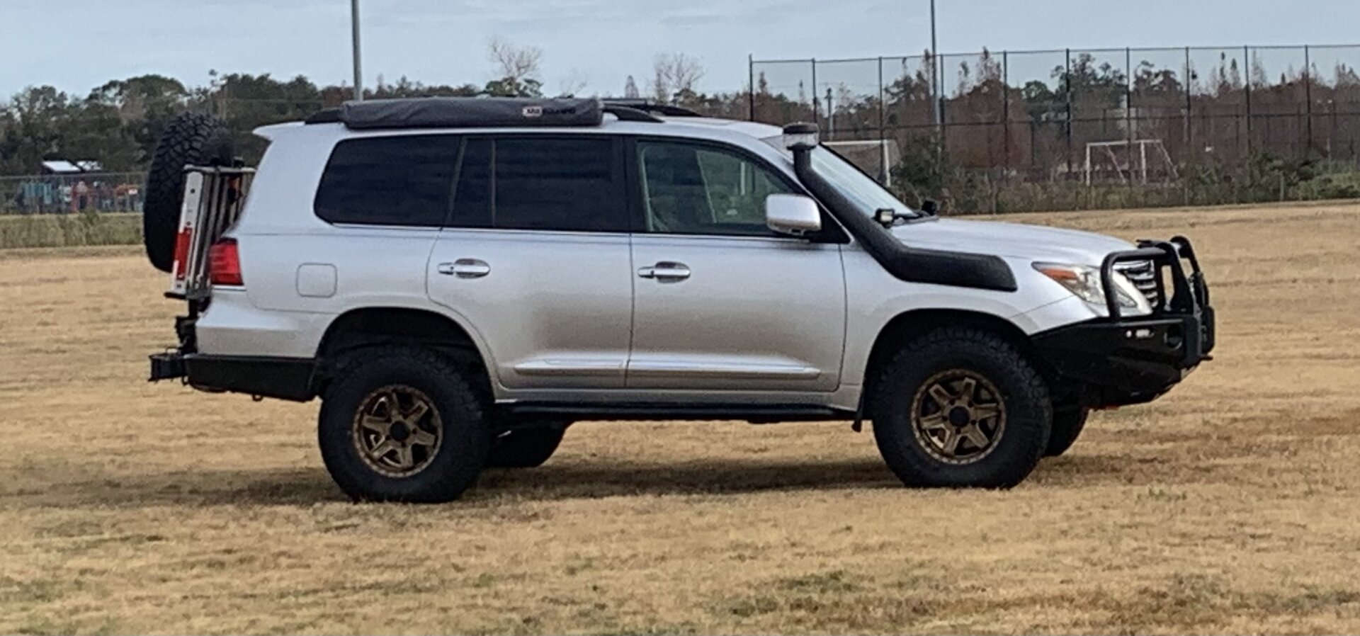

View attachment 3235099View attachment 3235100View attachment 3235101

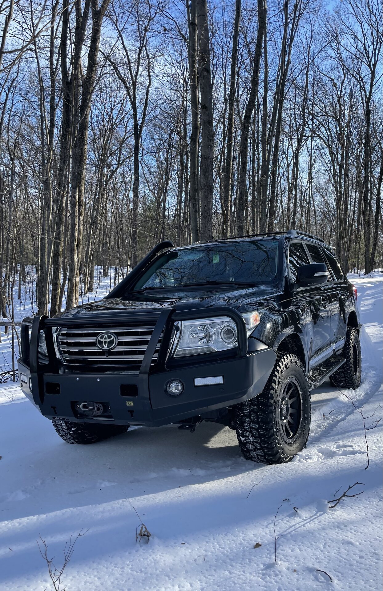

Thank you for the gorgeous pictures! I have also done a trip with NAC. We will have to coordinate on that as well. Did you change the suspension to accommodate this bar? If so, to what?
P.S. That bar looks mean. I think the deer are now actively avoiding you.
I am running King 2.5 with 600lb King front and OME 2721 rear springs. I ran them before the bumper, and (kind of surprisingly) didn't need to make any adjustments after I added it, although I did talk with the vendor (Ben at Filthy Motorsports) about it.

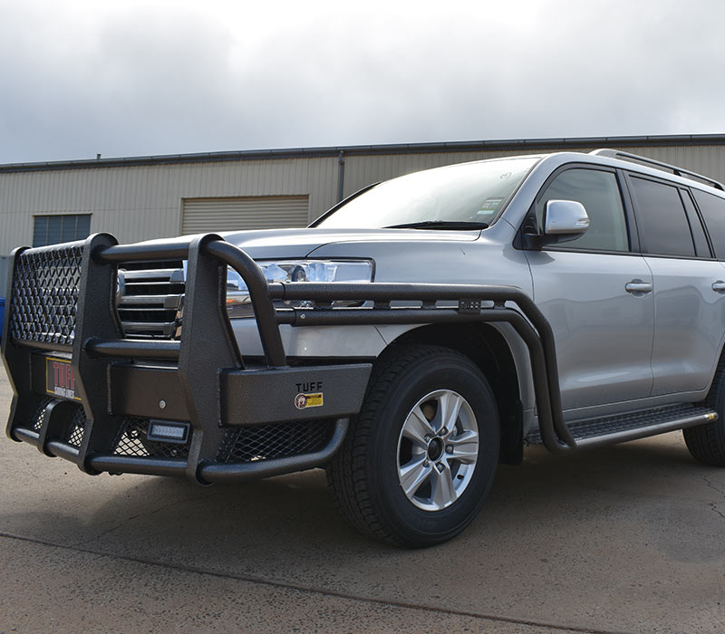

Here is a cool video I found on the crash testing done by TJM......https://youtu.be/i2foHYCS92w

It looks awesome from this angle. Can you please post a picture from the side?
