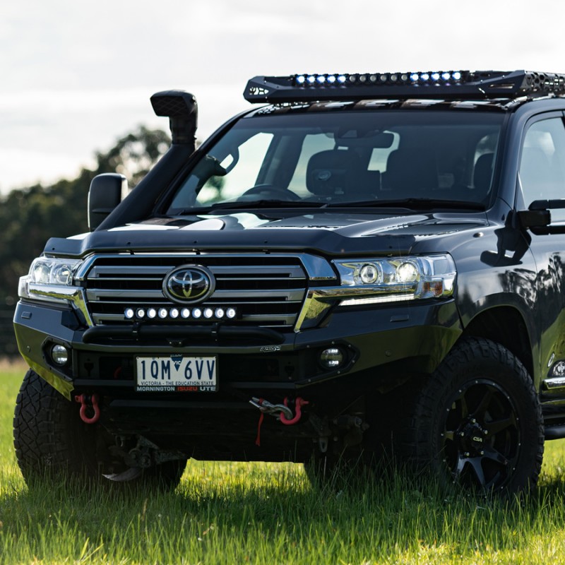

We can special order you the aluminum bumper from AUS, but keep in mind there is a 50% deposit and could take 2-4 months to receive pending on when the next container is being filled and arrival time.
Good to know. I wish that had been communicated to me when I was bumper shopping. I had an email exchange in August of 2022 and was told by Stephanie that it was not available. Definitely would have picked it up if it had been an option.

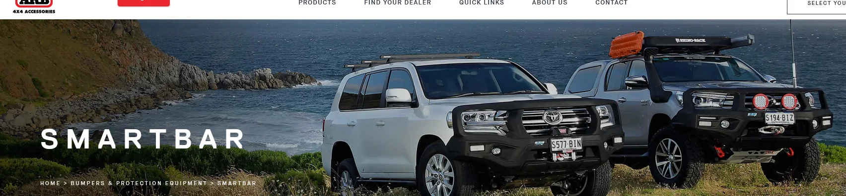

Interesting that the polymer ARB Smart Bar bull bar is supposedly “stronger” than steel.
No doubt its far lighter, but it would be great to see the series of tests used in the comparison.
I’ve an ARB Summit which is no doubt very protective against deer strikes, but less weight at equal/greater strength is an interesting value proposition—if indeed true.

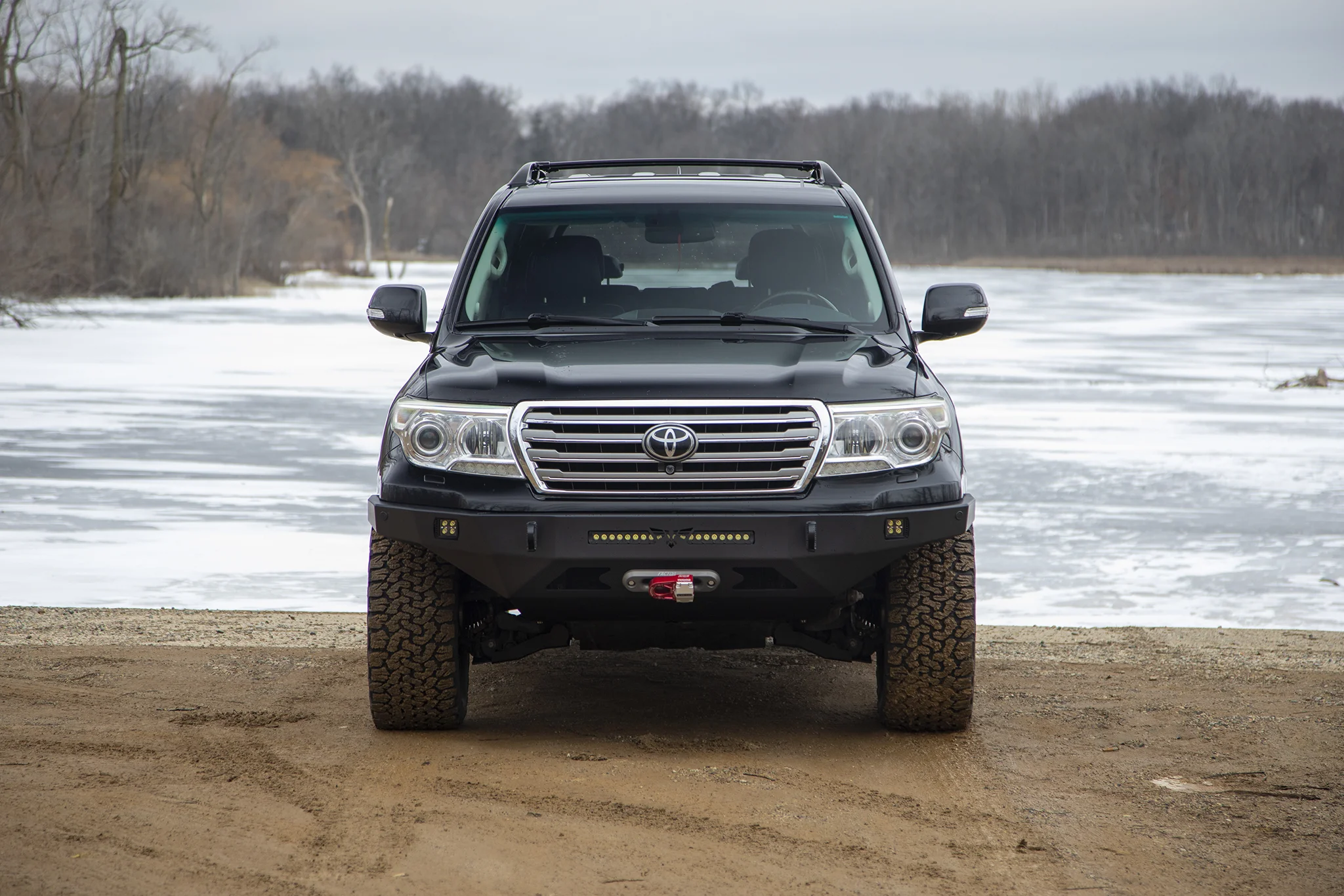

My local LC shop (ACC garage) recommended against the Victory 4x4. Said the ones they've seen have been thin with inconsistent welds compared to other offerings.
I ended up going with Dissent, but it's currently on backorder so I cannot speak to it's quality.
Which is a shame because I think their front bumper looks really nice on the 200 (in the bar-less variant). Sleek, does not stick out, clean, no exposed welds or bolts. Also can be had in aluminum for low weight (only 85lbs). The integrated logo cutout is little cheesy, however.
It seems form over function, though. The recovery points are stupid and dangerous to use given how the bumper is mounted. It mounts at least in place of the recovery points in addition to the weak frame horns. Given how the bracket is constructed it would not be easy to retrofit the clevis nut/stud solution ARB/TJM/Ironman all use.
Perhaps ok choice for a lightweight high clearance bumper, but mounting a winch to it seems sketchy.

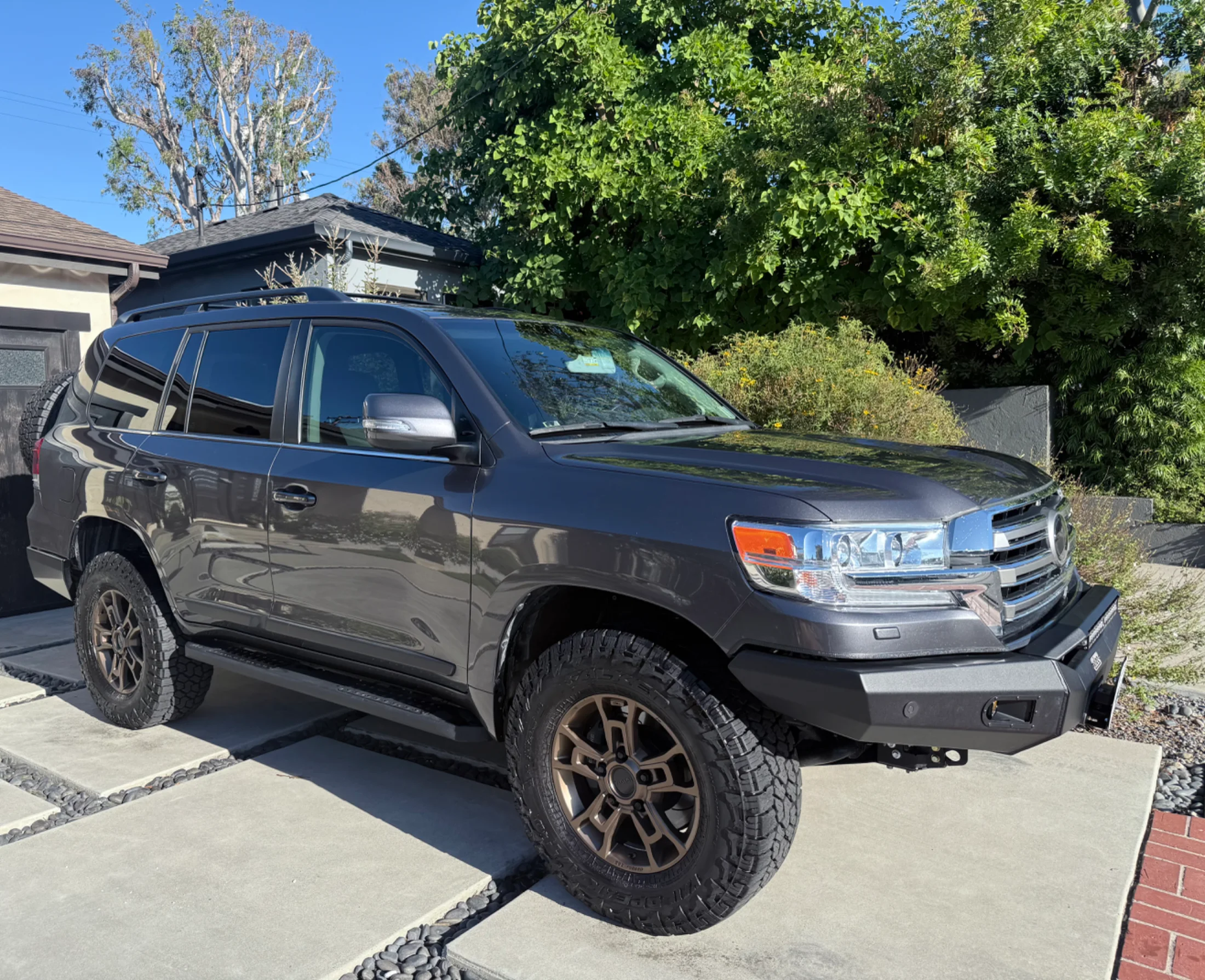

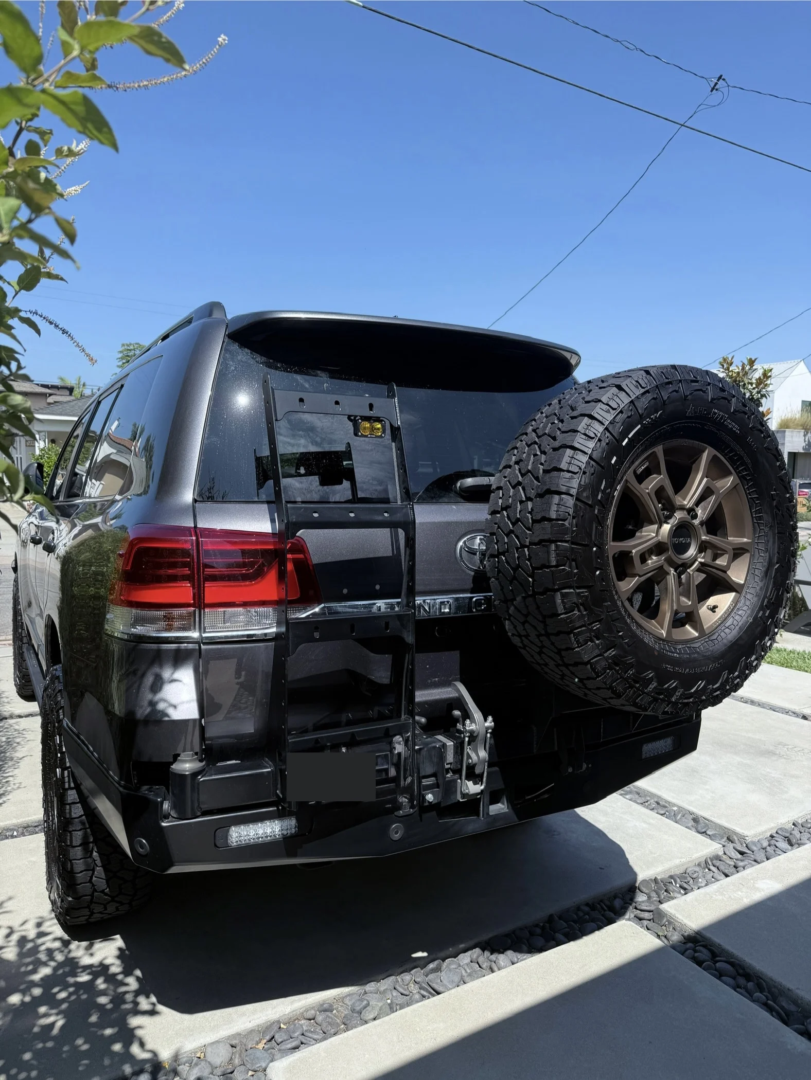

Recently got Slee’s front and rear on my 200. Love them - functionality does what I needed. As for the front end angular look, it’s growing on me.
My criteria was better clearance in the rear coming off obstacles, and clearance plus a winch up front. I wasn’t so worried about deer strikes, since I rarely came across any…
…until I started going places now that I have these bumpers, and I see deer everywhere. They seem to especially like feeding by the roadsides!!!
So, now, yeah - kinda wish I had gone the full bull bar route sometimes. At the same time, a healthy fear not ruining my front end or killing a deer on the road are maybe a good thing to keep my alert and slow down.
How's the clearance with TCC rear bumper? After COTR2 with a stock rear and a RW 35 KENDA pizza cutter in stock location I had no real trouble with climbing Poughkeepsie "wall" but did manage to crush my exhaust exit, nbd, and flatten/kill my trailer connection bracket and also scratch up the rear plastic bumper. My lift height is minimal in the rear as well with OME 2721x springs and fairly loaded out with ARB drawers/Fridge etc. I noticed others with aftermarket rear bumpers and more height had trouble making contact...
