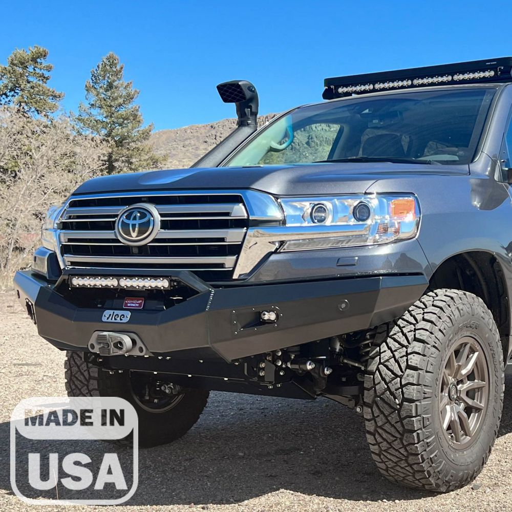

In the end, I chose ARB for the bumper. Almost everything else is Slee.

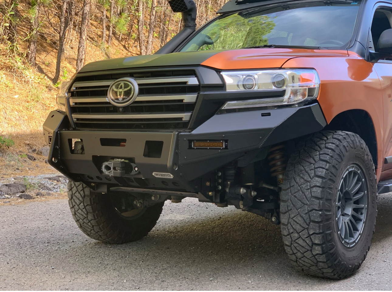

Personally I think I'd go with Dissent. Keep it light and keep it tight. I think it's easy to make the LC200 a heavy and bulky beast. As much as I appreciate the protection provided by a full Aussie bar you're adding quite a bit of additional weight. A full bar probably weighs 225lbs. The Dissent weighs 100lbs. I guess if you've gone full expedition with a rear bumper with swing outs, sliders, skids, drawers, RTT's then an additional 125lbs isn't a huge deal but if you prefer to keep things daily driver friendly then being weigh conscious will keep the vehicle happier. I been there, done that with my previous rigs and additional weight just adds complexity, problems, and will drive like a slug even with the 5.7L V8. I've been able to keep the weight mostly off on my current 200 and still enjoy the way it drives and performs as a DD.

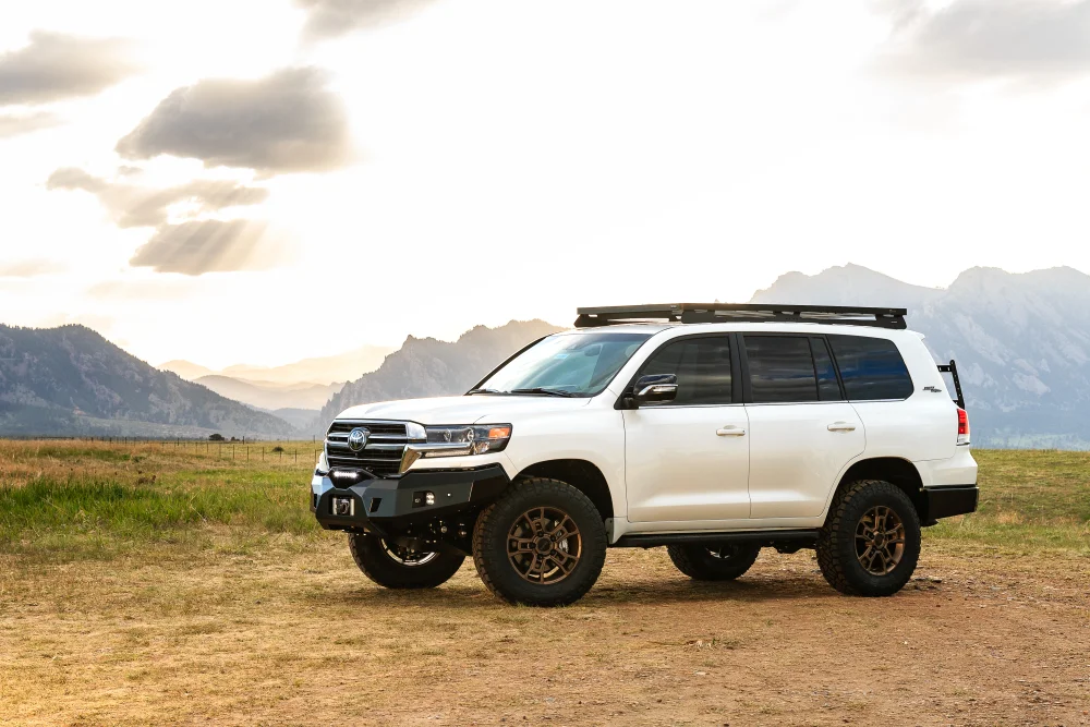

I’d be all over Slee’s Heritage bumper if they didn’t just do it as a one off. So much better looking than their production bumper. Other than that Dissent takes the cake.

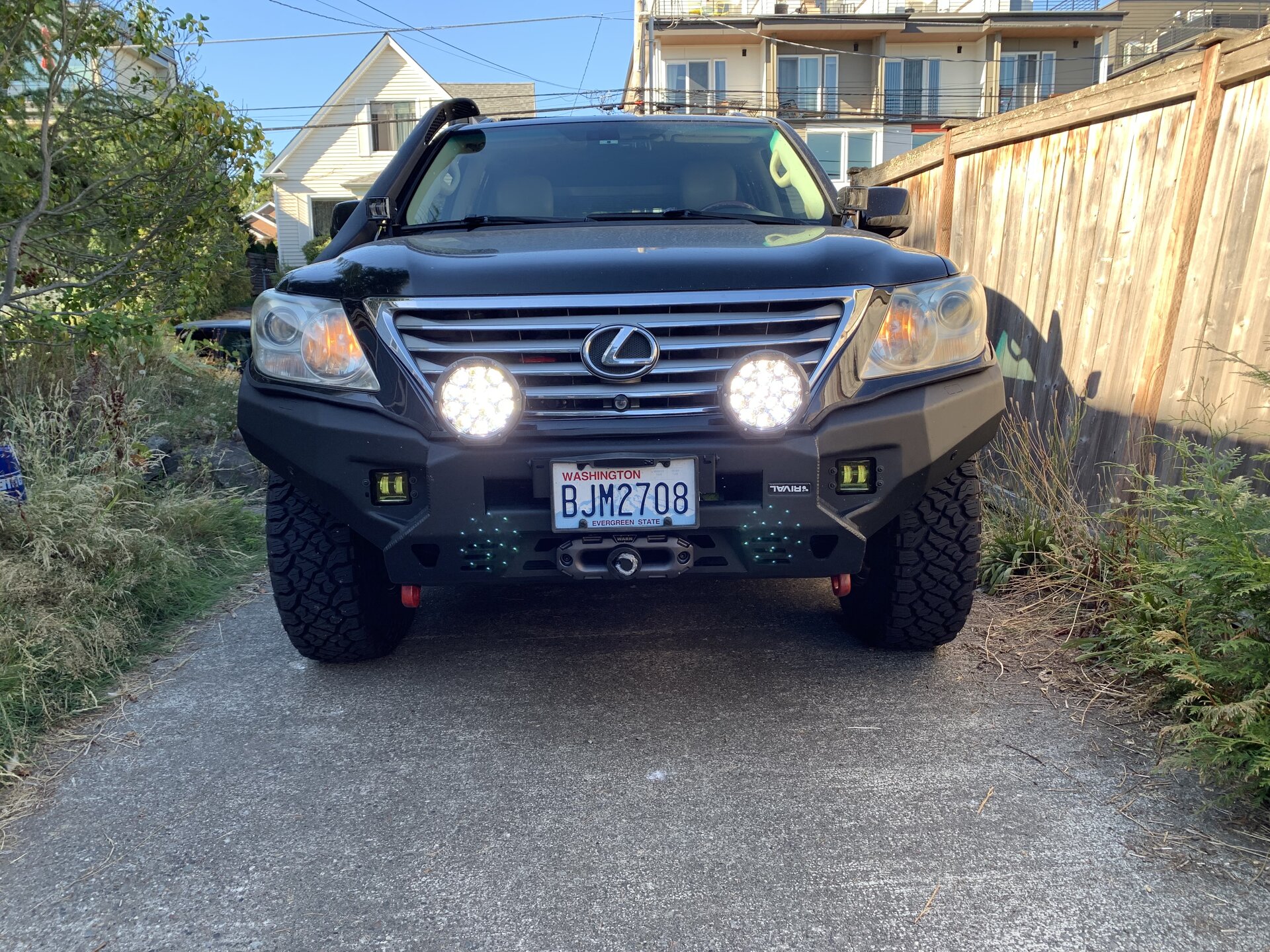

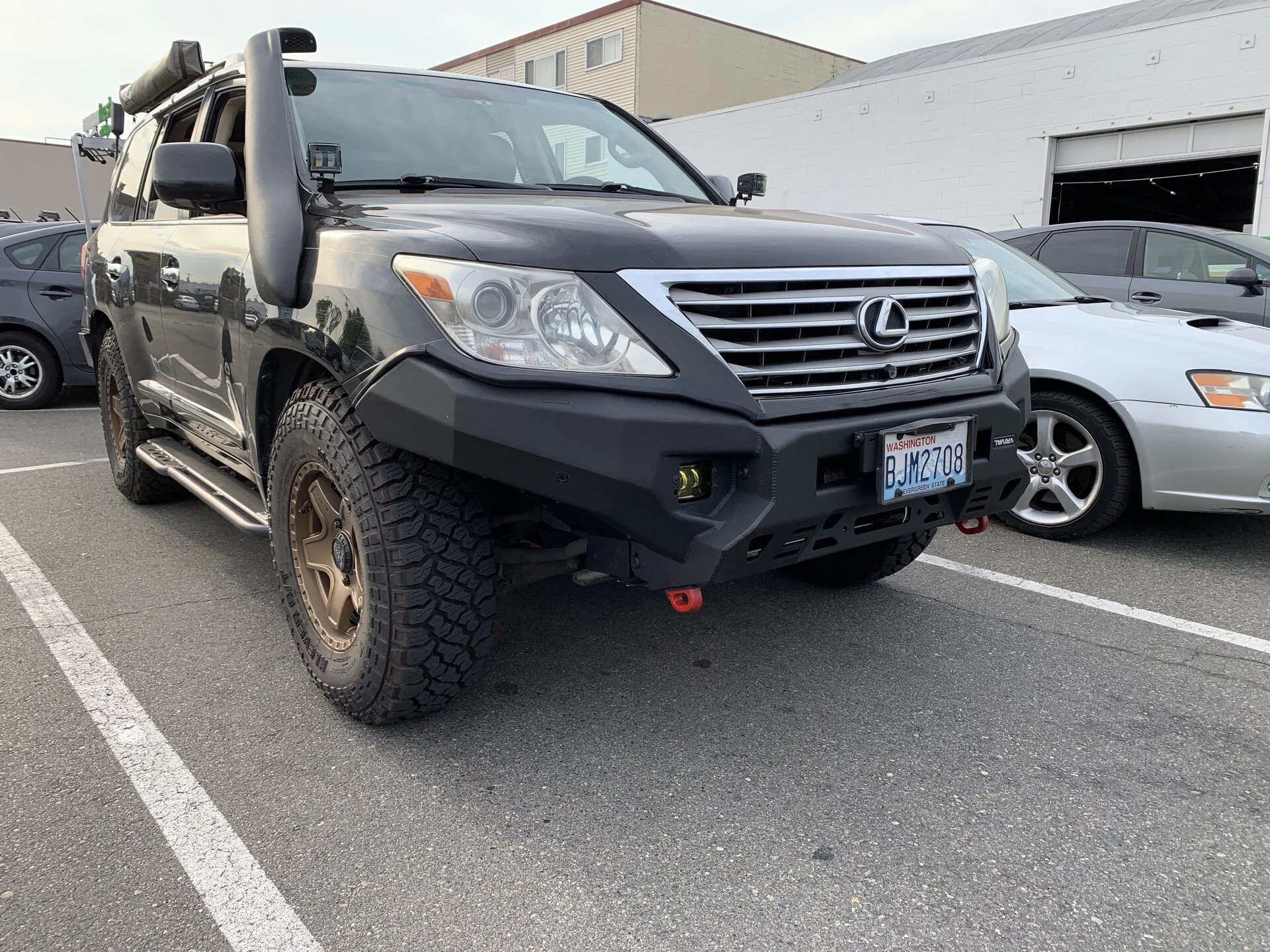

I've had the Rival for 18 months and it still looks new. I took off 40 lbs of stuff, so the bumper net was around 70 lb, not counting the winch (60 more lb). Total add to the front around 130lb. Using these spring rubbers to increase the spring rate up front, as we haven't been able to find stiffer springs for the LX yet.

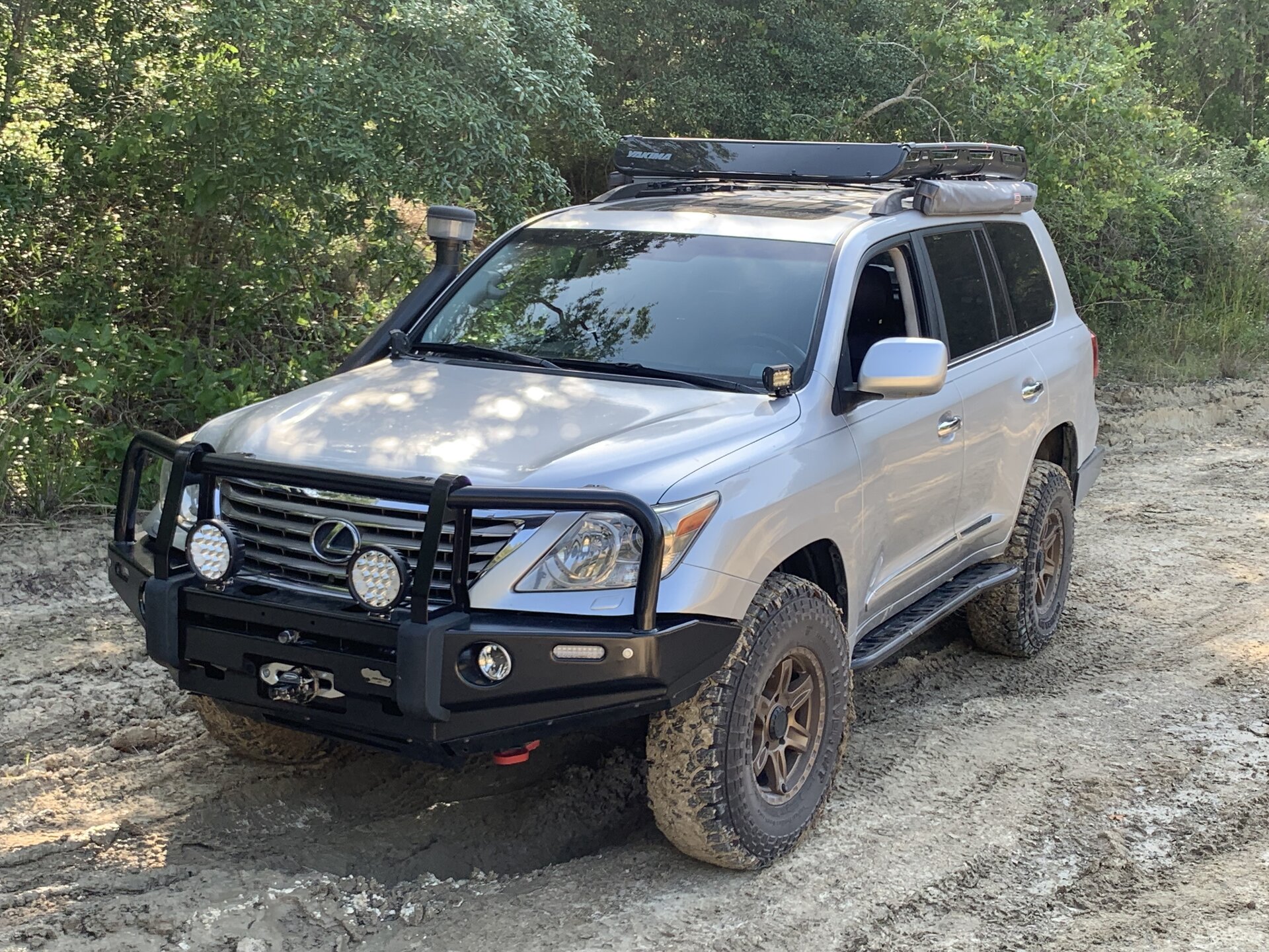

The Dissent is a great option for keeping weight down, which can add up quickly on a built rig, so I see the value. I am in deer and moose country, with constant backcountry drives, so I wanted a full bull bar. My Ironman bars continue down into the bumper (seems older ones may not have). I trust it against Deer, and hopefully the bar would keep a moose out of my windshield (no guarantee with a big one). Moose scare the crap out of me. Their dark color makes them hard to see at night, and they are just the right height to slam through your windshield.
The Dissent is an awesome light design but it appears like the bull bar bolts on with little reinforcement, I'm sure it does a decent job for the weight, but not sure I'd trust it against a big animal.

And for what it’s worth. The original Slee heritage bumper was just too complicated of a design to ever be practical for production, I do still like it though. Some subtle things I’d change about it’s styling, but still high on my list.
