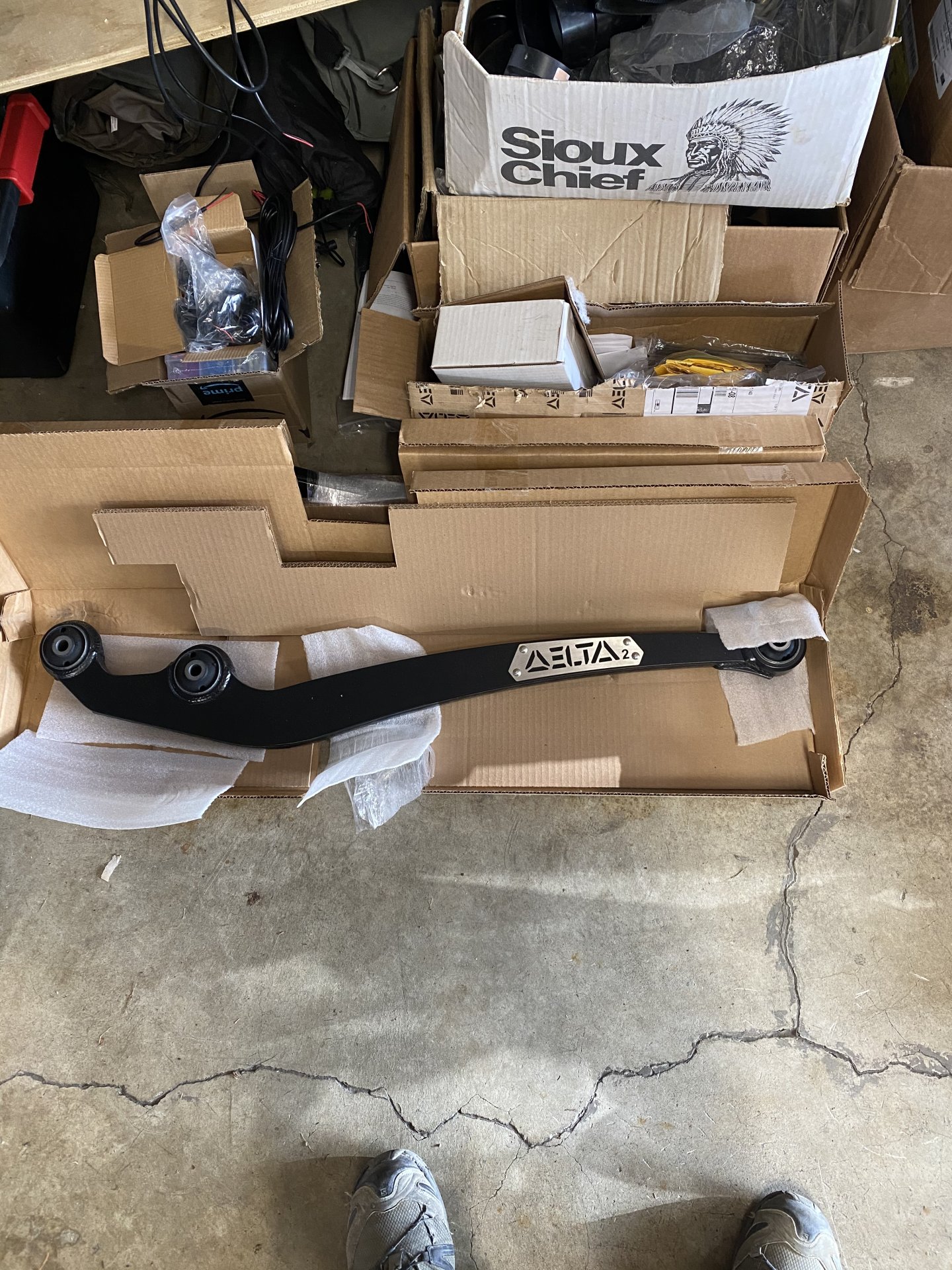

I have a 2.5 lift and needed castor correction. I waited until lift was installed new tires and armor done than had a alignment and got the delta arms. Dave over at delta is great and very knowledgeable on this subject. Plates work and so do bushings.

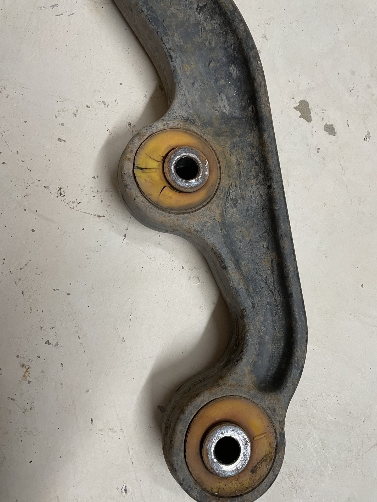

My caster bushings lasted about 2 years...
3ish in icon lift.
Like @cartsaid may depend on use on how ling they last. Its definitely a bushing that takes a good amount of abuse. As loads are not just rotational.
Here are my OME 2.5* bushings after 10 years and 110K miles. They were most likely due for a change several miles ago?
