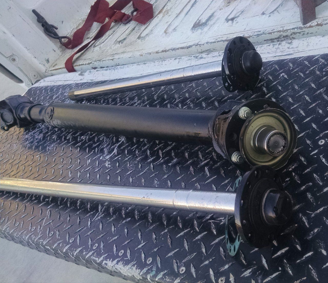

Picture below shows a new custom built .250” wall drive shaft with Dana/Spicer slip yoke and joints after a 20 mile maiden voyage test drive with the new engine, if you look at the drive shaft you’ll notice the ends are about 20° out of sync. Yes I sheared the pinion splines at the same time.

Super hardcore bro. So what about the u-joints failed? It looks like you're claiming the splines twisted (not sure those are spicer parts) and then you sheared the toyota pinion shaft? But the u-joints are still fine?

Reading comprehension?
Yes Dana/Spicer slip yoke and U-joints, no nothing from the drive shaft was usable, everything was new and had 28 miles on them at the time of this photo.

No, what he's stating is that
1) You claimed the U-Joints failed.
A) The yoke failed, not the U-joints. It appears it failed due to not being properly in-phase or aligned.
2) Did your U-Joints fail AS A RESULT of the other failure?
3) I would chalk up what I see there as a misapplication or misinstallation, not a failure of U-joints.

I just think the toyota fanboyism for u joints is ridiculous. Yes - OEM toyota joints are great when you need to replace an OEM driveshaft u-joint. I would not say that toyota u joints > *.spicer. That's just dumb. Everyone believes the folklore they heard on pirate4x4 about how "Jess" from high angle driveline says toyota u joints are stronger than 1350s or something but with no science or rationale.

Bingo - I mean, you shear off the pinion and twist the driveshaft splines and claim "and, you know, I couldn't re-use the u-joints." I don't think you can just say that the u-joints were garbage.
