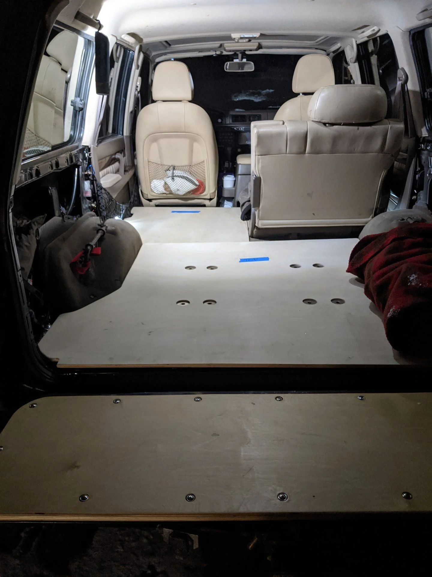

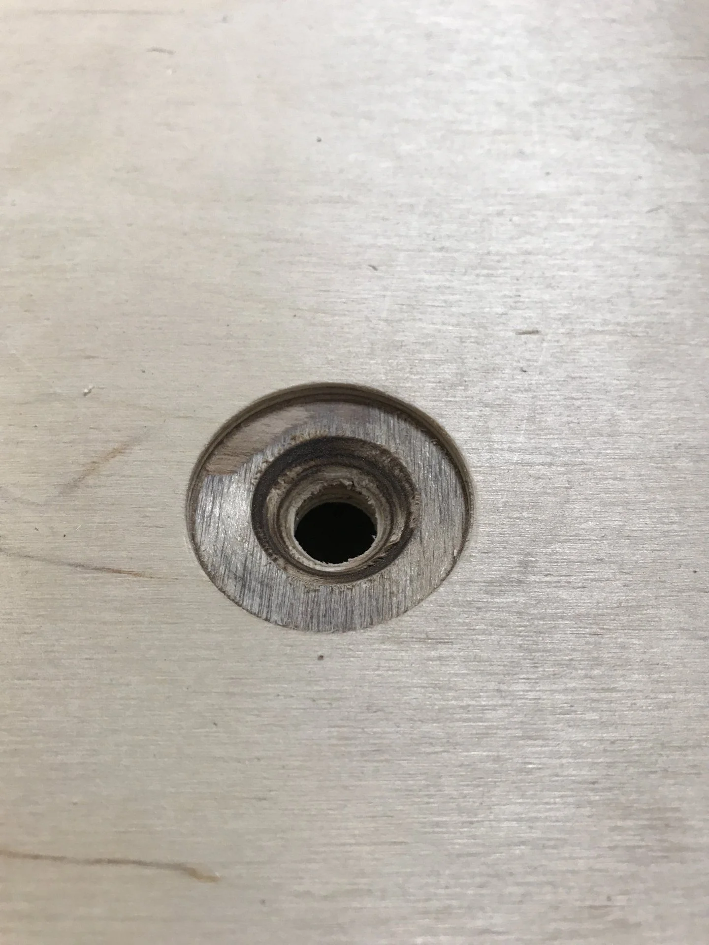

I'm working on my own rear storage system. I've countersunk washers like @619TOY but I can not find bolts that have a recessed head. The bolt is M10x1.25 and I've checked McMaster and Amazon but all I can find is either a hex head or allen head. Any help locating the bolts?

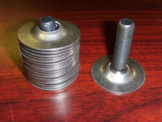

Here's one of the washers I made/modified as well as a couple of the supports for the cargo tie downs:

I'm using the seat attachment points and they're DEFINITELY 1.25 pitch, unfortunately. Yeah, otherwise I would have saved myself the headache and used SAE bolts. I can find hex head bolts in my specs, just not anything low profile. :bang:
These bolts were pretty much unobtanium, so I set up a group buy for them years ago. I may be able to source them, but it wouldn't be cheap and there would probably be minimums of 50-100 bolts.

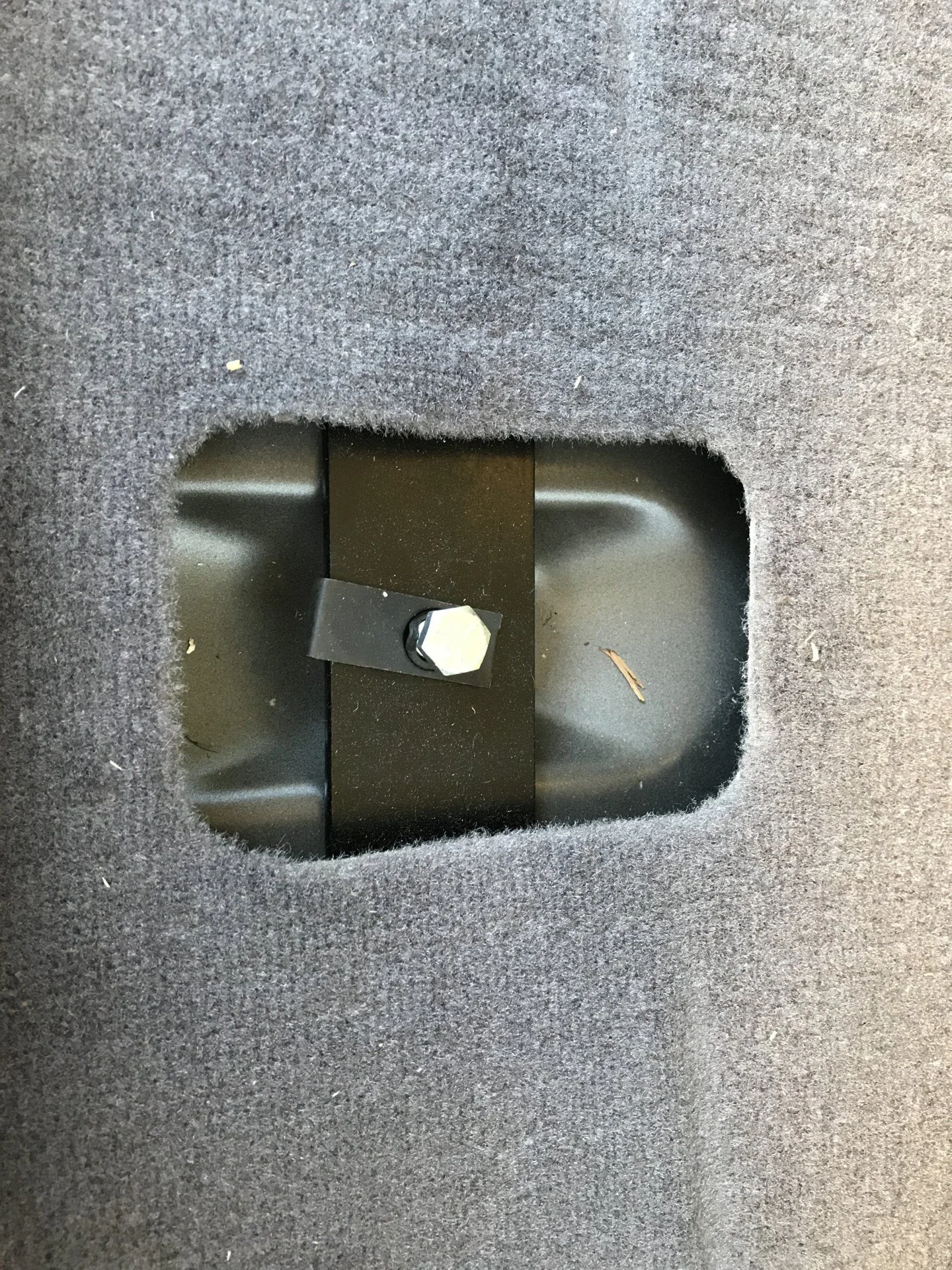

Here's an alternate approach to the same problem. This is in our 200. You can use whatever pitch bolt you need. I think I did 3/8" or 7/16":
