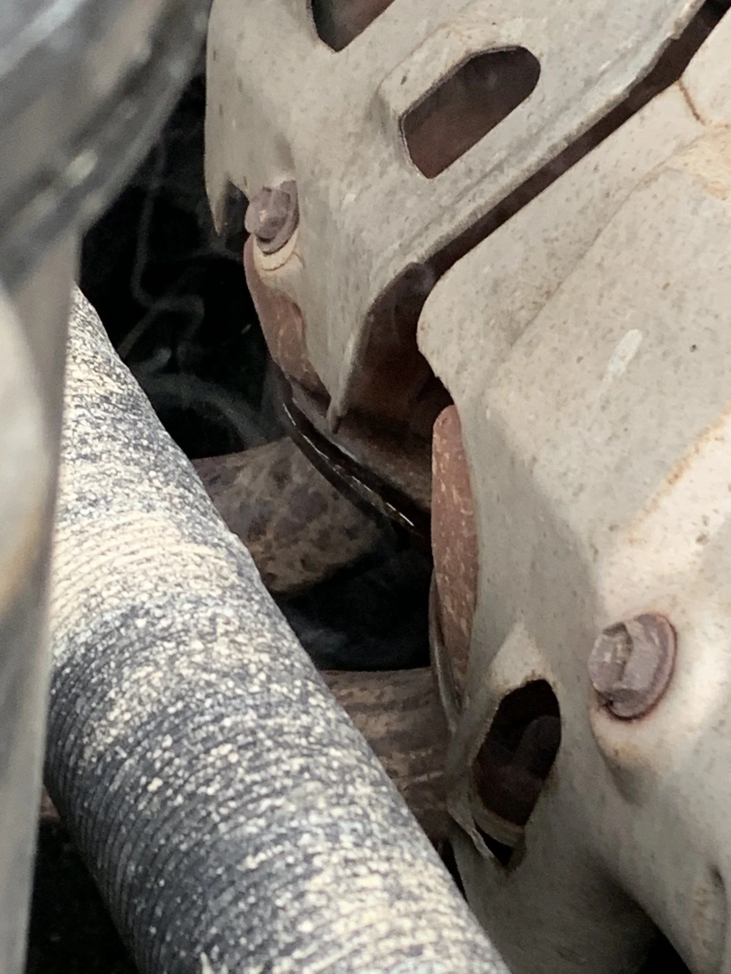

I picked up a NTM ‘95 FZJ80 last week and was driving fine, put around 250 miles on it. Jumped in yesterday morning for the run to Home Despot, and it starts missing, smokin’ running like hell. This morning I cranked it up and found steam, possibly water coming out of the rear most exhaust flange.
