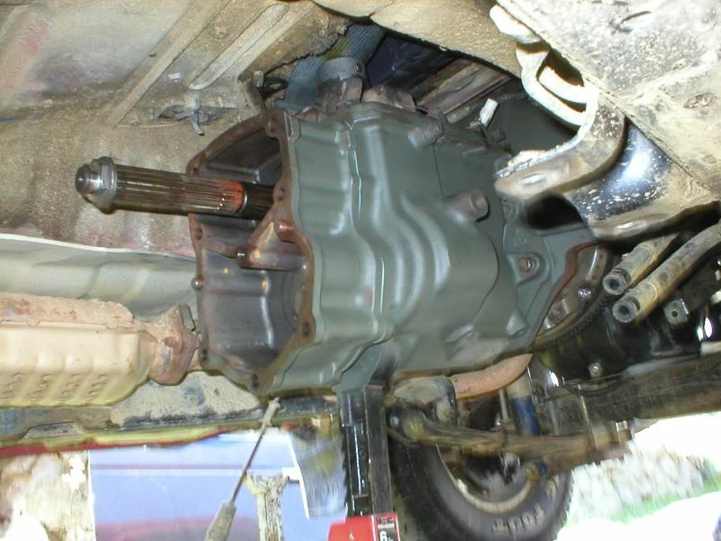

and this time cause the 312,000 mile old tcase is cabbage:crybaby:an he rescued me with a next day tcase kit. Guess I'll hafta do it now. The transmission went in with just me and a floor jack(not recommended, but I'd do it again without a second thought if I had to.) sometimes being in the boonies is not a good thing-everything takes longer. yes a donor 60 would have been nice:meh:

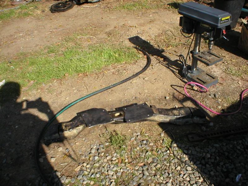

trans crossmember is in. will post pics of the build later. Now I have to find a gear to replace my idler or maybe have the old gear bored and sleeved???

above shows a crappy shot of the a440 crossmember and some plates i cut. next is a better(very slightly)shot of the cuts i made in the crossmember. i then drilled out the spot welds and seperated the hat from the back of the crossmember and relieved it of the nice formed channel for use as gussets on my new crossmember mounting plates. below is the quazi mounted crossmember. i used angle to gusset the inside cause it didn't get in the way of the lines running down the passenger inside frame rail- and it was easy and out a sight:hillbilly: still hafta re weld the modified exhaust bracket to my drivers side outside gusset-and paint:doh: I did not want to cut out any more of the a440 xmember cause I'm gunna use some of it(the inside mounting ears and whatnot) to mount a transfer skidplate of some type some day just to make use of the existing mounting tabs:hillbilly:

Oh- thats an unadulterated 86 fj60 h42 crossmember
the top of the outside gussets are open, so I under cut the ears and ran a drill thru the corner of the channels against the framerail in order to keep it open-after seeing what those cats in stockton build, angle on the veiw-able side was not going to be an option:hillbilly:

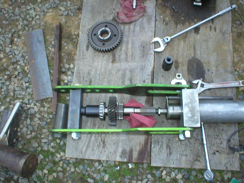

here is what an electrician does for an output shaft bearing press...
