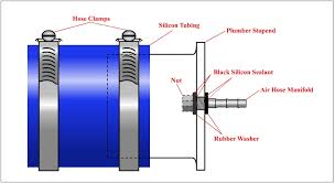

You should still make an adaptor for your turbo and pressurize your intake and check for leaks. I used this little thing that looked like rope that is designed to smolder so you can find leaks by outets and stuff in your house, you just watch for where the smoke is disrupted. Its way way easier than listening. You can see leaks you cant even feel with your fingers. I can almost guarantee your throttle plate housing is leaking. I went to great lengths to seal mine and was only partially successful. It leaks along the pivot pin where it enters the housing.
Those look like better numbers. Have fun with your turbo. Dont give into the temptation and boost the **** out of your 2h, It will not take much for long. The pistons are the weak link. Running it intentionally cool like that might actually help witht he ring land problem. Remove your blow off valve as it is not necessary unlaes you drive like a ricer dork and beat the **** out of your engine. For a long time I was going to put one on but never had and issues with surge from the throttle plate.
