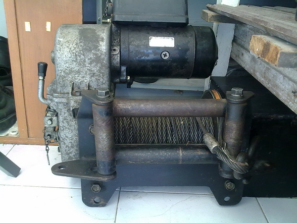

I tried to search on the forum but couldnt find much info. How should i fabricate the M8274 winch bracket/cradle mounts (the shop doesn't supply them). You guys have any dimension for them? How thick should the steel be? Also is it ok if i just make an "L" if viewed from the side or i better make a "Triangle" or gusset them for strength.
As for the bottom mounting for the winch bracket/cradle would it be ok if i bolt them using the existing Mounting Bolt Pattern: 10.0" x 4.5" (254mm x 114.3mm).

My truck without the bull bar and a better view of my existing winch mounting plate. You think the M8274 should fit over it or i might still need to extend it out further?

Anyway this is the pics i posted of the truck without the bullbar but only with the winch base mount which was built to fit a lowmount.
My only concern if i can use this as a base for a highmount or do i need to extend it to accommodate the high mount.

Thanks for the advise. will get someone to fabricate a simple "L" plate if viewed from the side for the M8274.
However would an L plate be fine or is it necessary/must if its gusseted with a "Triangle" if view from the side.
Or just make a "Box" so that the M8274 sits inside it?
My only concern is that if i mount the M8274 on top of my current winch base plate, a portion of the Highmount will stick out/ stick over the base plate. Probably a good 2.5 inches out of it on my guestimate.
Would it be OK in terms of strength? Also concern if part of the winch sticks out would expose, make the winch vulnerable to impacts.
I guess the best way to describe is looking at pictures.
Sorry it's a Landy pic but if i was to mount the high mount on my rocky the front bit will expose over the winch bar plate like the above.
Would its vulnerability be a big concern or as long the "L" winch plate is really sturdy it should be fine? Sorry if it's a lame question.

the winch plate will double as a bush guard, i have no issues with mine at all. gusset the L then gusset from the bottom of the L down to the bottom of your existing winch plate.
