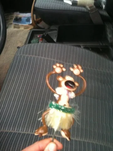

What is this magnet toy?
I was cleaning up some and found this toy?? in the cruiser.. I have no idea what or who it is suppose to depict. But, I like the little fella and think it's a naming sign. So, Blue #2 is now BLUE MARLEY.
If anyone knows who this character is let me know.
Oh and this is exactly the way I found him. HA!
