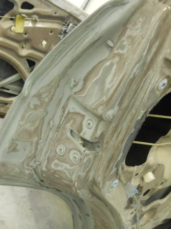

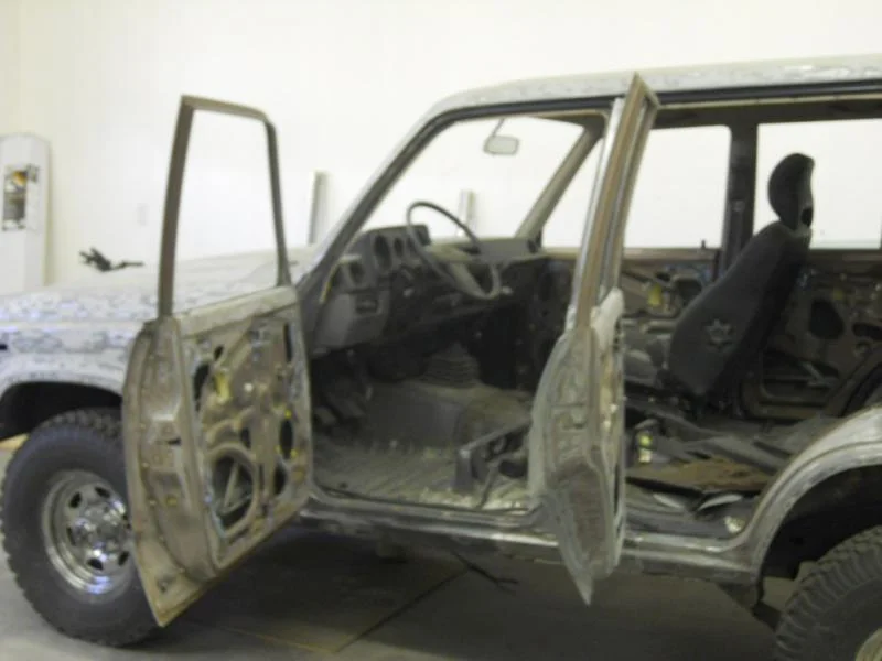

Then got to the scuffing and sanding of the inner door areas and jambs.
It was a fun morning.
J
Here's a few pics of the scuffed and sanded doors etc....

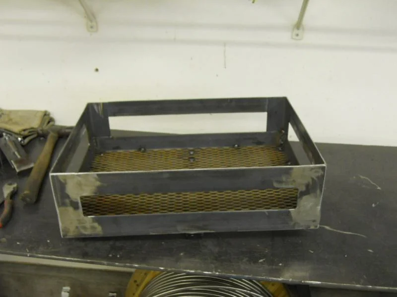

Plan to finish welding out and smoothing the gas can/cooler rack tomorrow.

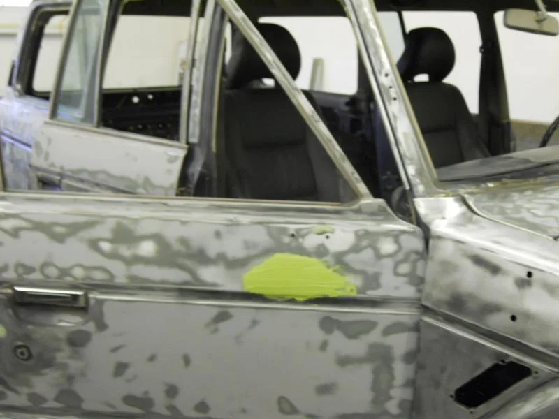

Try and get some block sanding of the body started too.

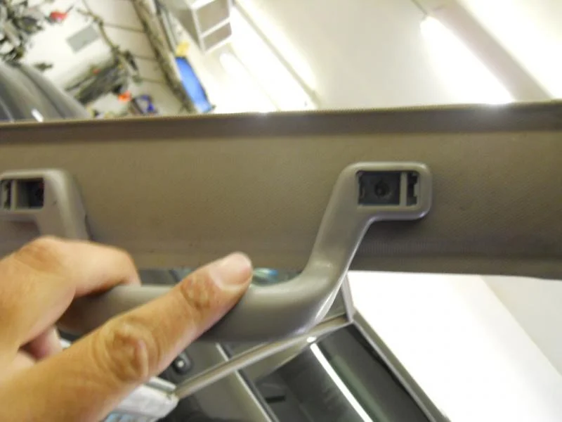

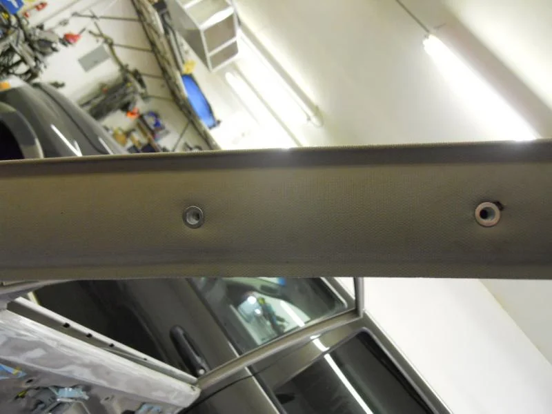

A pillar grab handles off 80 series
Installed the A-pillar grab handles this morning I got from arcteryx.. Thanks Jason. These are off an 80. Easy upgrade with a HF Rivnut gun.
Now on to a few spots I need to address on the body filler.. Low spots were found. :rolleyes:
J
J

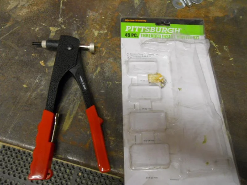

Just what I needed to see! I have some extra GHs and I wasn't sure how I was going to fasten them! Home much was that gun? The wife is having a hard time getting in and out lol.
Edit: I am not seeing that gun on HF website
Edit again: ah I think I see it, then realized I have one, thought it only did rivets. Where do you buy the threaded inserts for it?
Amazing work as usually btw
Rivnut Gun
Snow, I think I paid $10 for it and it came with the nuts.. Here's a pic of the packaging.. I used the 1/4" x 20 rivnuts and new bolts from the hardware store to match the rivnut thread. The GH's are pretty darn solid. I'm a big fella and they don't move much when I pull on them.
Looks like Pittburgh item #1210.
