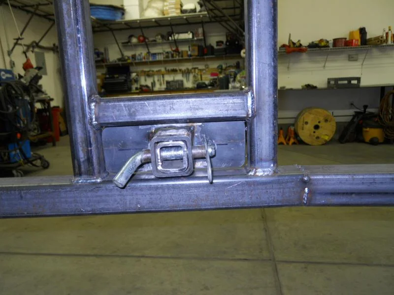

Really enjoying your thread reevesci..! I'm busy configuring the rear swing arms for my rear bumper at the moment and think your set-up is really nice - is the reciever below the bottom rung of your ladder for a jerry can carrier? I like the way that you have the flexibility of not needing to have the carrier attached at all times..
Trock, Yes it will hold 3-5 gallon military jerry cans or my 30 qt cooler. I made it just like a trailer hitch/receiver connection so it can be used whenever I wish. I'll keep it in the shop when it's not in use and simply put it on when we go on a trip/run.
Thanks for looking Trock..
J

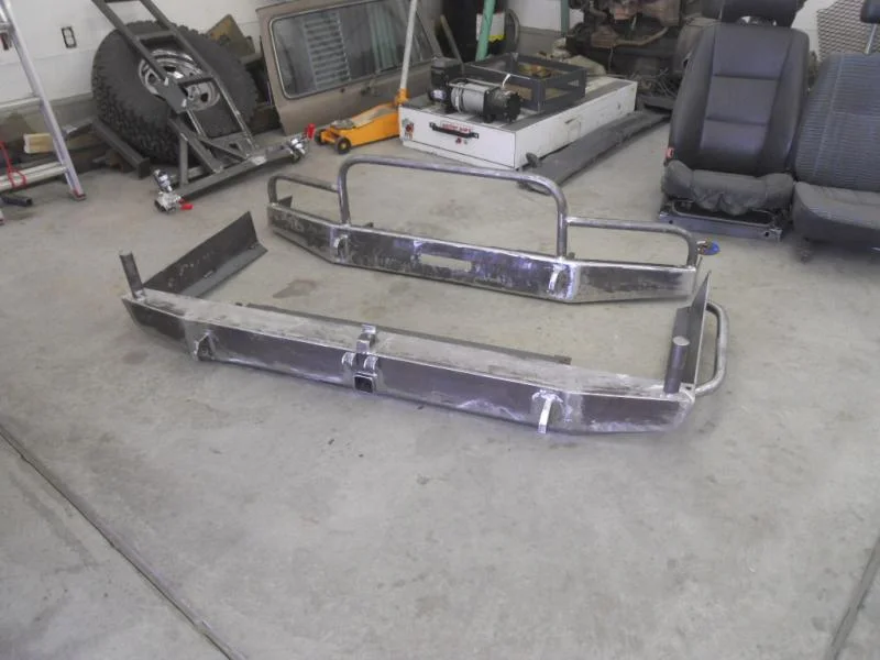

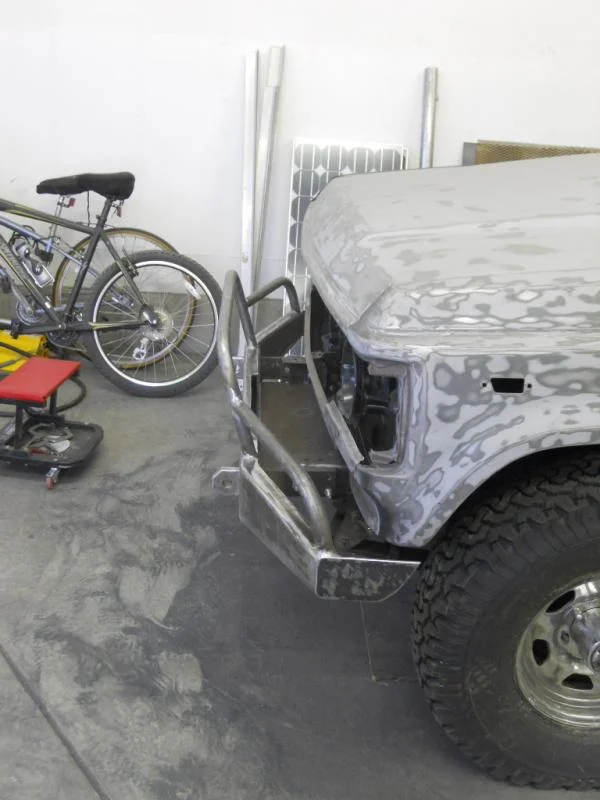

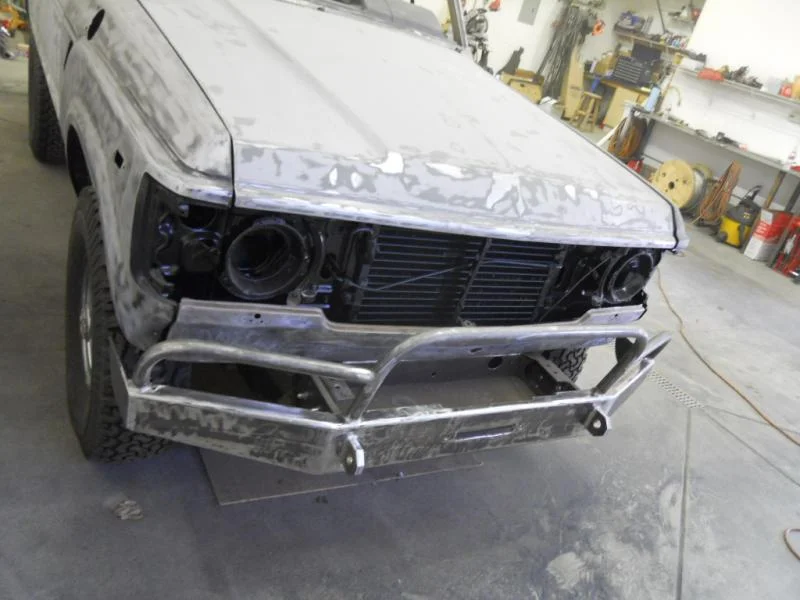

Spent the morning welding out and smoothing the front bumper.. So, now all my fabrication projects are complete less paint/powder coat...:crybaby:
I'm gonna have to find another cruiser to fab things for... :rolleyes:... Wish the :princess: was willing for me to start playing with our FZJ80..
BUT, the trailer build will be starting soon enough I suppose..:grinpimp:

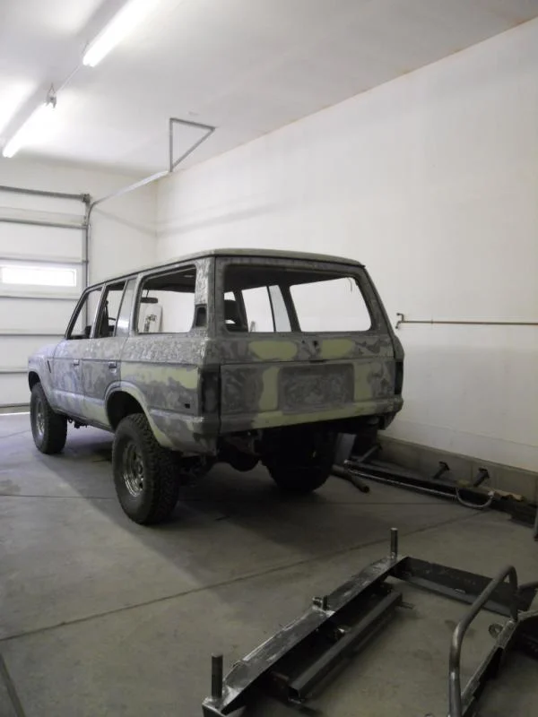

Blue Marley is de-BLINGED, all the fab is off. Now I can get back to the final sanding, primer, and paint.
I think I have all of the body filler work done, but I will go over it after the 320 grit block sanding one more time to be sure.
Well here he sits as of this afternoon.
J
J- those bumpers look totally ready to ship to me!! :grinpimp:

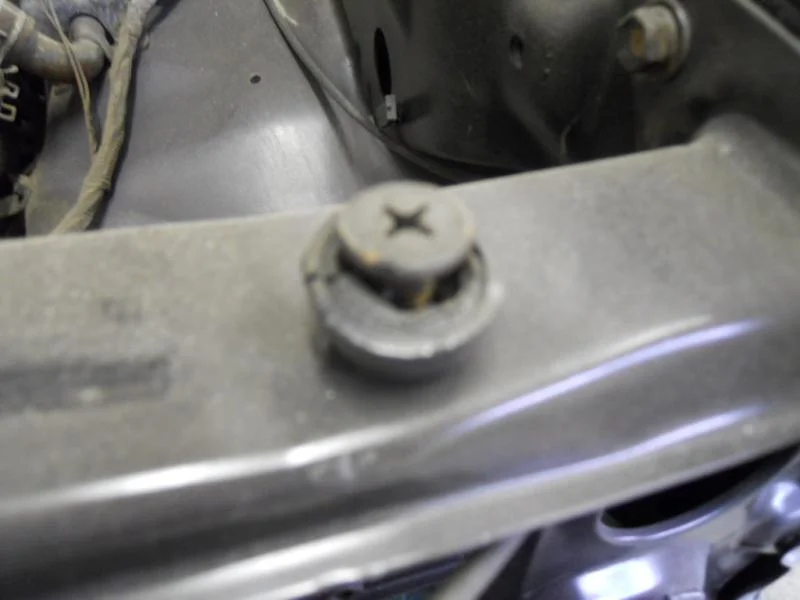

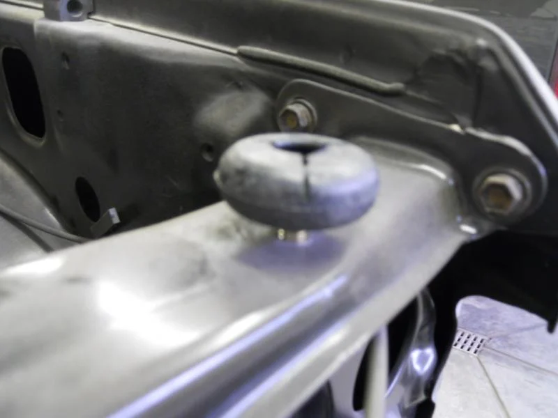

Hood bumper bolts
I haven't done much today since I been home, (except for posting incessantly for some reason). BUT, I did receive my hood bumper bolts from Cruiser Corps. Thanks Mike.
The old ones were trash and a PITA to get off due to the rust.
Here ya go. It's not much but, it's progress I suppose ;).
These are a nice/sturdy/quality replacement and under $10. I highly recommend.
Enjoy
