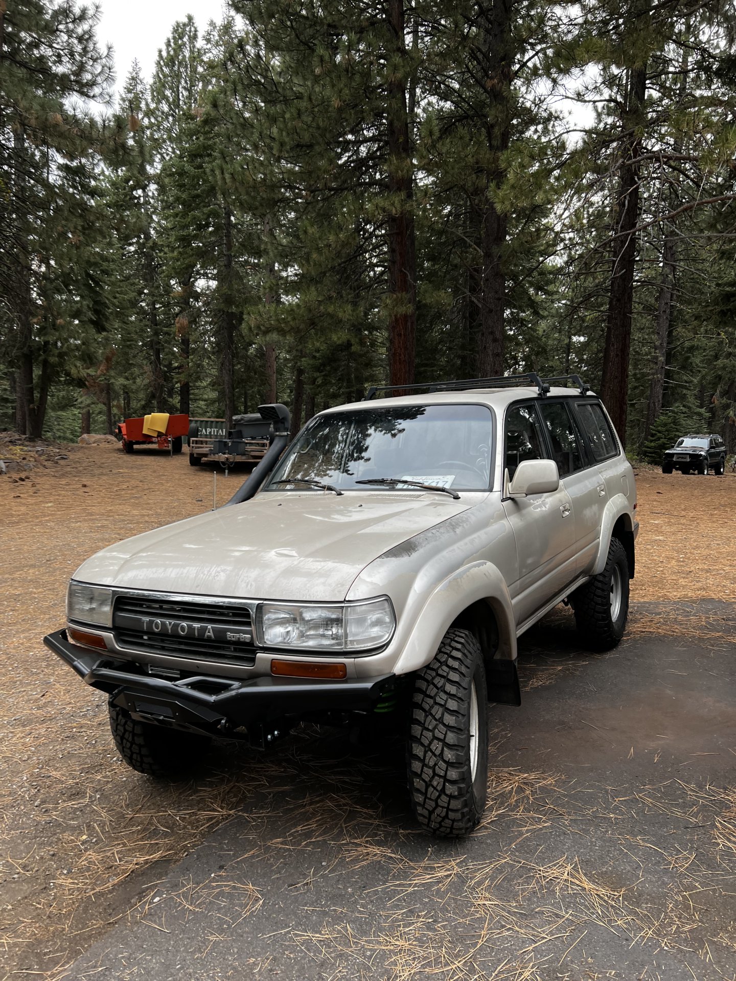

Another 1HZ DIY turbo conversion.... ALL DIY not a kit...

This is a new build. 1HZ in an 80.
