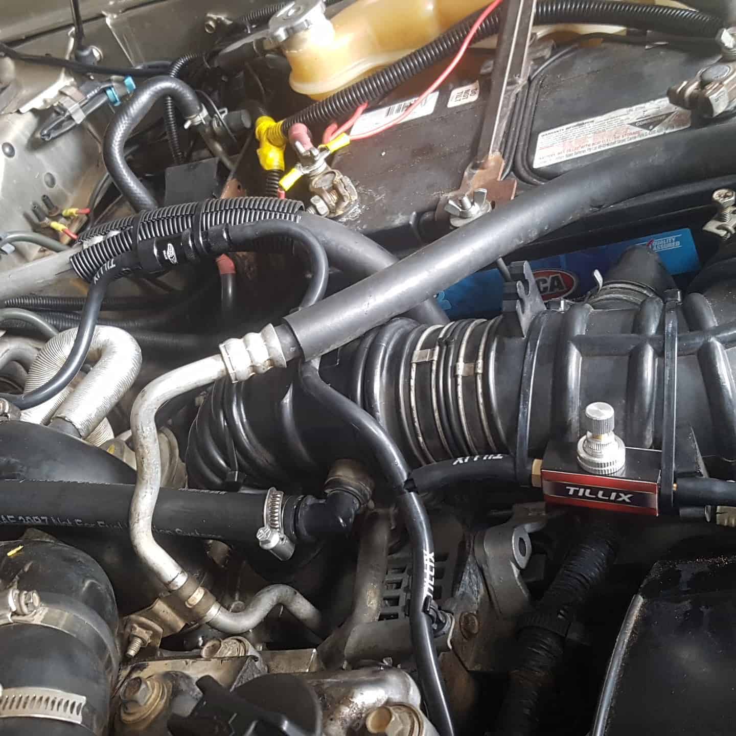

Is is possible to remove the EGR on a 1HD-FTE or disable it through the ECU ? ..
It is probably doable... I don't have any experience with 1HD-FTE. My engine is 1HZ and it has no ECU, so getting rid of EGR is an easy task.... mine actually came without EGR from the factory.
a "special" gasket with no through hole will do the job on the egr
This is exactly what I did on my Ram EcoDiesel while it was in Canada (I did have to load a new tune in the ECU). In some areas in Canada and I think in the US you have yearly emission testing and your have to keep your emission equipment on for visual inspection. Now I live in the country where my Ram EcoDiesel will pass local emission test without EGR DPF SCR at all. So all my emission equipment received new "special" gasket call garbage bin :). Actually I just passed emission test on my Land Cruiser after turbo mode, no problem at all.
