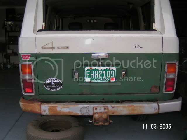

I dug through my pictures from that build....did not find one of it before, but it was originally orange, no black underneath, and had been on the truck since the mid eighties. When we sandblasted the body, there were no mystery holes, so location should be correct for a 78.
I had already taken the emblems off when I thought to snap some before pics. This one is from day one, I think...
And a little better shot of the finished....does look sharp in orange....with the blue....but, I am a Denver Broncos fan :p
