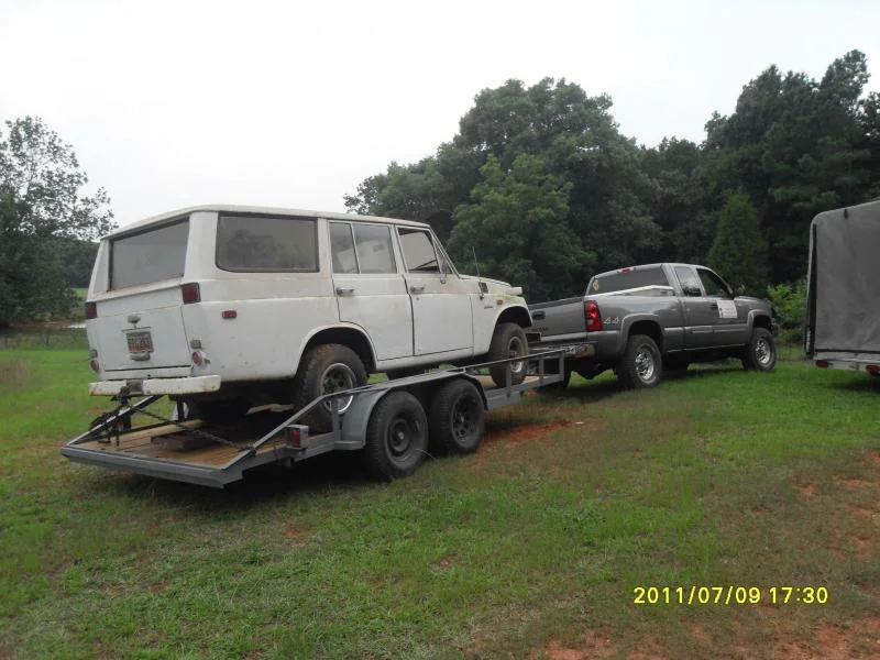

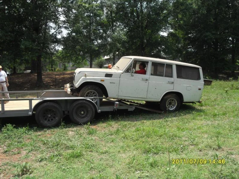

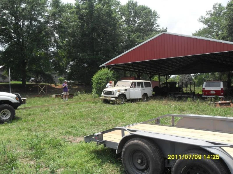

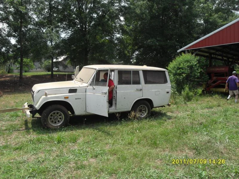

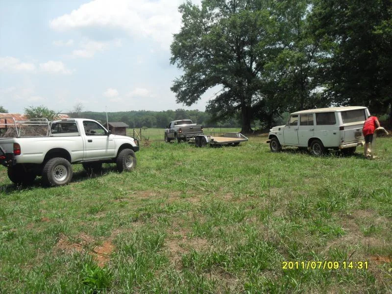

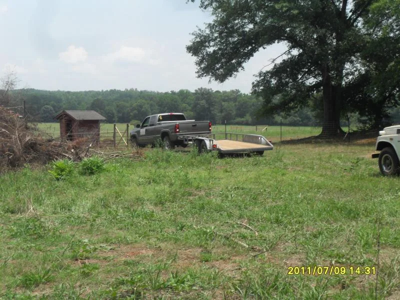

So we were finally able to coordinate schedules and go pick up the Pig yesterday. This will be the beginning of my personal build thread, starting with carting her home. Yesterday we loaded her up on a friend's trailer, and I will be taking delivery of it some time later today/tonight. For now, enjoy the pics of pulling her (somewhat begrudgingly) out of her 4 year long pen. Hope she likes her new home!

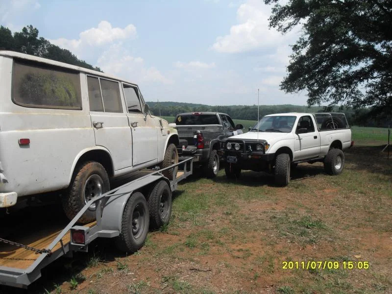

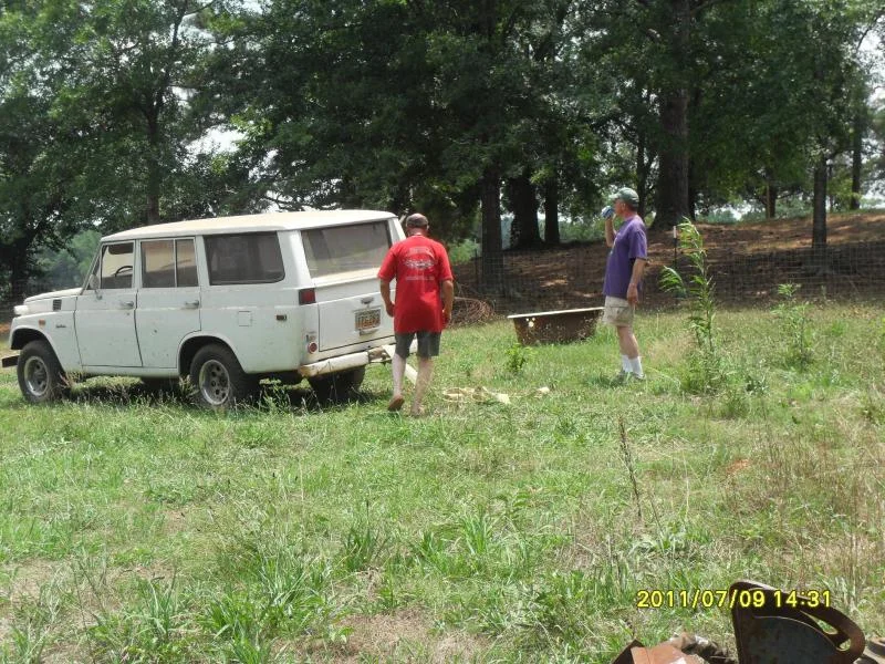

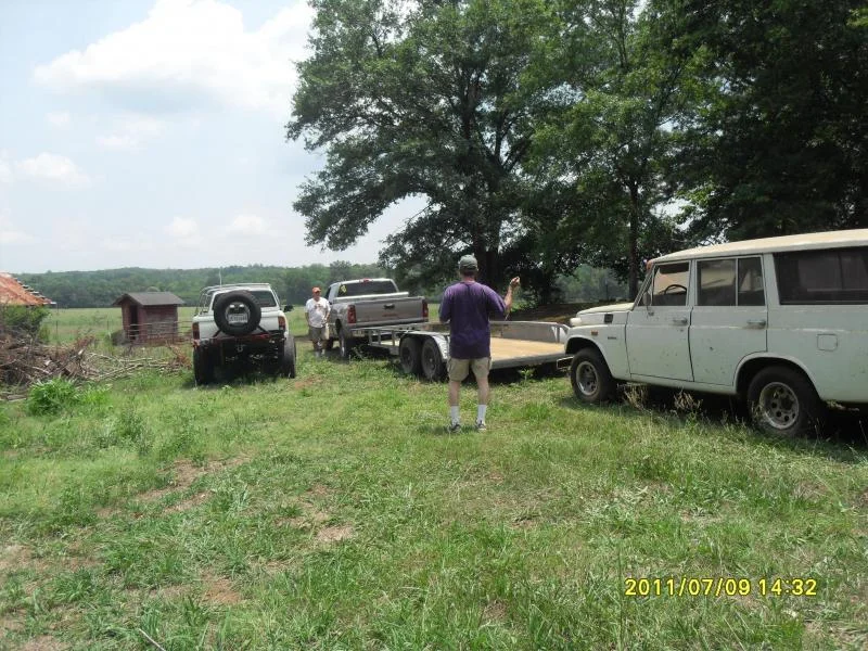

More pics of the Pig. I have it strapped to my Tacoma, and the right rear drum on the Pig froze up on us. Despite calling her Polly, she may earn the nickname Mule!

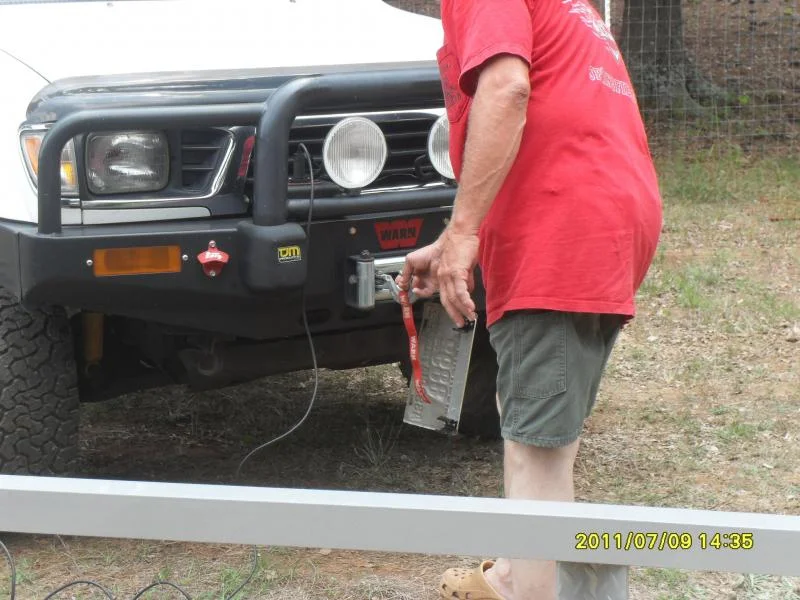

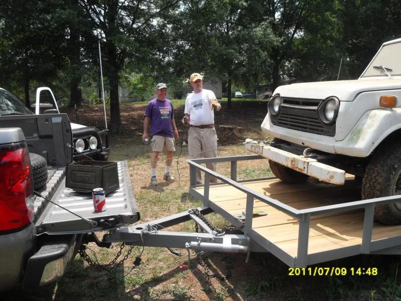

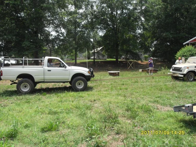

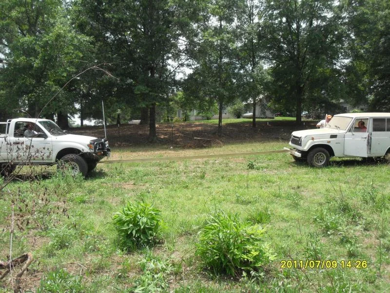

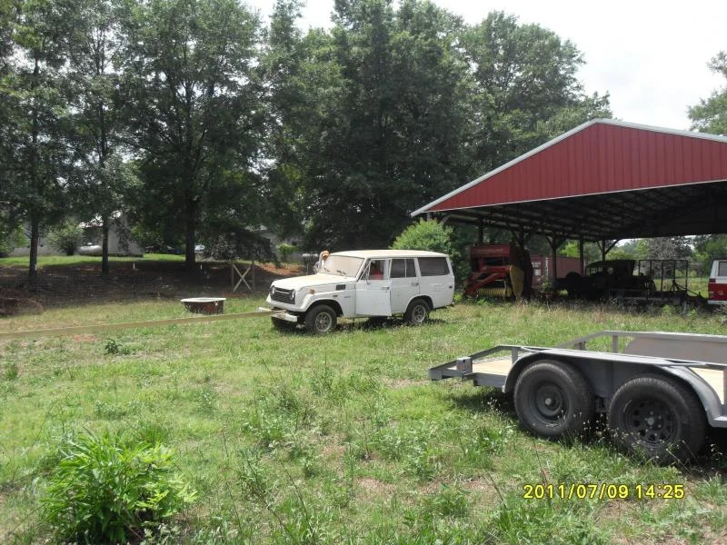

More pics. Using the winch from my Tacoma to ease Polly onto the trailer. Winching at an angle calls for the input of 3 Georgia and Alabama engineers, lots of heavy math, hours of calculation and another case of beer.

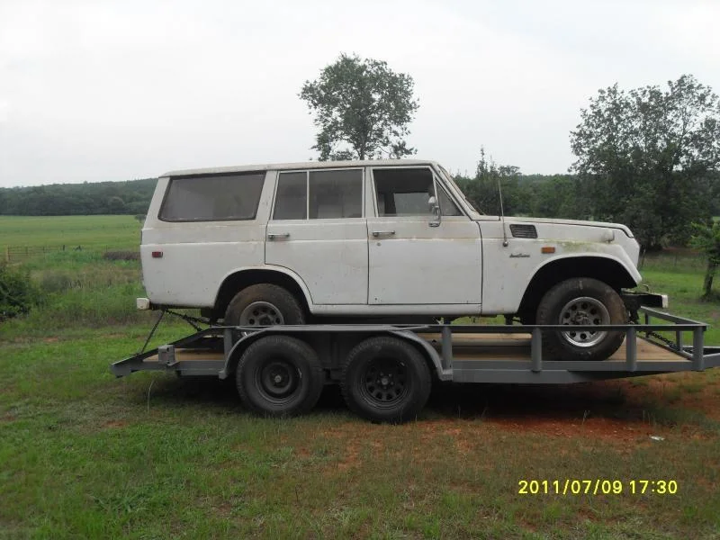

OK, before everyone freaks out - the rear chains ARE being adjusted to fit under the rear springs before it hits the highway.
She's home safe and sound! Little bit hairy getting her off the trailer (no brakes) but we had her strapped pretty good. She came off with no real problems other than a few sweaty palms. Looking forward to posting my progress. Stay tuned.

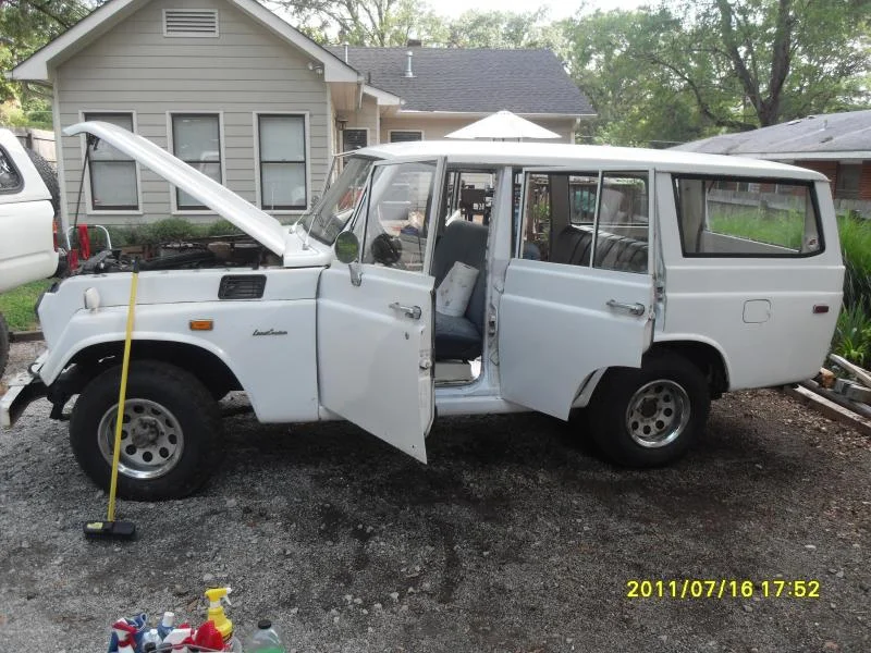

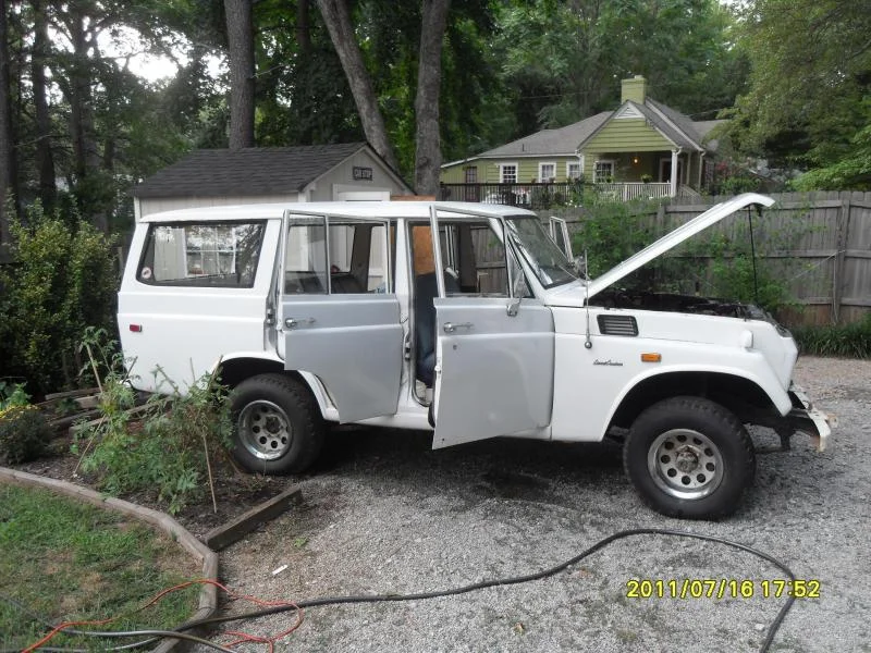

Well, being away for a week on business certainly didn't help get any progress made on the wagon. Flew back into town late Friday night, and all I could think about was getting up early Saturday morning to start digging into it and see what I was up against. The following pictures will chronicle my progress from this past weekend, which mechanically wasn't much but it was necessary to start cleaning it up. It was amazing to see how well she shines despite receiving a quickie shop repaint at some point in her life. It was also amusing to pull out all the 80s vintage add-ons. It became apparent to me, the more I dug into her, that this wagon has barely been touched and honestly, fairly gently used over her lifetime. Here's a pic of how she looked after getting her first bath in perhaps a decade.

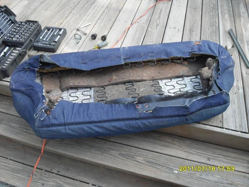

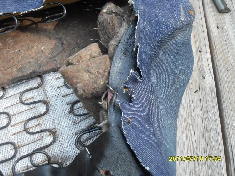

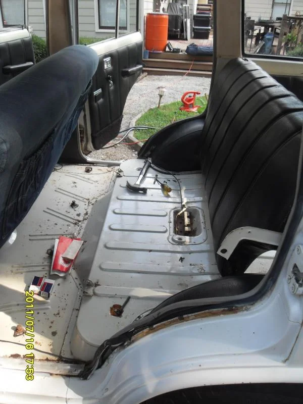

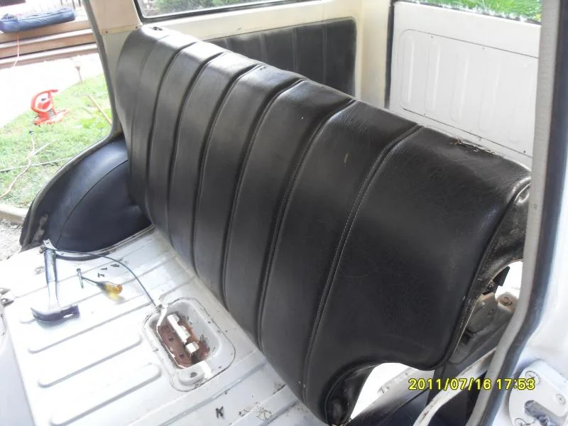

My next mission was to get in and remove all of the denim seat covers that covered both the front and the rear bench seats. I started on the back seat. I first removed the metal frame all the way around the rear bench, backing out one small screw at a time. I was able to remove the top and bottom portions of the frame which proved to be just enough to remove the shag carpet panel glued to the rear panel of the seat. What a mess! I now have a ton of glue residue to try to remove. I then thought that if I was going to be successful at removing the denim seat covers I was also going to have to remove the seat catches. As I dug into all of this stuff I wondered how many FJ55s out there still had all of this stuff intact. I was amazed at how well preserved the interior is! Once I got the two seat catches removed, I was able to make short work of removing the denim seat cover off of the seat back - and I was amazed to see that the vinyl was completely intact, save two small rips at each top corner. The question I have though is, would this be the original vinyl seat, or a replacement? While it matches all of the door panels, I've never seen this pattern in an FJ55 before. Maybe someone can help answer this for me. Either way, it's in such good condition I'm going to just leave it in. I think it looks great.
Rear seat bottom
Next came the removal of the rear seat bottom. This was easy, as it was only held together with two anchor bolts. I quickly removed the cotter pins, hammered out the bolts and within five minutes I had the rear seat bottom out. I took some detail pictures of the denim seat cover to show how well it preserved the vinyl seat covers beneath! Turns out I'm thankful that the denim seat covers were on these for so long - look how well the seats were preserved.
shag carpet gone, floors look pretty good

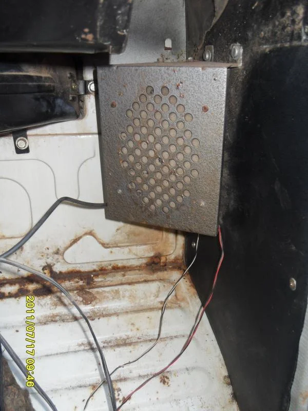

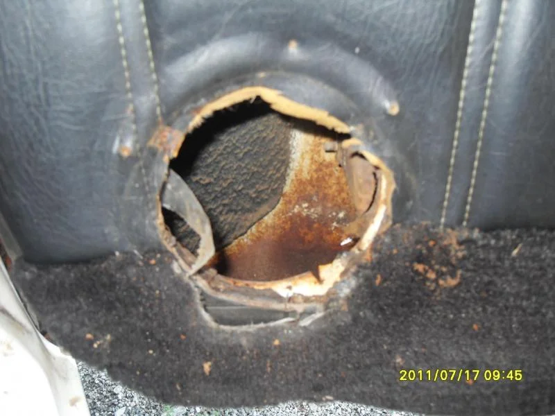

So I went around the wagon and removed all of the shag carpeting. This was probably the cause of the worst rot on the truck anywhere. Once I removed it, the rot on the passenger and driver's side floorboards was revealed. It's pretty nasty. On the passenger side, it's completely rusted through in some spots and the metal is very thin. Both sections on both sides will have to be cut out and replaced. I was amused to find the original AM radio speaker hanging in the passenger side floorboard.

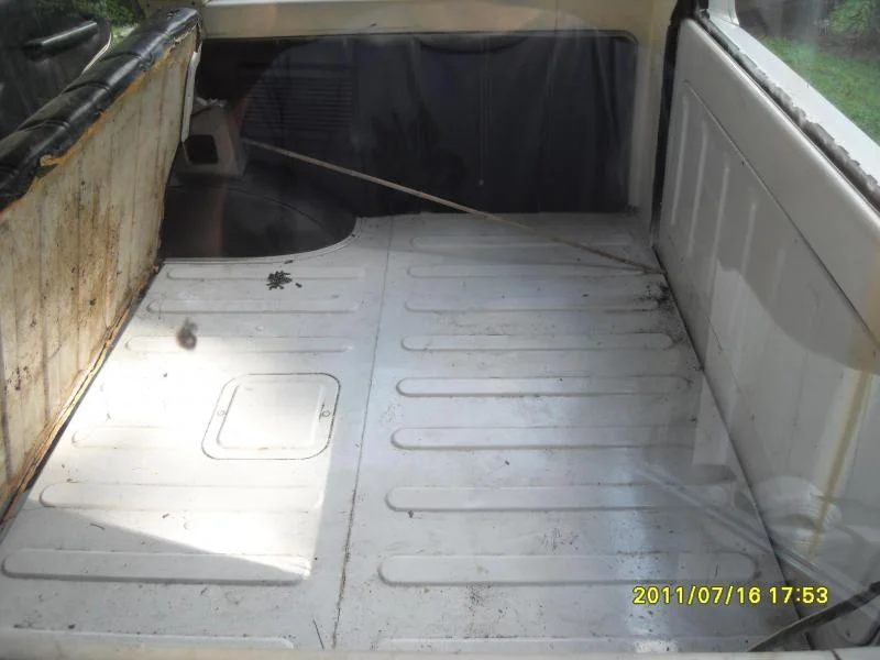

With all the carpet gone, the worst areas were the front and passenger sides. However, the rear passenger and cargo areas are surprisingly intact. You can probably see all the glue residue on the back seat that I'll have to try to get off. I've heard that WD40 is pretty good for removing old glue. Any other suggestions or better recommendations?

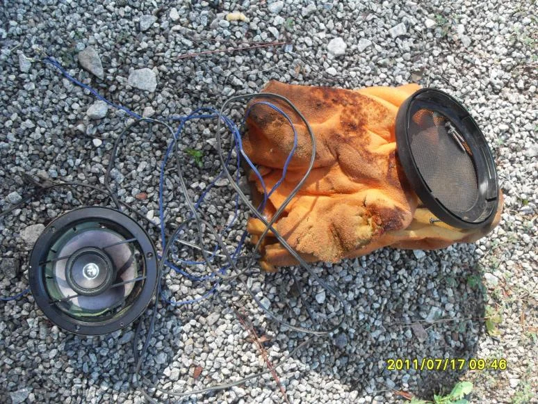

On Sunday I had an hour to kill so I removed the old AM/FM cassette stereo from the dash. I also dug into the driver and passenger doors and removed the old, dry rotted speakers. I was really disappointed to find that a P.O. had stuffed each of the doors with sheets of foam insulation to deaden the vibration from the speakers. The insulation had trapped moisture that was infiltrating the doors, and is now causing each of the doors to rust from the inside out. This will be an involved repair that I'm not looking forward to.
