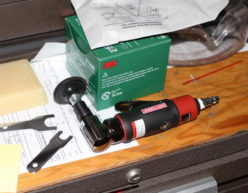

Picked up the Craftsman, which I'll try out for a week and return if it doesn't work out. This should also be a good test for the DeWalt compressor to see just how usable it is with a die grinder.
I still may jump to something like Snap-on later ...
Flap wheels have their place, but the Roloc style disks are better in most applications.
I see your point - these 3M Green Corps 2" disks I've picked up are great on the pneumatic grinder. Much better for the final finish/blend grind than trying to control a larger flapper. And great for getting into tight spots.
Update:
The Craftsman angle grinder seems fine so far, bearings in the angle head seem good, etc. - but I'm not pushing it too hard.
The little Dewalt is doing better than I thought but it's pretty easy to run the tank low and the pump motor runs most of the time. But it works ok - not what you would want in a real shop concerned about getting lots of work done :)
