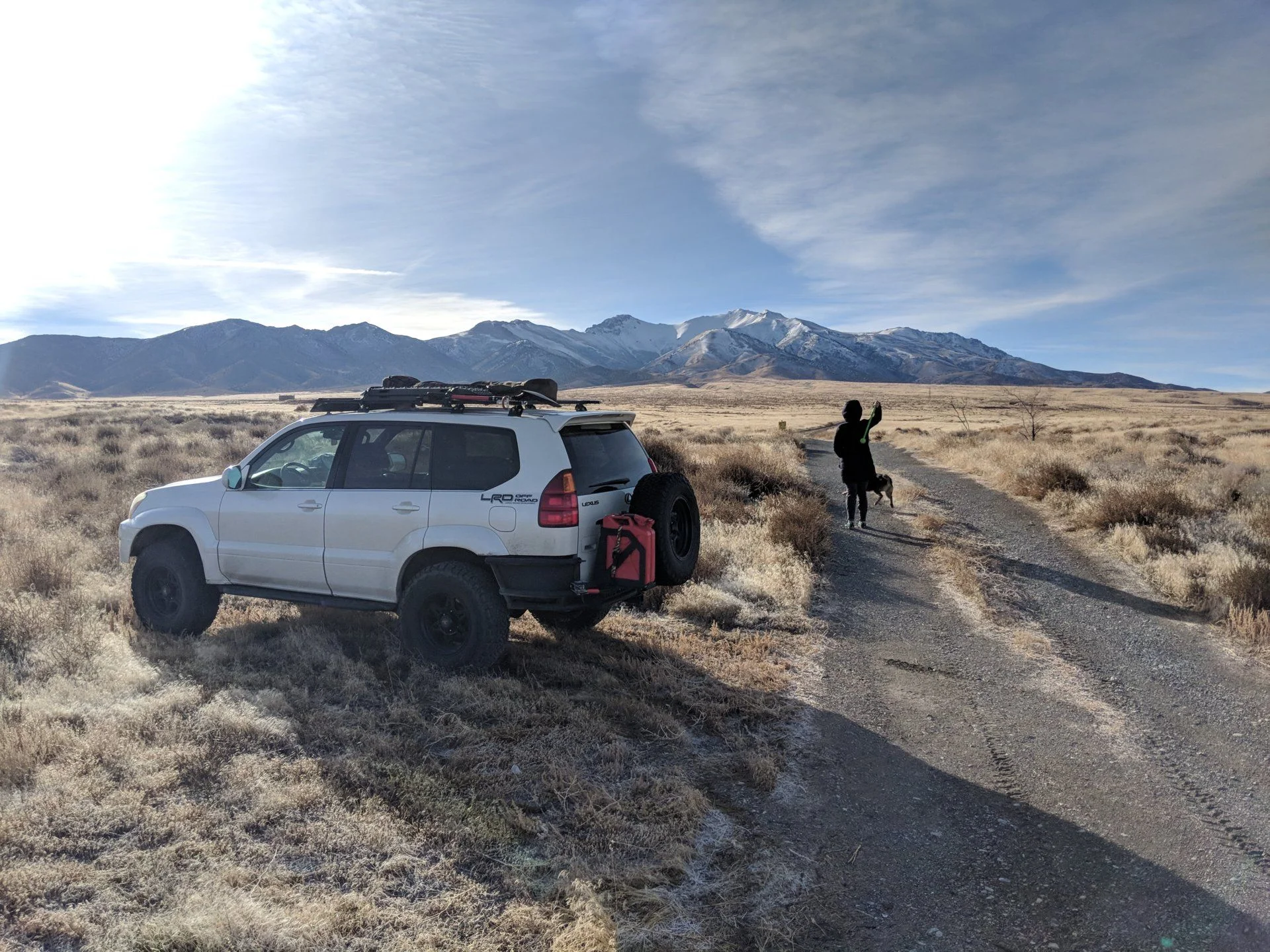

With a kid that badass looking, I would just open up my sunroof and tell him what to hold on to.
Honestly, though, this is the same thing I've been going through, so I'm curious what people's thoughts are, also. I am planning similar use for my setup (awning support plus can-carrying), except I will also need to get skis up top in the Winter. That could be done with a topbox, but the ability to add ski/board clamps would be a plus. This may limit me to the transverse bar-style.
@MaverickFiveO Dude! You made my day/week!!! 🤙😆👍
Proud poppa here!! That kid is pretty rad though, for sure!

I went through several DIY iterations to get to where we are, including:
1) Steel mesh rhino rack on top of factory bars (looked silly and was wobbly)
2) Steel mesh rhino rack on top of Gamiviti towers (stable but some wind noise, no real center support)
3) Steel mesh rhino rack on 80/20 cross bars on Gamiviti towers (crazy noisy with all the metal-on-metal vibrations)
4) Sold rhino rack and added 72" 80/20 bars along the length of the car with 3 horizontal 80/20 bars on the Gamiviti towers (sturdy, some wind noise and not the right "look")
5) Added a plywood wind fairing to the front cross bar just behind the windshield, but had to remove it due to wild oscillating at highway speed. The 72" 80/20 wasn't stiff enough to prevent flexing in the unsupported front section.
6) Added two short vertical supports under the front cross bar with suction cup feet and put the wind fairing back on. Perfection!
We don't load up the roof with gear, it has the awning and mounts for a shovel and axe. I wanted to keep it low and unobtrusive, and be able to throw a kayak/canoe on it when needed. In the winter I toss my skis/snowboard up there while I dress. I really like the ability to add stuff to the 80/20, but corner construction like you mentioned can be a pain. There are maybe 80 t-nuts on it! Not sure where I am cost wise but at least I'm finally happy with it. FWIW I wish I could afford a prinsu style rack.
