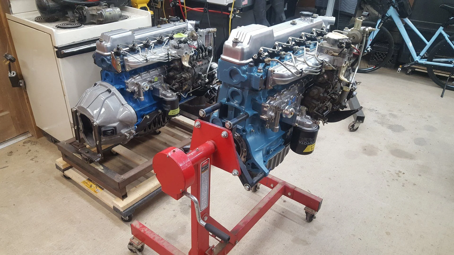

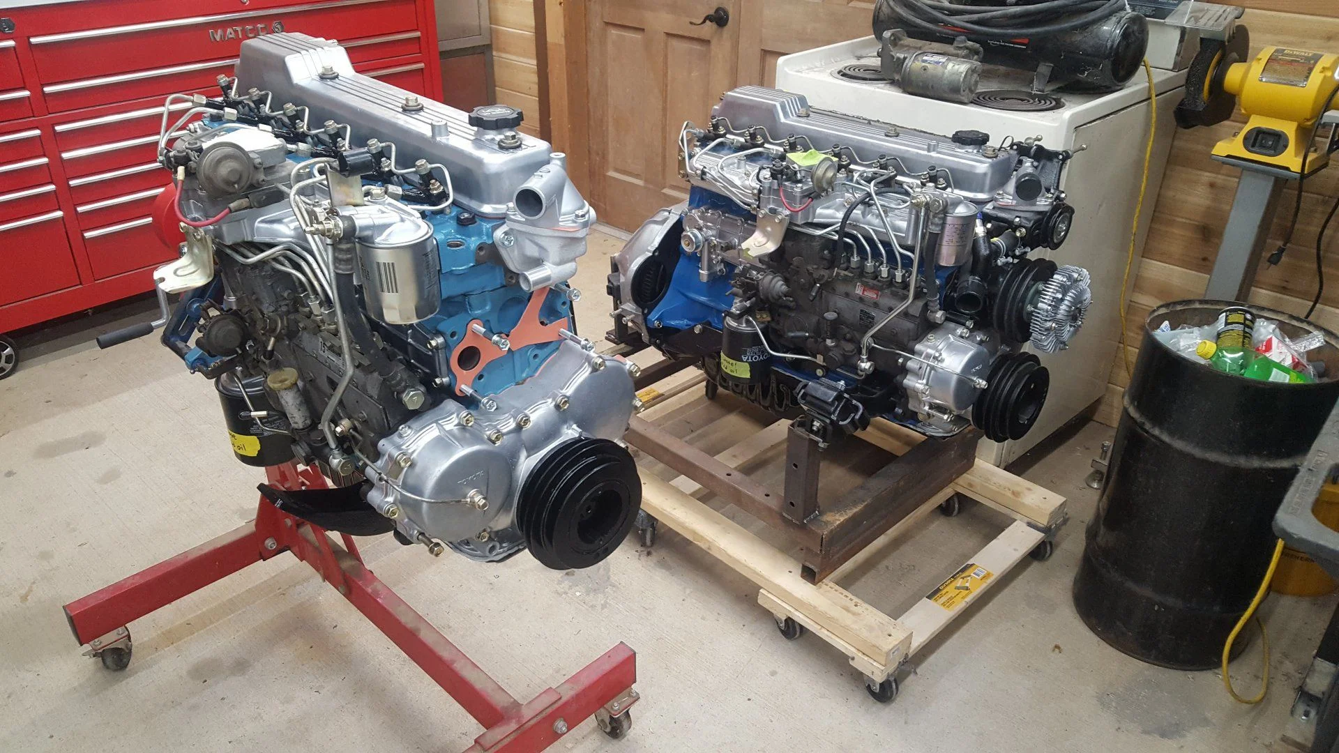

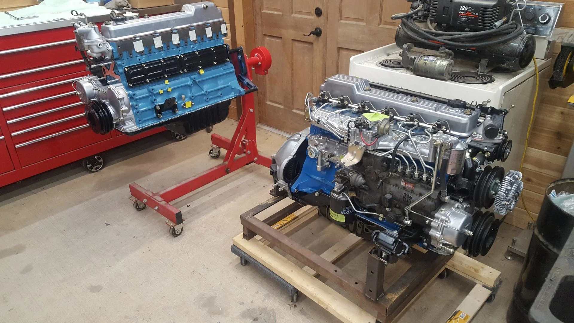

Twins
Except one has 0 km on it and the other has 465,000...or wait....0 km on it!
Time to ship it up here...or come for a visit!
The suspense is killing me!
1. You’re the man.
2. You have a wonderfully patient wife.
3. I guess I don’t need to sent the manifold and water pump now!
4. It sounds freaking awesome.

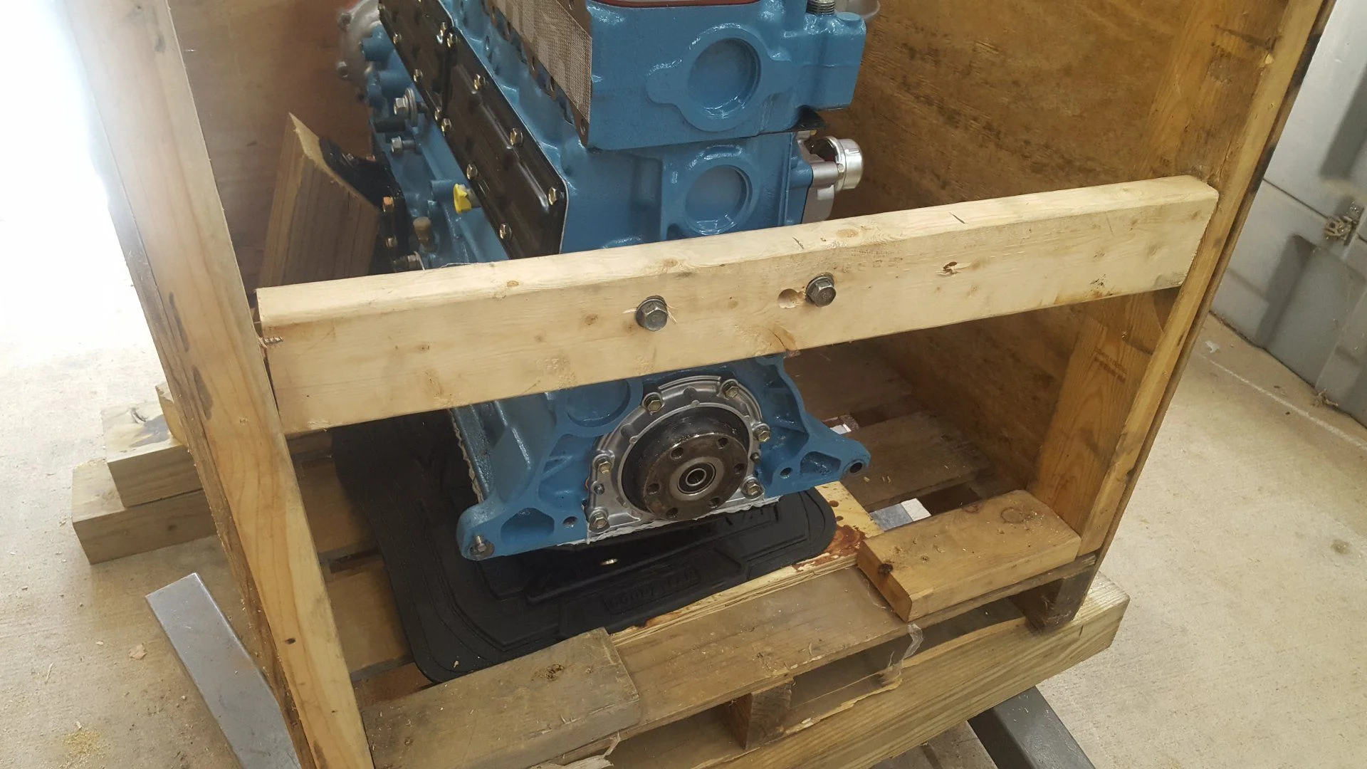

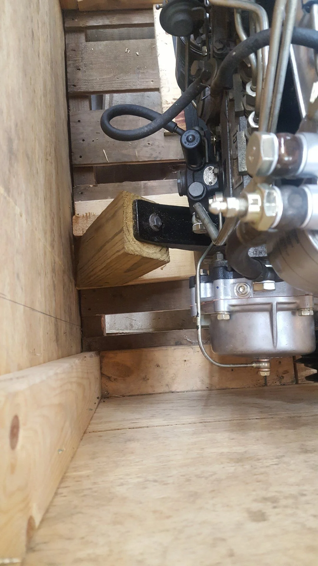

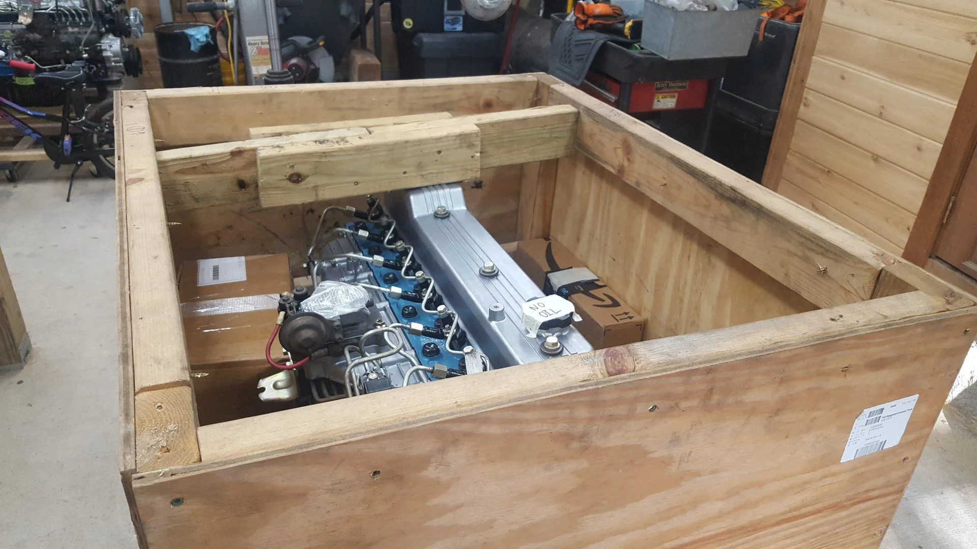

It would have sounded so much cooler with the turbo though :p I just wanted to do a function check before we shipped it back off after having so much apart. No oil leaks so I guess I plugged all the oil ports. I have a bolt and a fuel hose to pick up from Toyota for you tomorrow and will also try to round up a suitable replacement for that coolant pipe. Should be able to get it all crated back up tomorrow so we need to find a way to ship this sucker.
Soon enough, we’ll hear that turbo whistle. I’ll start looking for shippers as well.

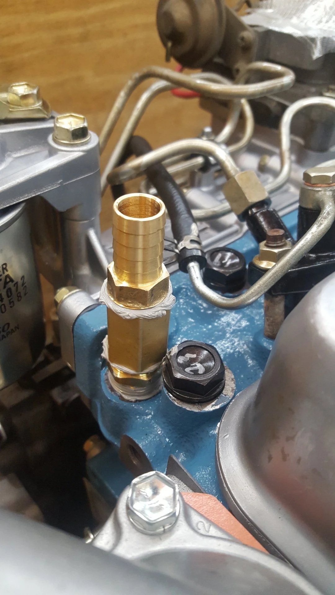

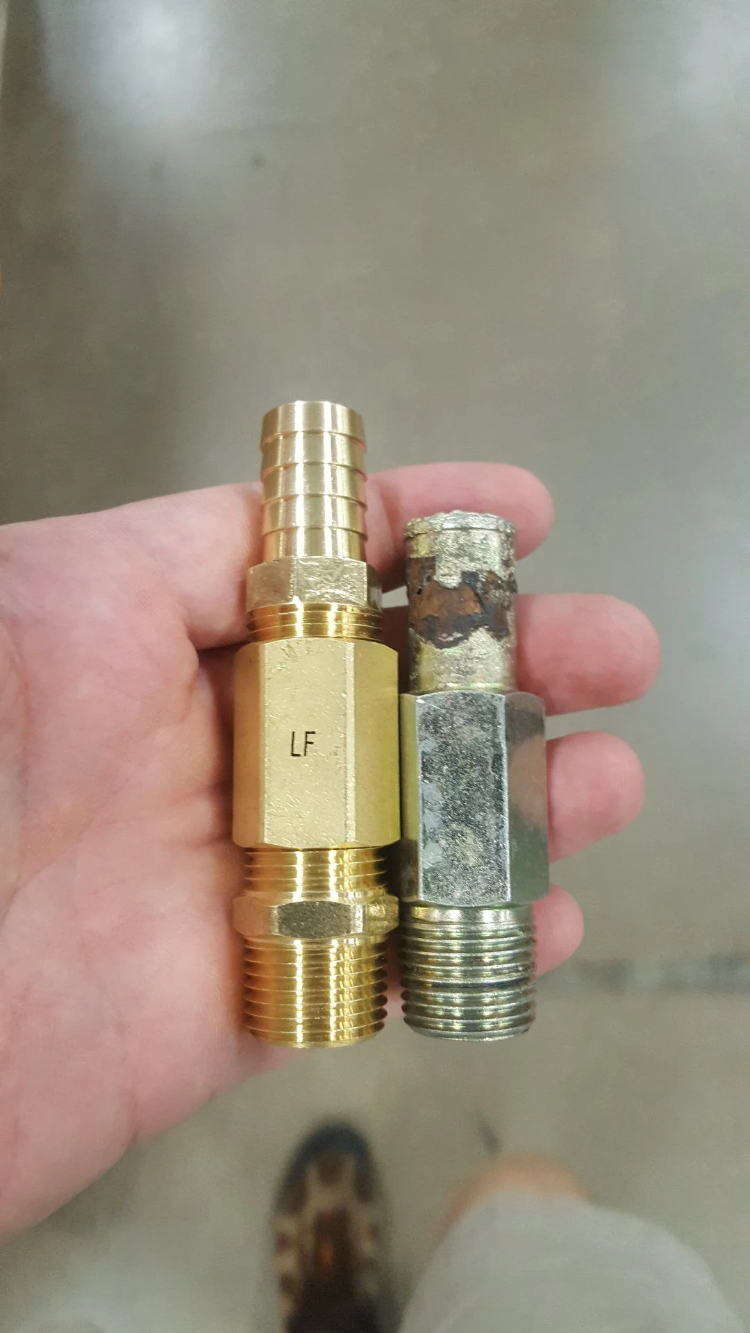

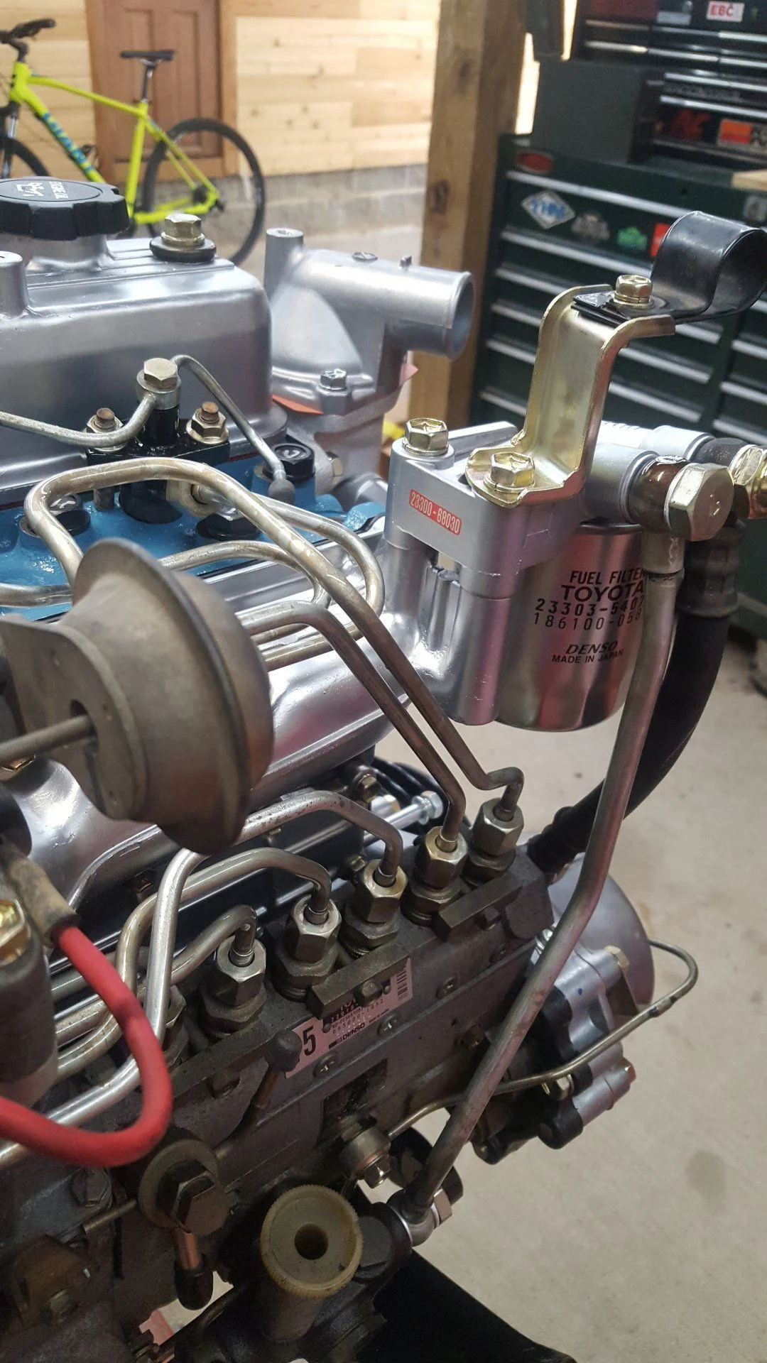

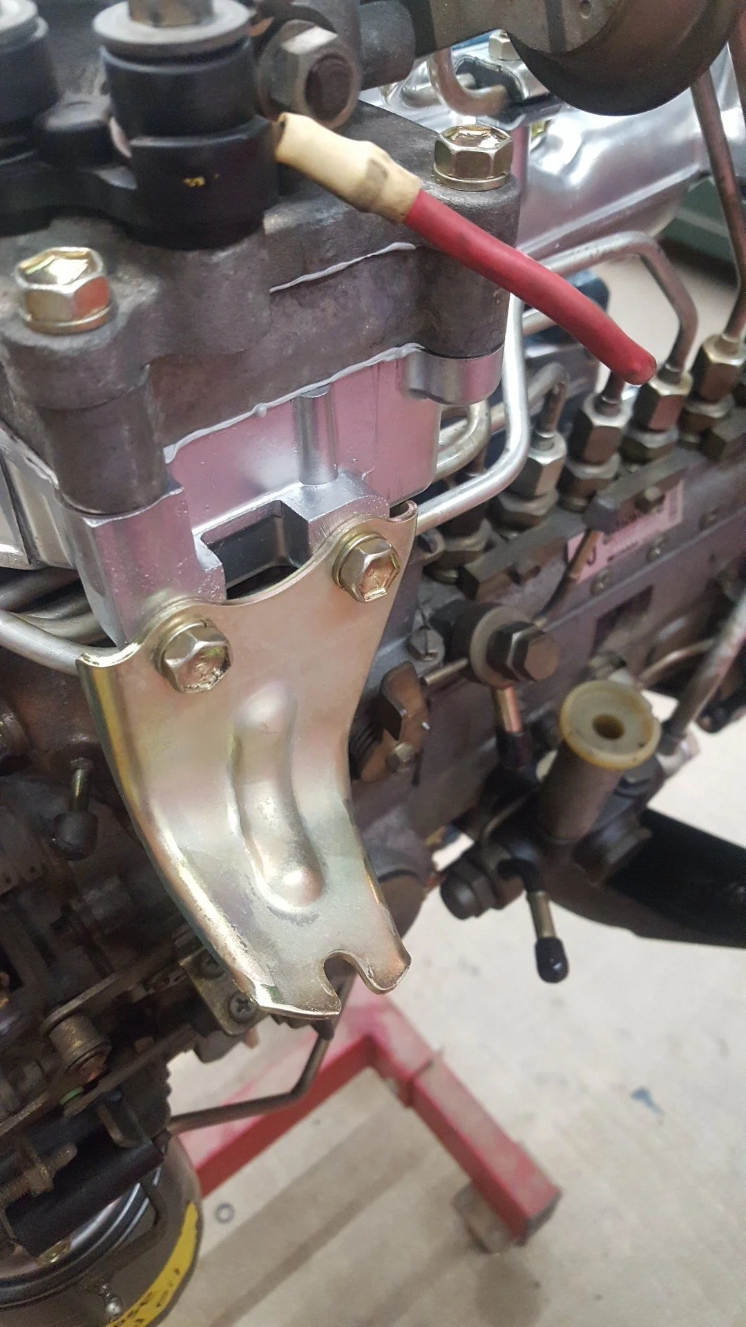

Found a suitable replacement for this coolant pipe. After all three fittings are tightened it's damn near the same length and this one won't rust.

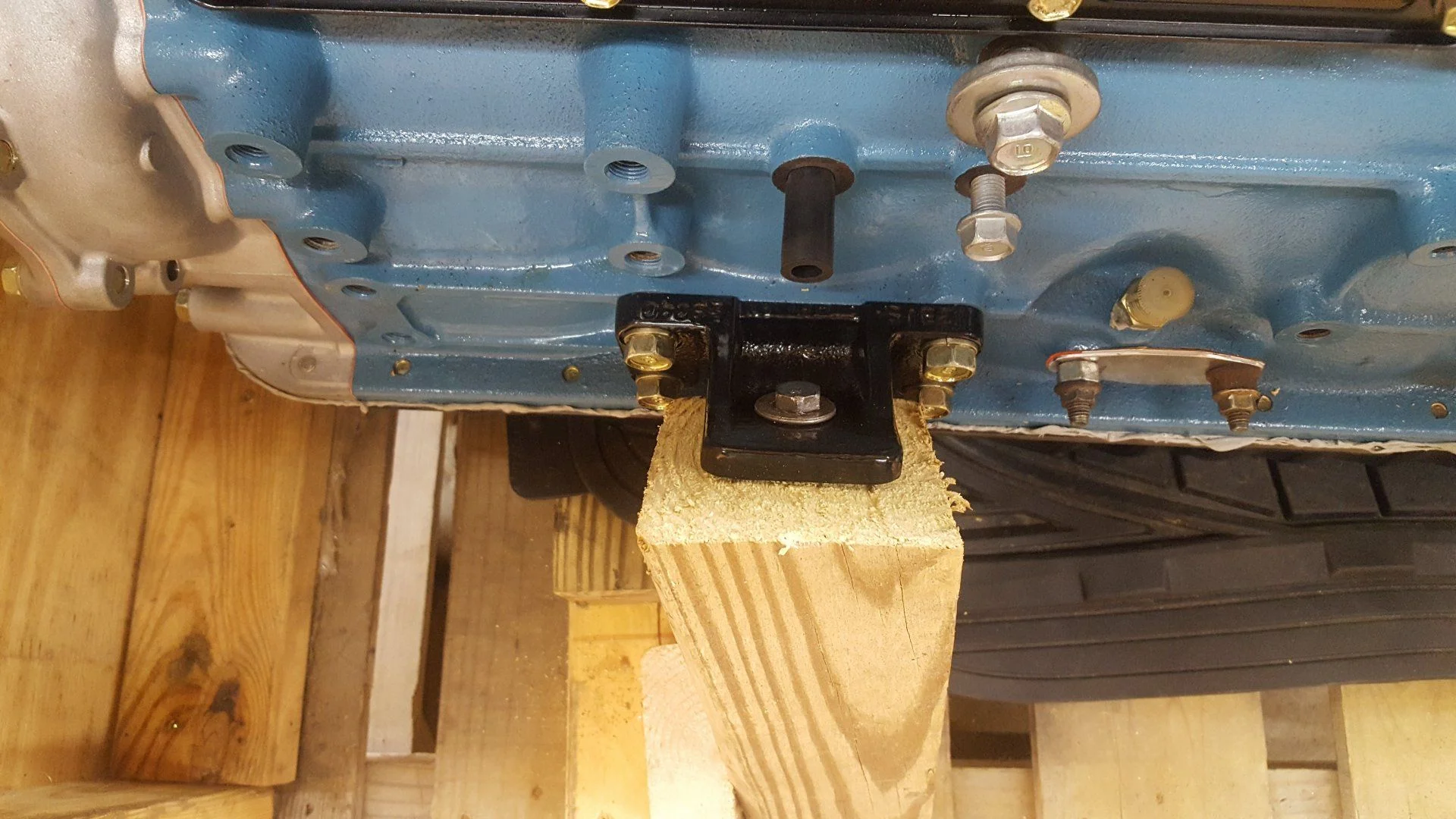

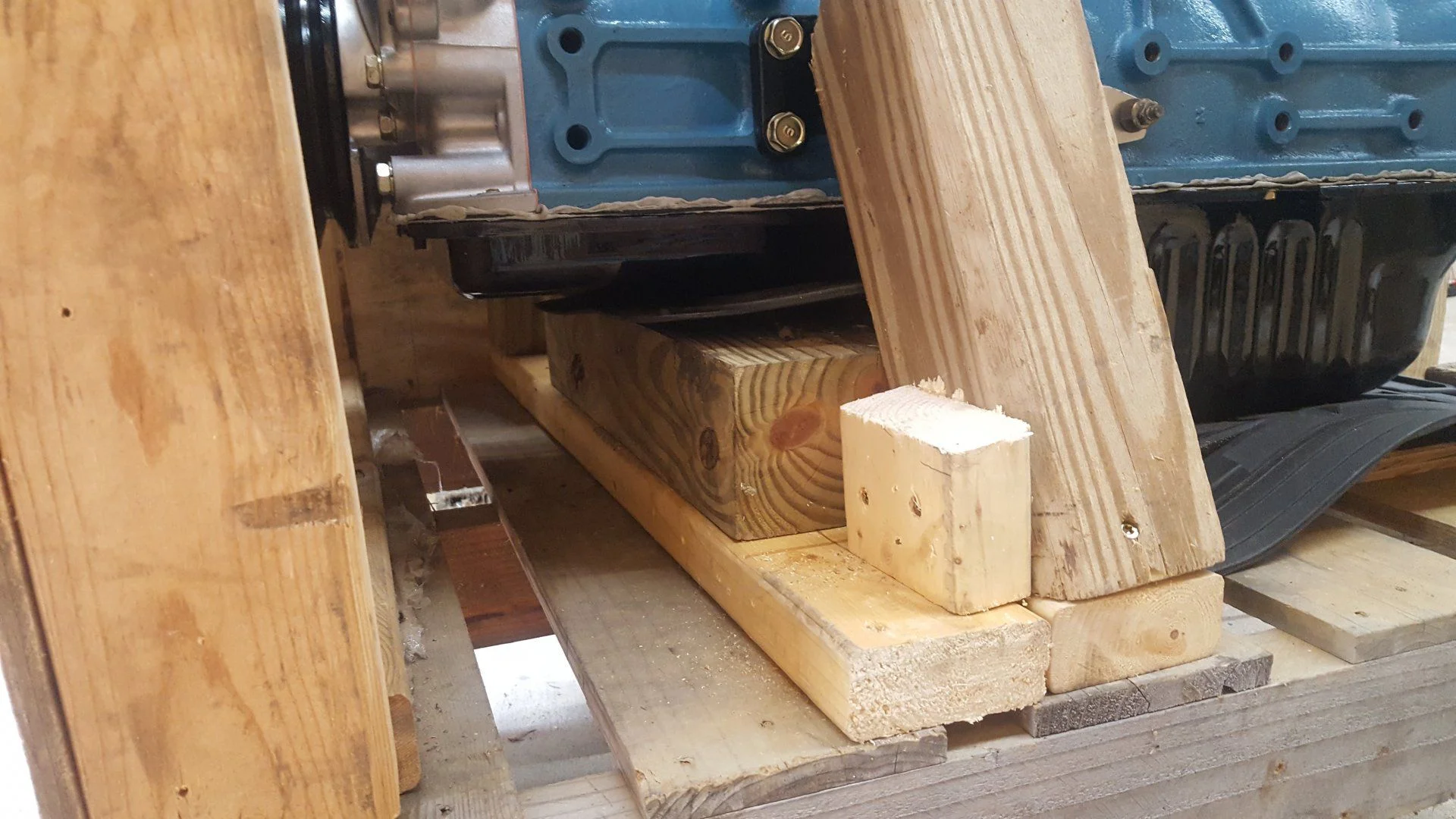

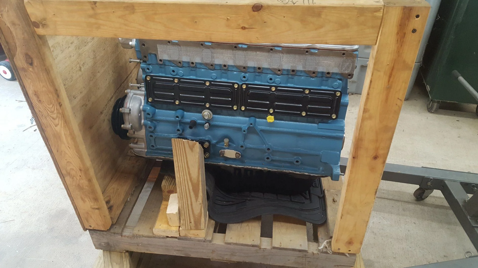

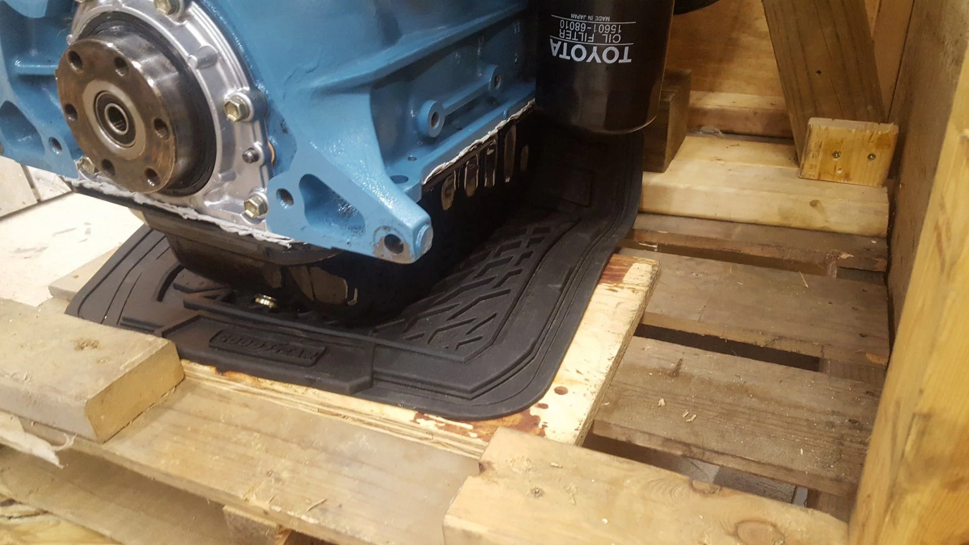

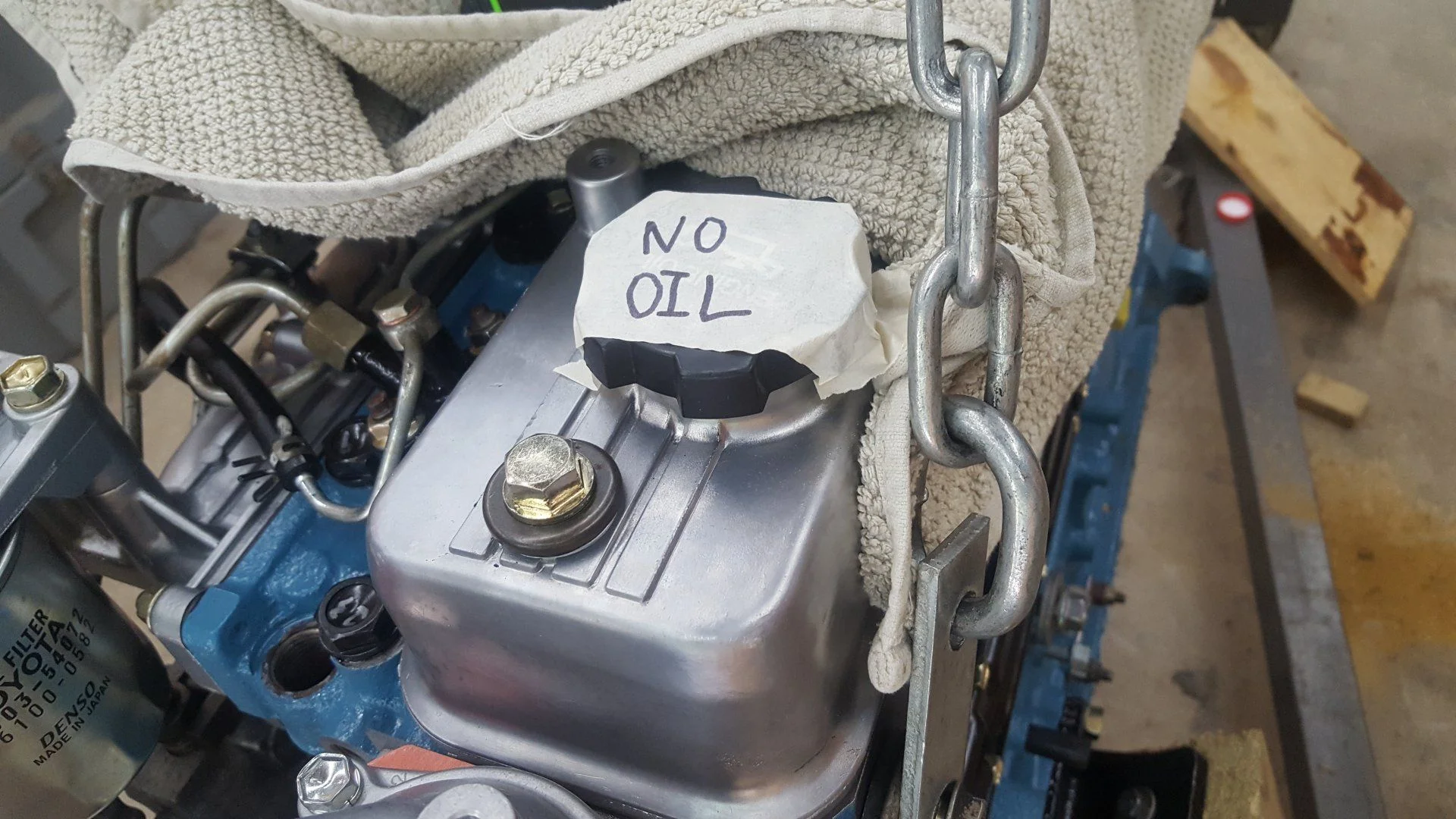

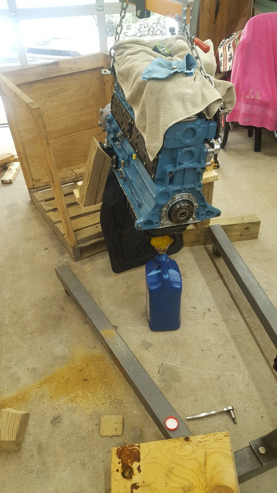

Also drained the oil back out for shipment back to Texas.
