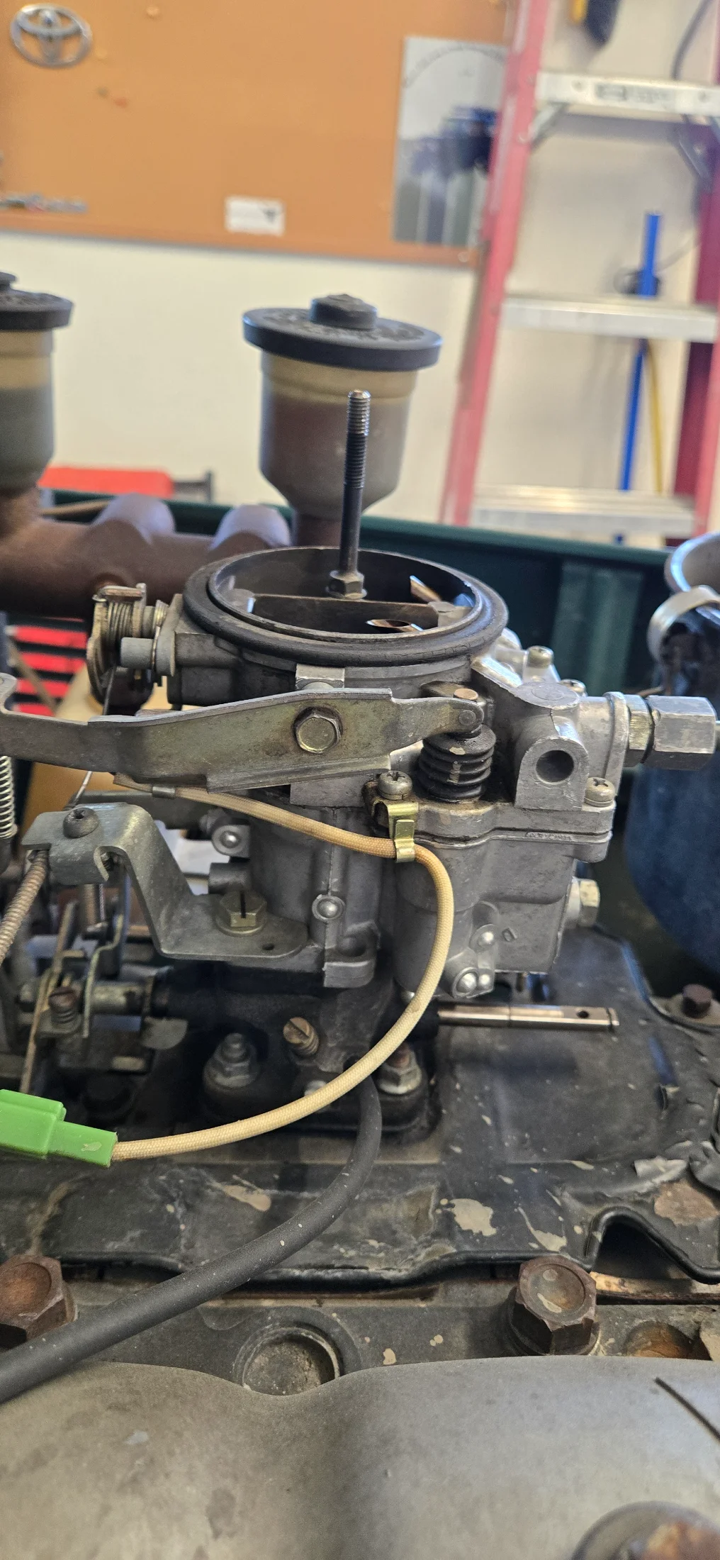

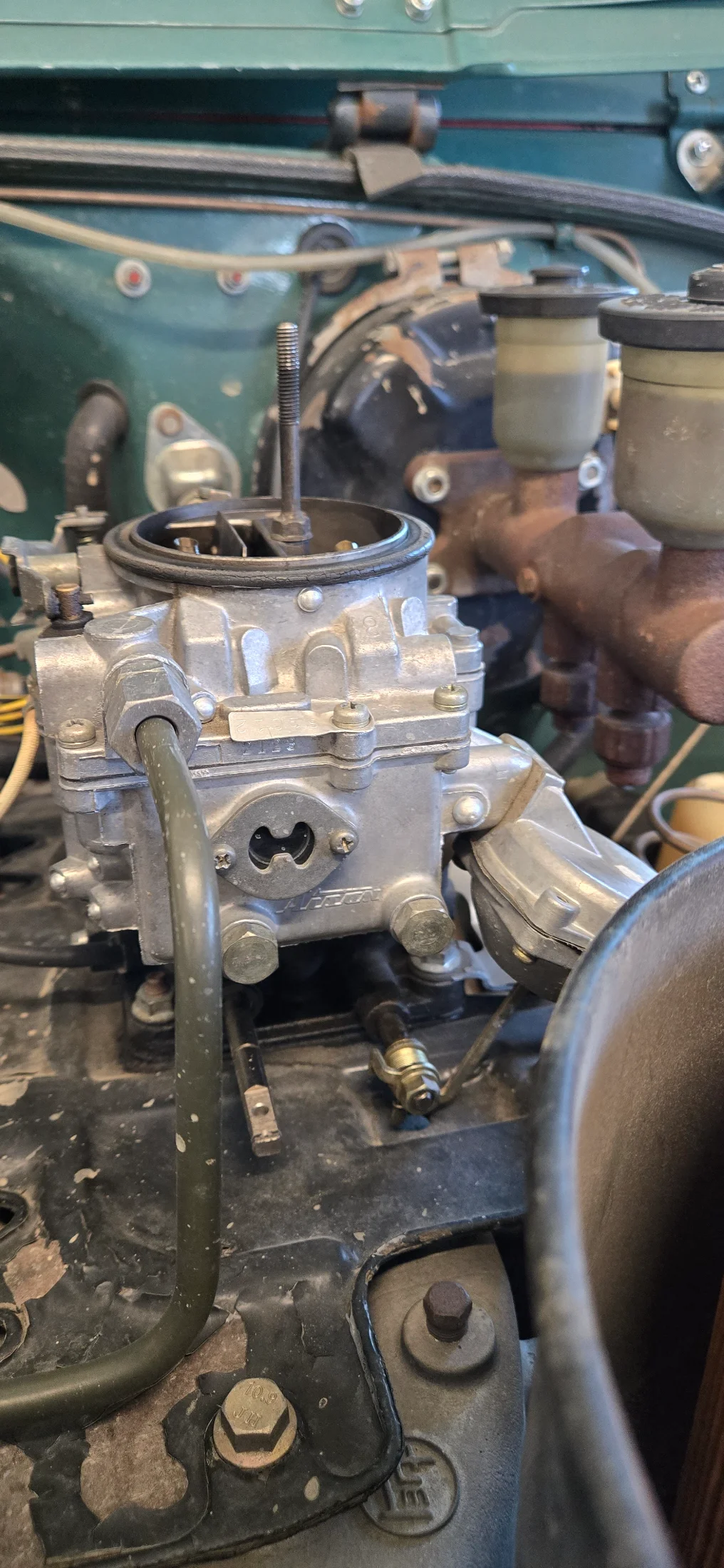

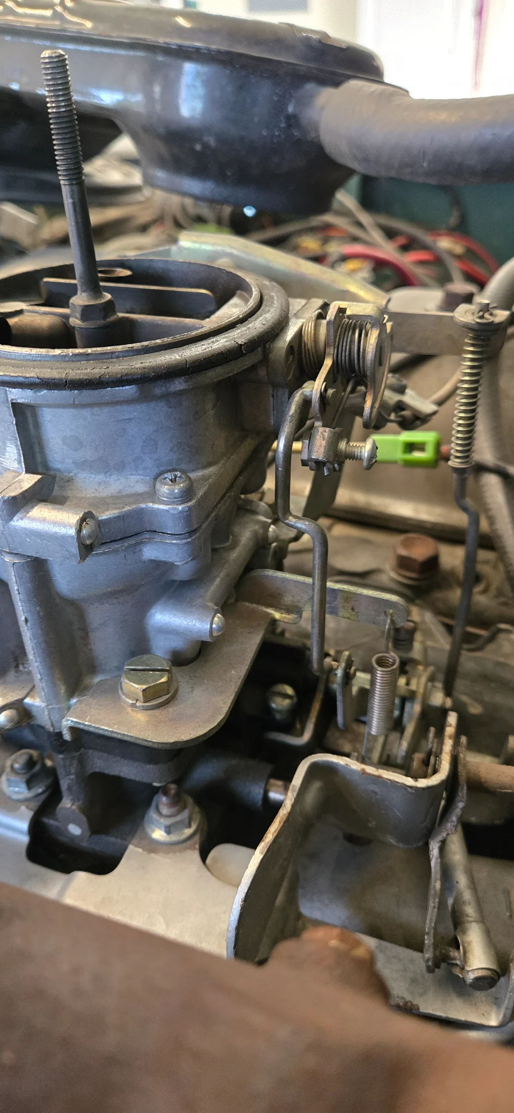

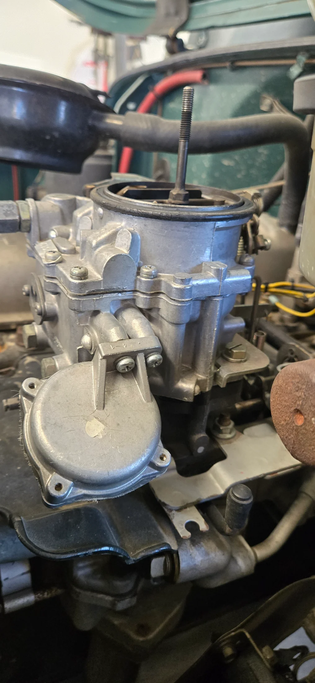

I need to rebuild my carb, it looks like it's siphoning fuel from the fuel bowl through the primary side somehow, Ima going to guess that running a couple thousand gallons of pure cornbred gasoline through the carb has gummed some stuff up.

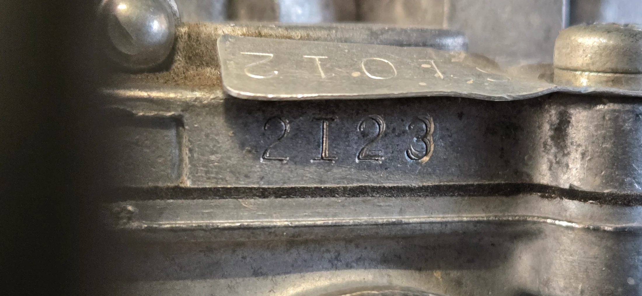

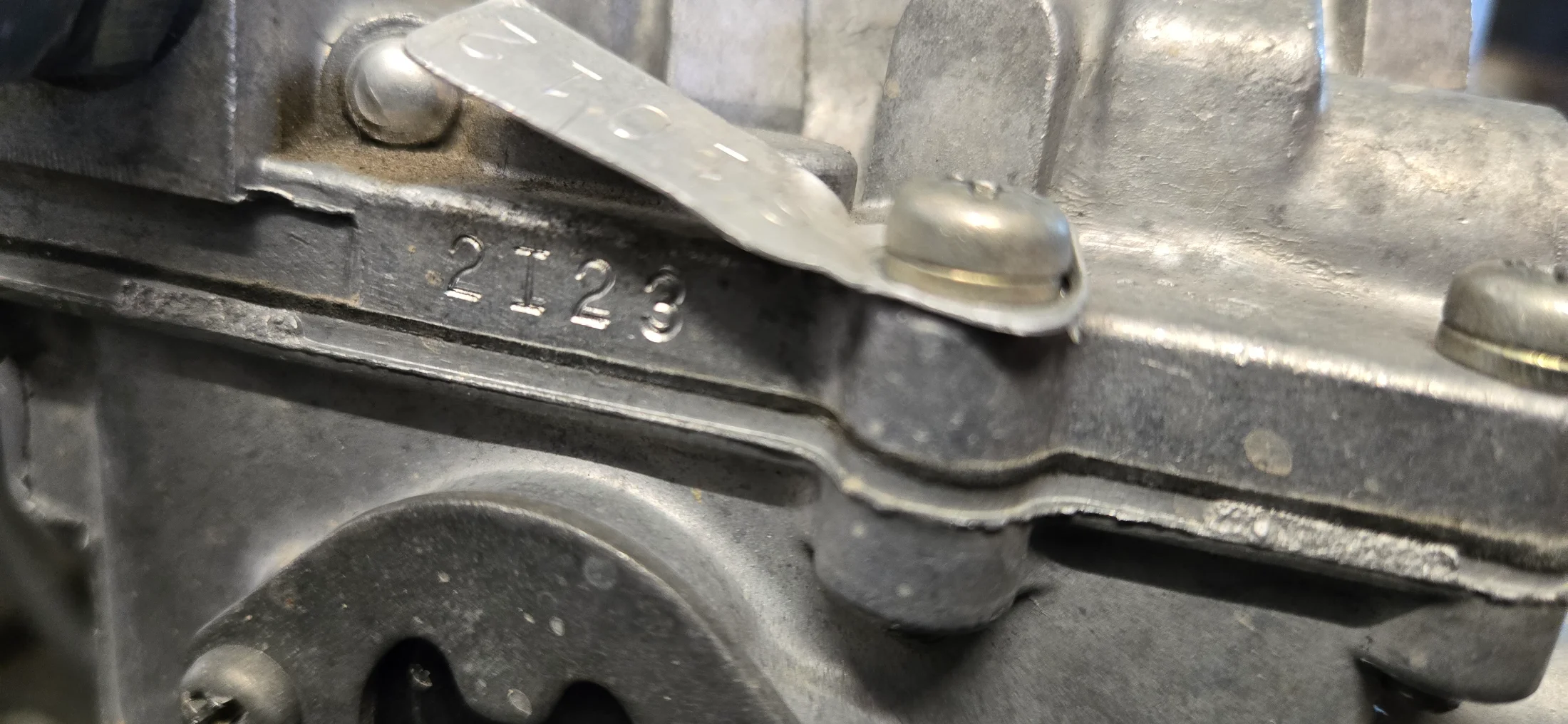

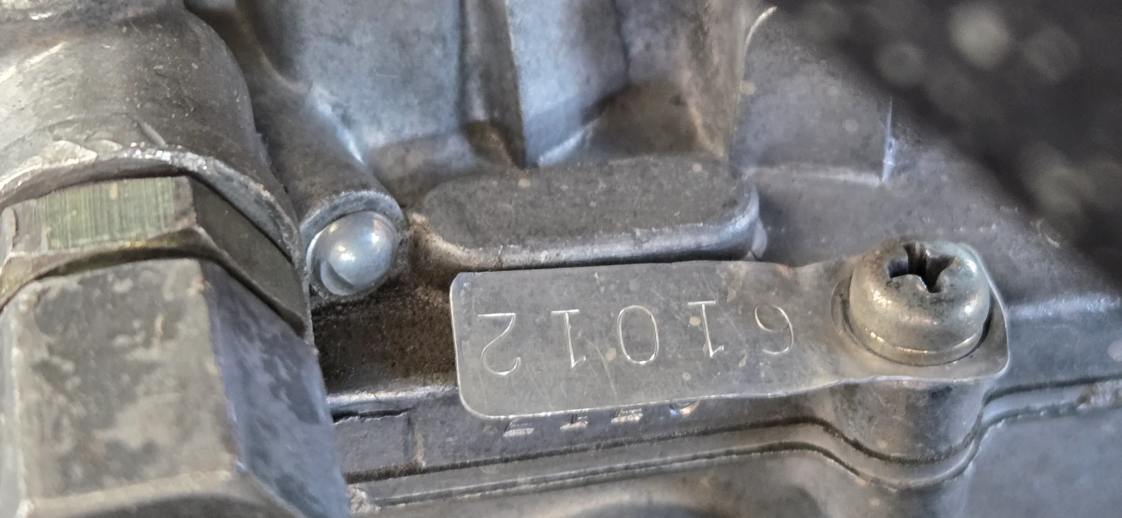

I'm not certain on the proper rebuild kit that I'm going to need for this, it is a non-US spec carb, 21100-61012, dated 1992, Sept 23rd. The noted from JimC also state something about 81-84 poverty spec 2F.
I believe I used a rebuild kit for the 80-87 era 2F last time, Carburetor Rebuild Kit - Fits 8/1980 - 8/1987 FJ40/60 (CARB61171) - https://cruiserteq.com/carburetor-rebuild-kit-fits-8-1980-8-1987-fj40-60-carb61171/
Anyone have any solid input? Either way I'm probably calling @cruiseroutfit tomorrow.

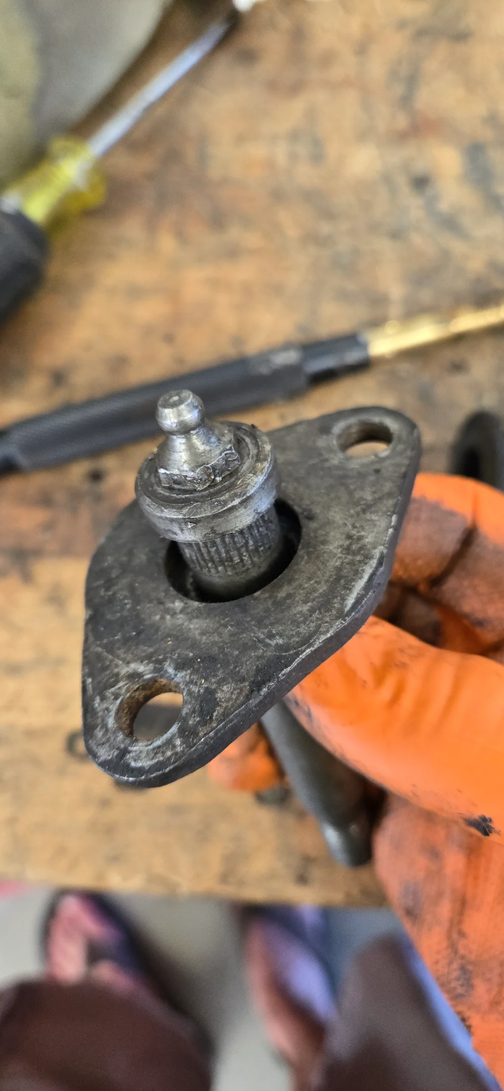

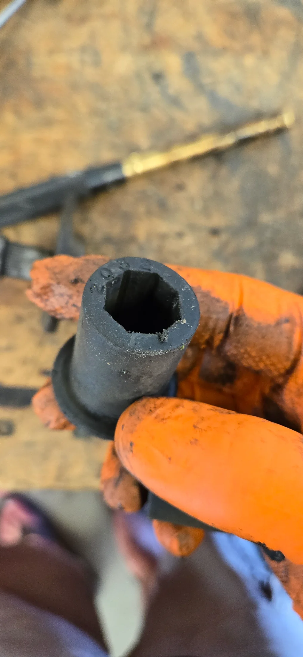

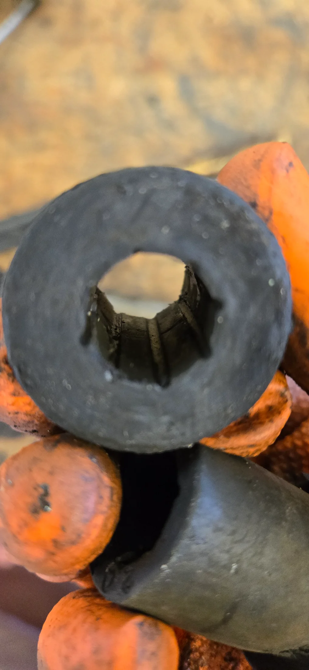

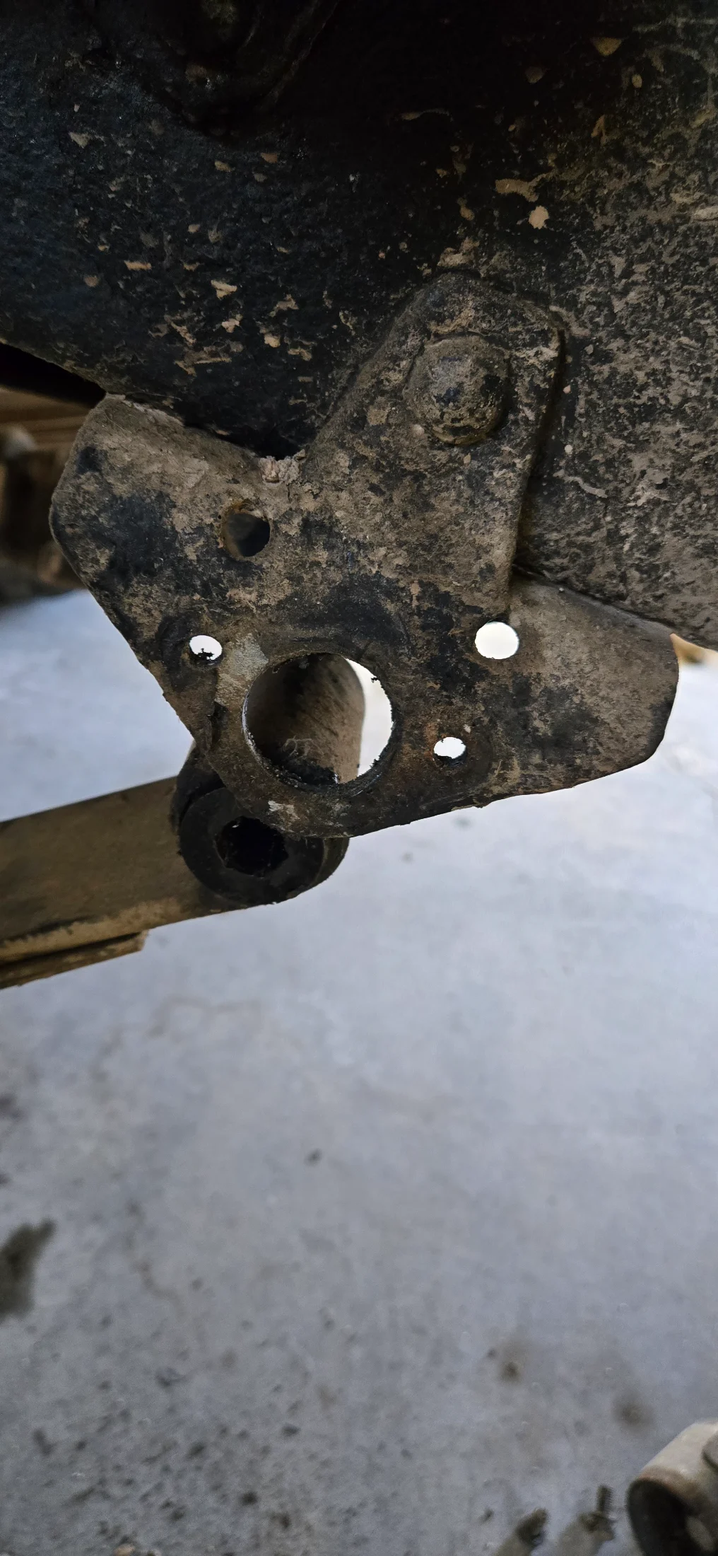

Also found another annoying knock. I'm 100% sure that grease would help here.
Not to mention the spline portion of the pin is loose in the flange.

You know that if you’d mentioned you needed grease i could have helped you out lol. Still had the grease gun in the 40 from our Wyoming trip

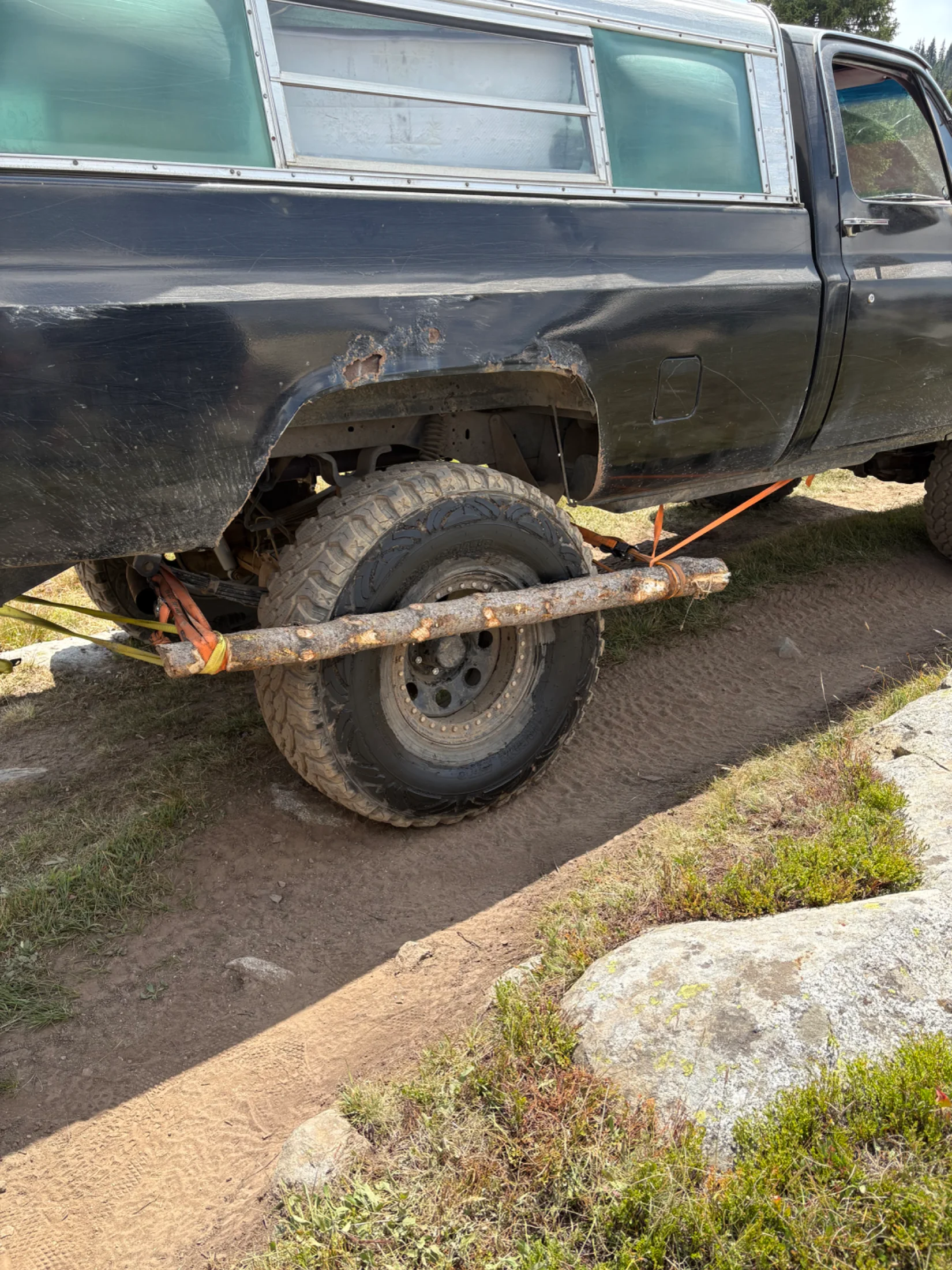

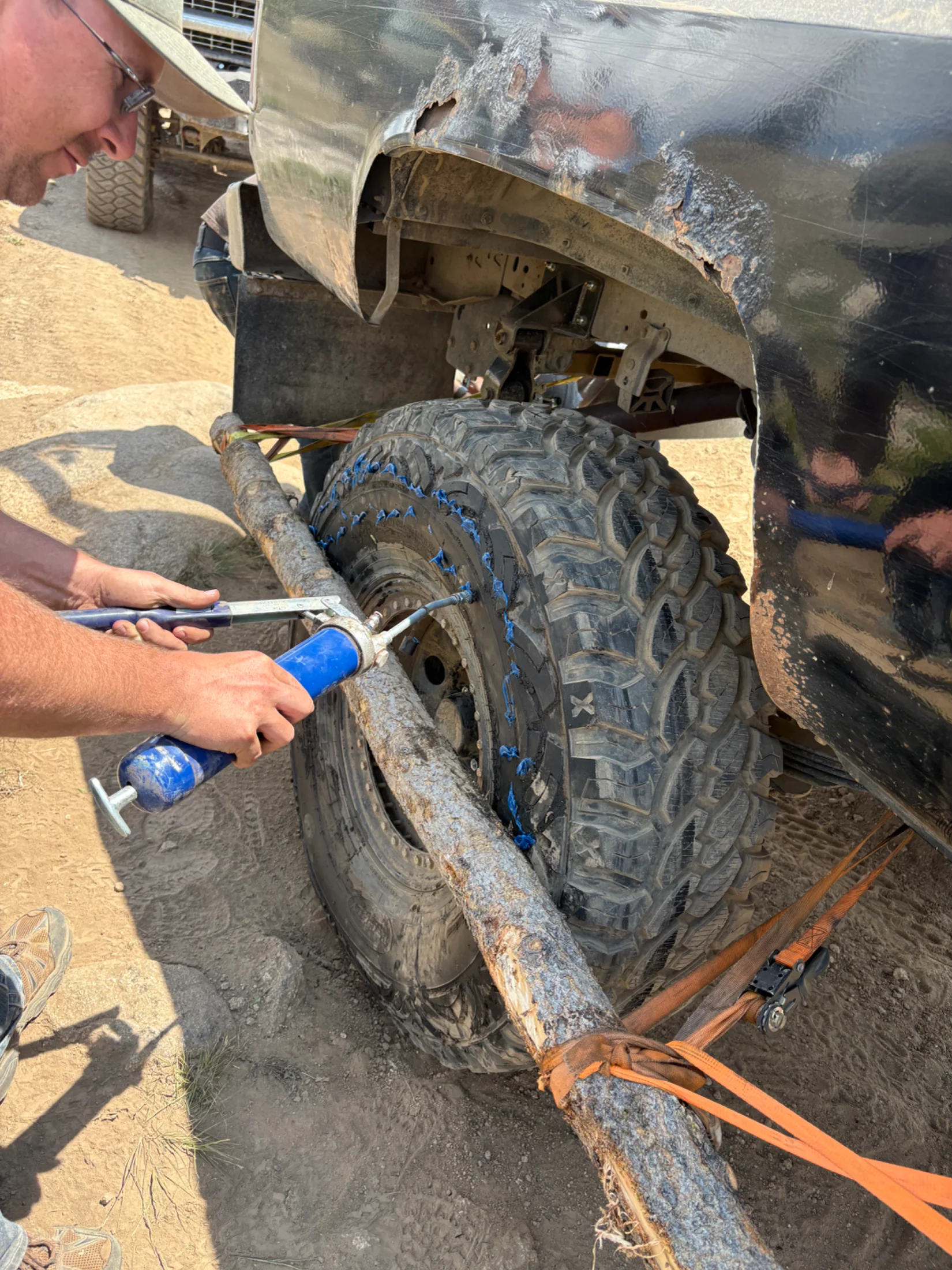

We've had to make that same type of contraption out of logs, when jeeps broke their weak ass dana 35 axles. I'd hand the drive or passenger a qt of gear oil to pour on the tire while I was pulling them down the trail with the 40.
I believe that contraption and it origins need an explanation!!
we were 15-20 miles from the trailhead when he discovered the limit of his axle. broke right at the spline so we used a cutoff wheel and took out a hunk so there wouldn't be any heat build up or other issue then had to hold to tire in. def knew when it needed regreased when you could smell burning wood and rubber. lots of winching and pulling getting it thru the rough spots. was a fun trip.
Wheel off, big log chained in place underneath on a slant and used as a skid. Put in 4H or 4L and drive out on the front axle as best you can.
Way back in the day, Grampa Red dragged around a big stump with his 4 banger jeep while waiting for brake parts.
Field Expedient, was what we called it in the signal corps
that idea was discussed but we knew it wasn't going to get any easier ahead plus had a water crossing that we didn't know what the bottom was other than the water was around 3 ft deep. had to be on all 4 wheels if possible. with the further obstacles that needed winching him thru when he couldn't make it with just front wheel drive it was the right decisison. when we found a spot with cell reception my boy got ahold of a buddy who tried to find an axle, couldn't find the 28 spline only the newer 31 so onward we went. it was somewhere around 20 miles to where we could get a trailer into. ratchet straps are your friend
From my experience with wheeling with 90's jeeps your trail repair is The Standard Operating Procedure. Your execution is flawless except for the use of grease. The jeepers prefer gear oil.
