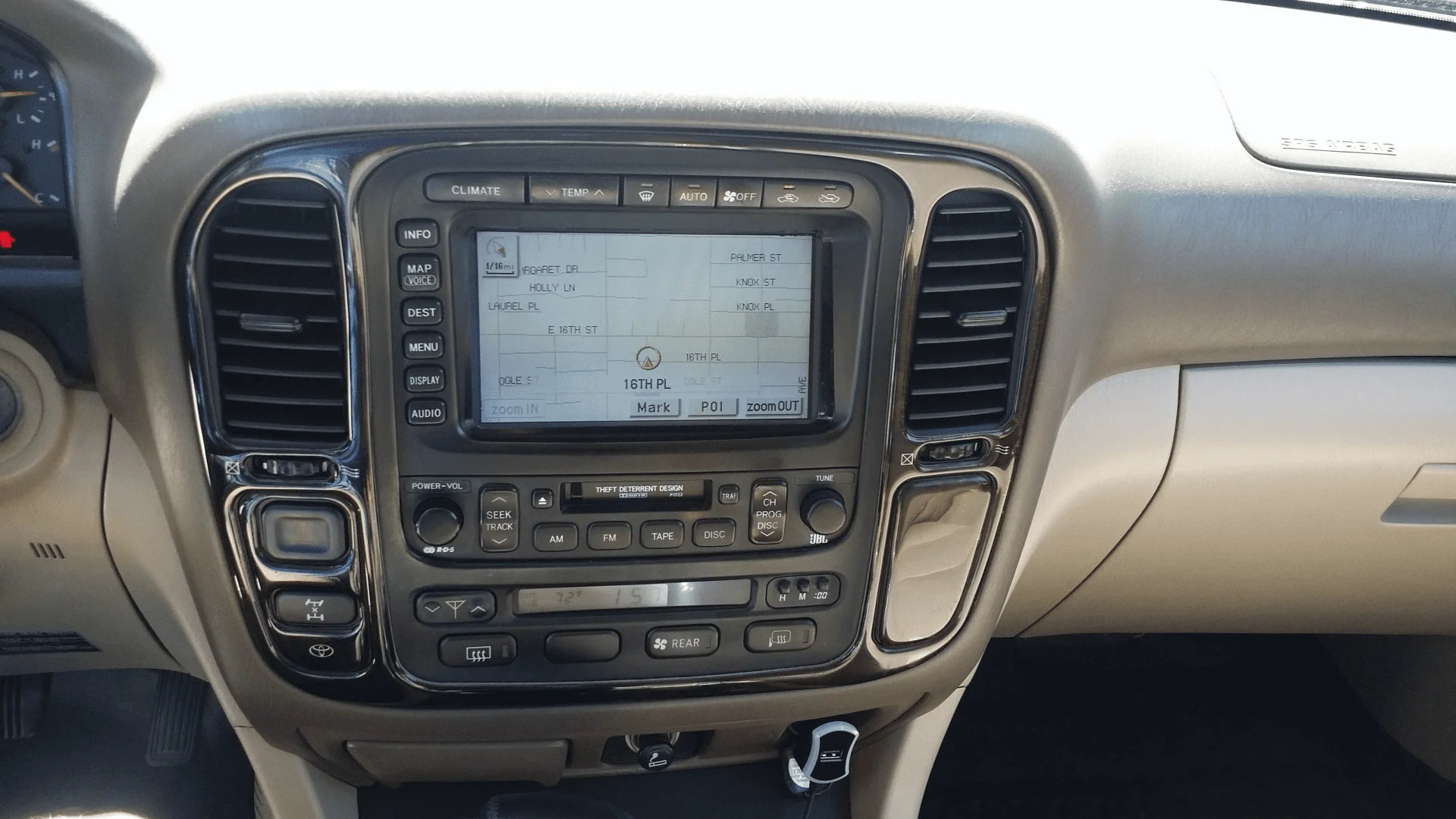

Does this look like your dash? If so, the top 2/3 of the center stack is a single unit that is the nav system, stereo head unit, and climate controls. Below that are some other buttons for defrost wires and rear ac.

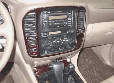

Is this your dash? If so, then you have a non-nav LC where the top of the center stack is a standard size double din head unit and the lower half is the climate controls, plus a few other pieces like defrosters and a button to turn on/off the rear ac system.

If you have the second photo without navigation congratulations, you can fairly easily customize your amp and your head unit with relative ease, similar to any double din aftermarket upgrade on any other vehicle out there.
