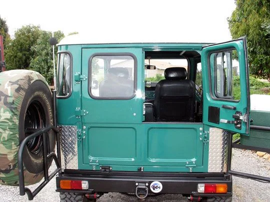

This is to cool for school...
I like this idea, and plan on doing it myself in the future... But mine will be full amby doors that are split in half...
That picture was my plan, but maybe leave the bottoms like barn doors and have a way to attach them when the hard top is on. But with my 1962 purchase I actually got a rear hardtop hatch and real barn doors. So fabricating this is no longer on my list. Will be putting my extra ambulance doors I had for this on ebay soon.
