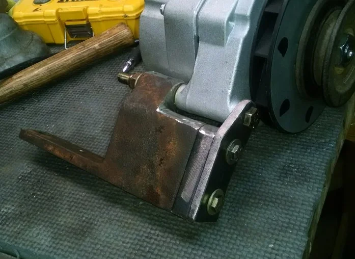

Thought I'd close this one out with a final update. I finished getting a GM 12si in this weekend. Put a 65amp unit from Napa in. I think it was like $75. Because I have a Saginaw PS conversion bracket that made use of the low driver side alternator location, it was easiest to stick with this. Also no plans for water crossings so I'm fine with this placement. I tracked down another mounting bracket off of ebay and did something pretty similar to this. Forgot to take pics before my install. Ran a new 6 gauge to the battery and pulled a keyed power trigger wire off the fuse panel. Works great. This thread was one of the helpful ones I used:

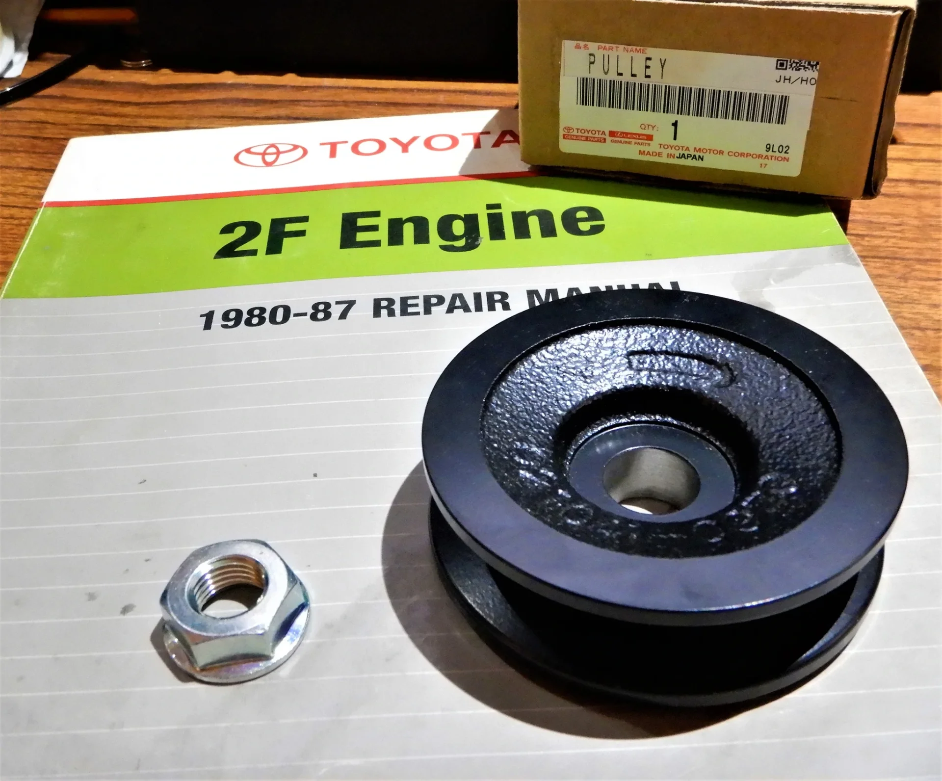

your #1 focus point i think :
you updated the non -oem unit with the OEM Cogged belt 17mm wide oem land crusier drive belt pulley
