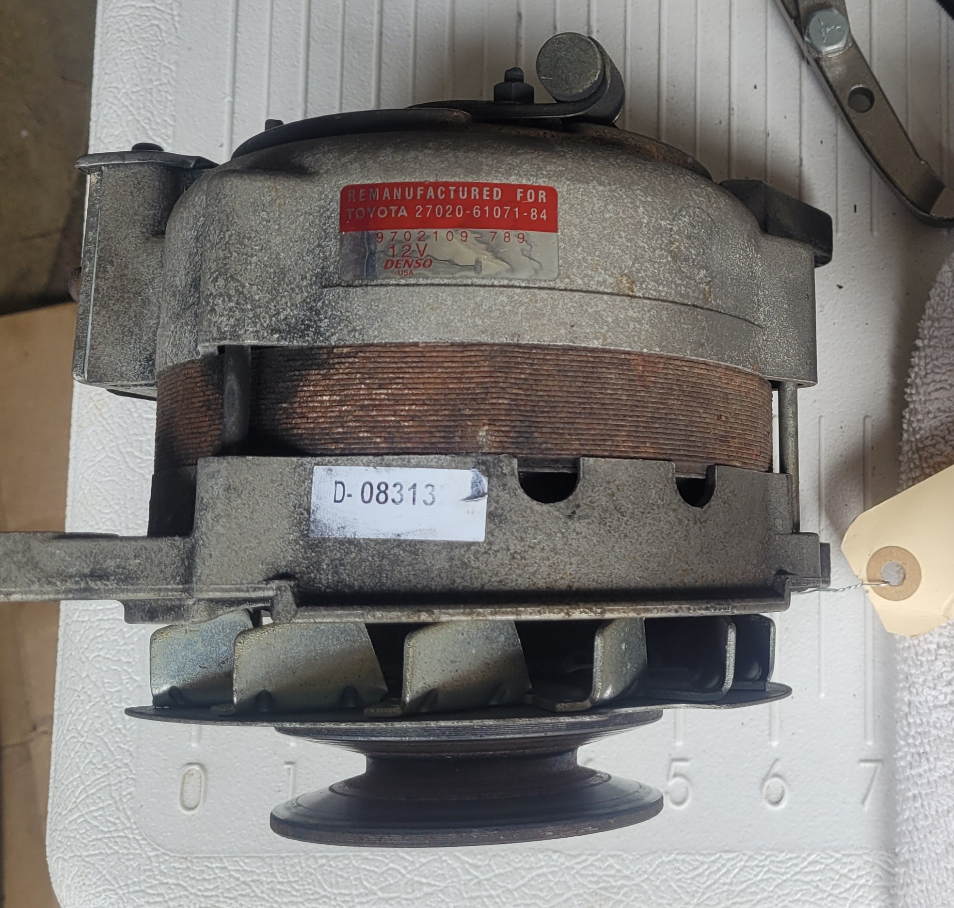

I have an 1984 FJ60, pretty much stock electronically speaking. My alternator went out and it appears to be an OEM rebuild (see attached). It spins fine and doesn't make any noise, it just quit putting out voltage.

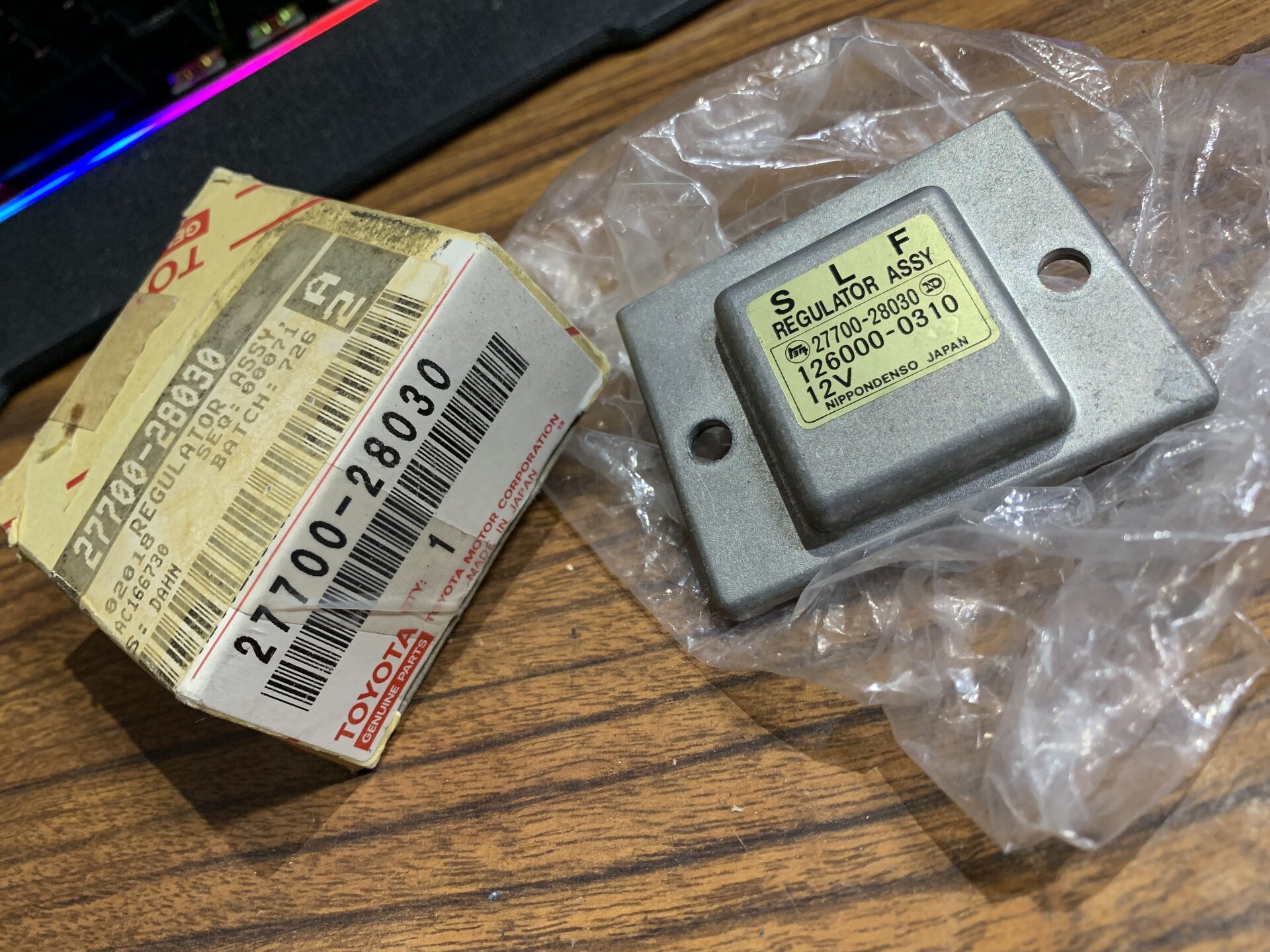

Likely this is a simple voltage regulator replacement job. Five screws and about five minutes.
Did you check the fusible link? If that is ok you just might need new brushes. My original alternator out of my 93 truck quit at 290k and it just needed brush kit.
I just checked the fusible link, It's good. I ordered a voltage regulator from ToyotaPartsDeal for $35 plus tax and shipping. If that doesn't work I'll continue to investigate finding someone to rebuild it vs purchasing a rebuilt OEM unit. After reading the threads on replacing the brushes, I'm not sure that's something I be anxious to pursue myself. Thanks again!

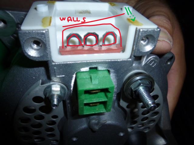

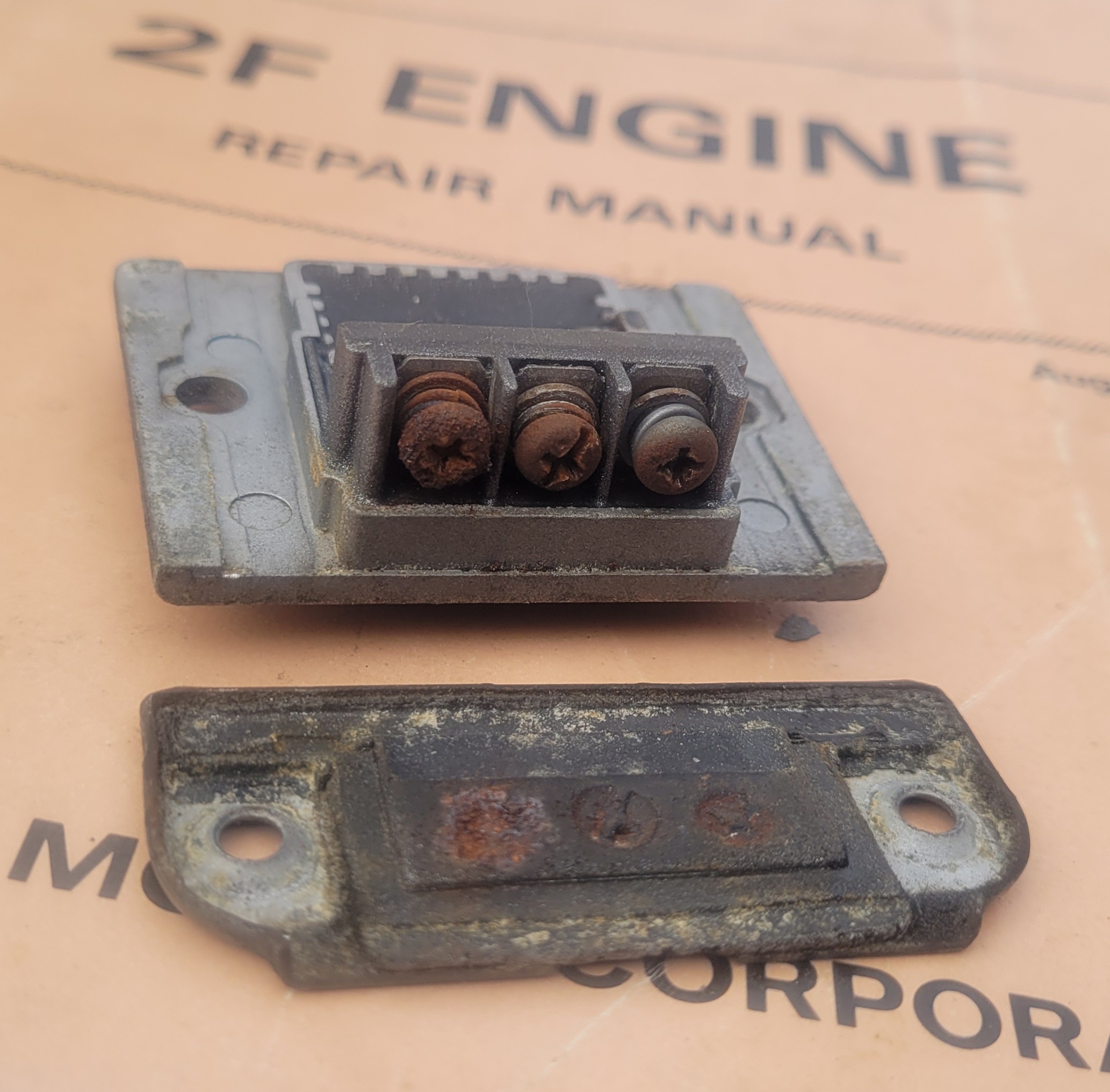

The OEM regulator will NOT come with the 3 tiny S L F p1 vessel screws
Use caution NOT to strip them out
Polish the wall and the 3 vertical Fins also there brass and a bit delicate

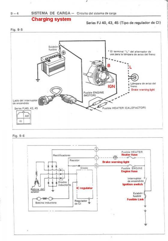

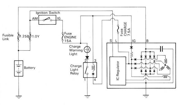

The TAN 2F FSM has very very detailed testing procedures for the 2 wire green plug set up like you have

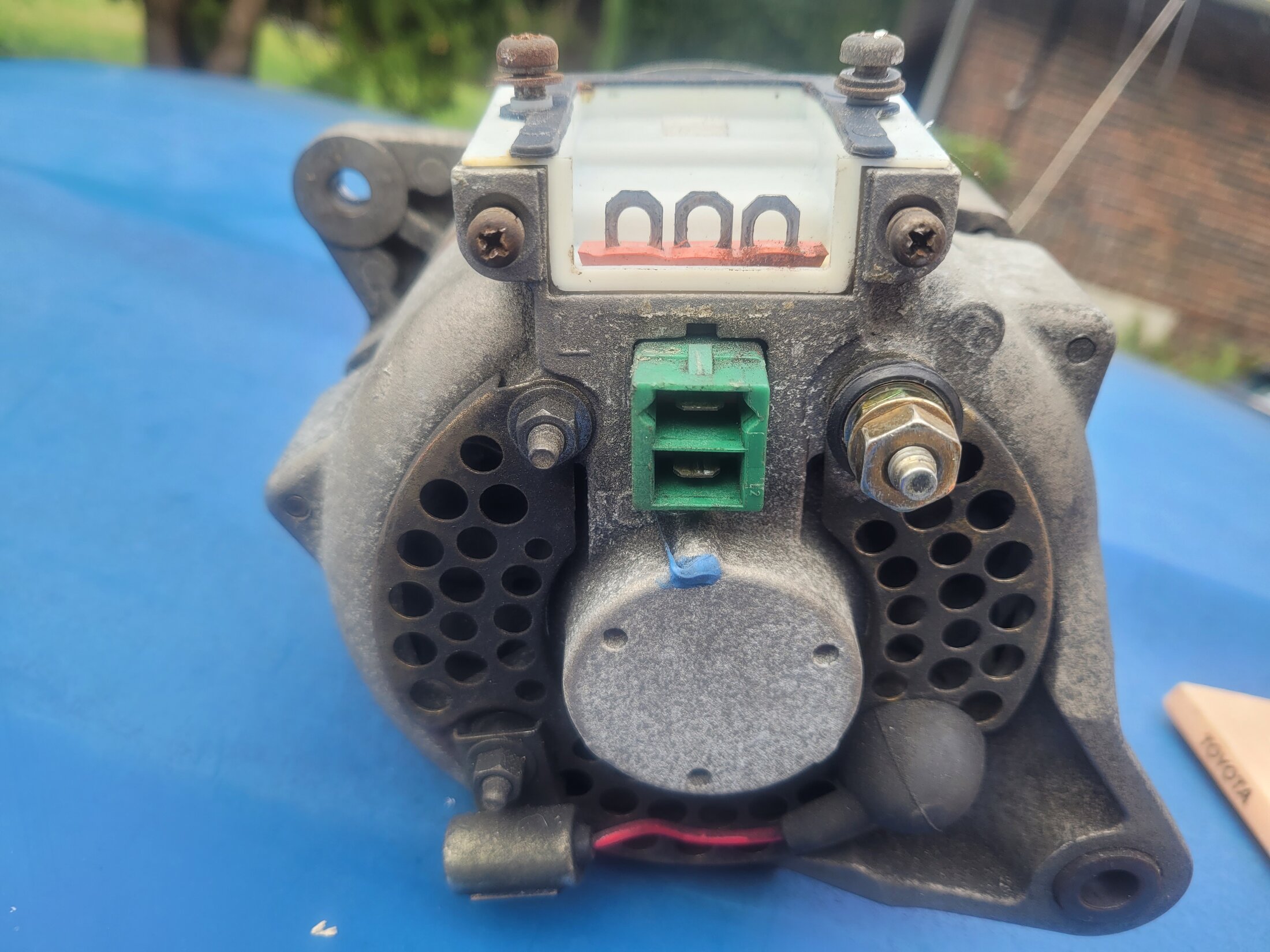

Thanks again. The three tiny screws were a little crusty but I managed to get them out without messing up the recesses too badly. What do you mean by "the wall". Is that that little plate that mounts on the back side of the alternator and covers the three screws, shown in the attached photo? That plate has got some sealant type material incorporated into it that has significantly deteriorated. Should I make any attempt to restore it with an adhesive or sealant?
I have a paper copy of the Tan 2F Engine Repair Manual. I'll check it out.
I have a paper copy of the Tan 2F Engine Repair Manual. I'll check it out.View attachment 3725613View attachment 3725614

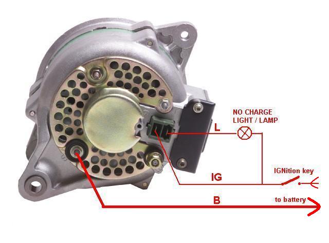

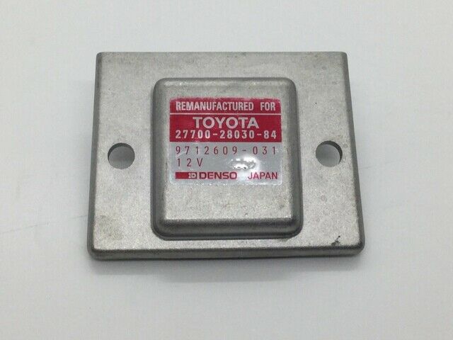

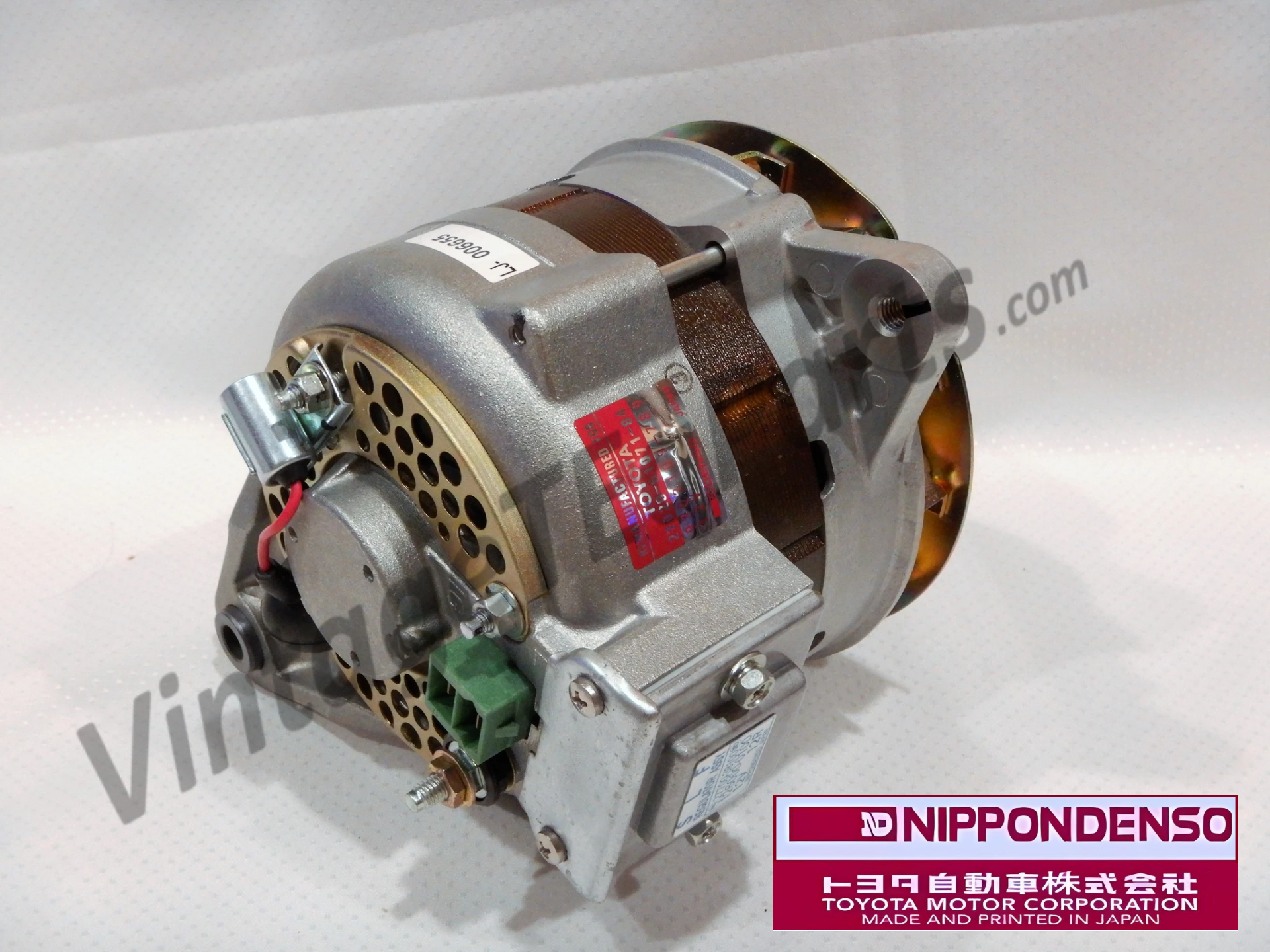

they NEVER came with a NEW OEM Toyota Regulator from the factory as a stand alone service part .........ALTERNATOR part speaking
even the original 3/36 warranty bumper to bumper was regulator-less .................
there are DIFFERENT piggy back regulators is the WHY factor here .......
the piggy back is the first gen. NON-REMOTE mounted type as in fire wall and fenders
ALL toyotas came with this cross in evolution at least 1 modle year , from EXTERNAL fans to the internal regulator internal fans ones you see today ....
1990 is the last EXTERNAL fan toyota alternator modle year globally ...............various models including LAND CRUISER included .....

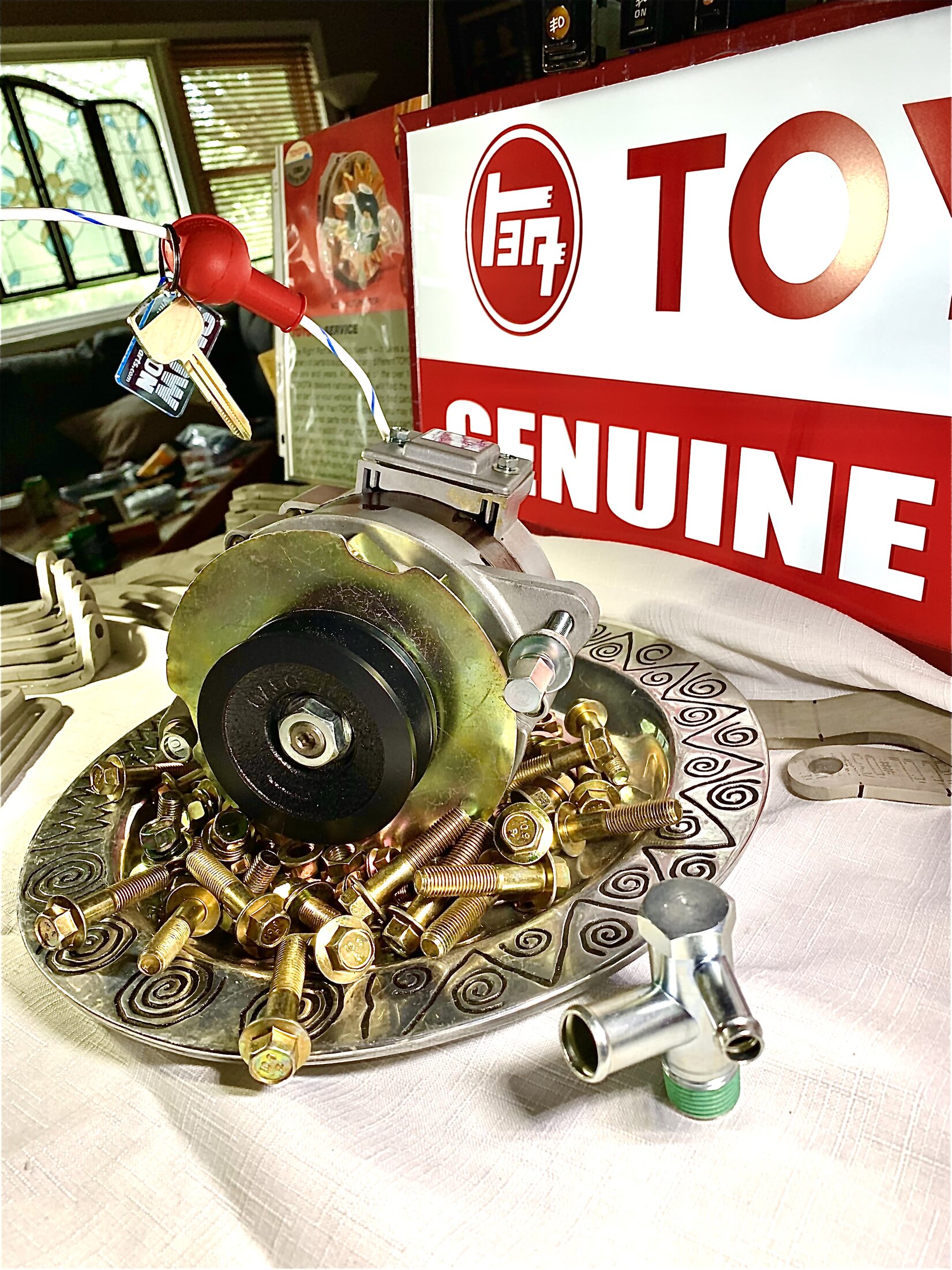

note : i always have included 3 new OEM Genuine NipponDENSO Japan regulator micro screws with any piggy backs i ever have offered and the new updated P2 VESSLE JIS hex combo screws for bolting it on , my choice my way .....:)
NOS OEM Piggy back 27700- 's examples below :
Can anyone recommend a shop to take it to local to the greater Seattle area, preferable south end? I know there are vendors referenced on this website that may be willing to do it, I would just prefer take this one somewhere and get it fixed without shipping and all that hassle.
Thanks!View attachment 3723155
