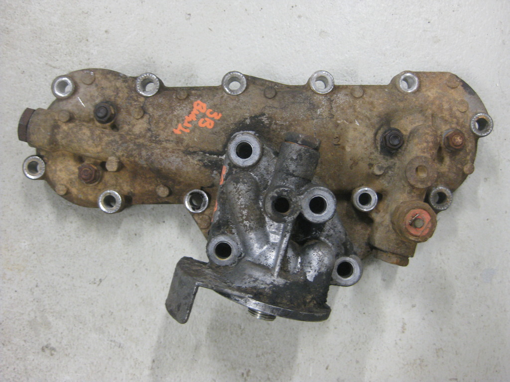

Can i use one of the 1/8 BSP ports as an alternative oil feed for my alternator vacuum pump?
I have purchased a downward facing oil filter housing but it does not have the oil feed and retun as my 3B currently has.
then a bung on the side of the sump for the return?
You have photo? I have my vacuum pump oil feed coming from my downward facing housing. It's on a B though and don't know if it's the same as yours.
this is a pic, i have another thread to ID the housing and i think it is from a dyna or coaster which i think had a vaccum pump elsewhere hence no oil lines on this one for the alternator.
